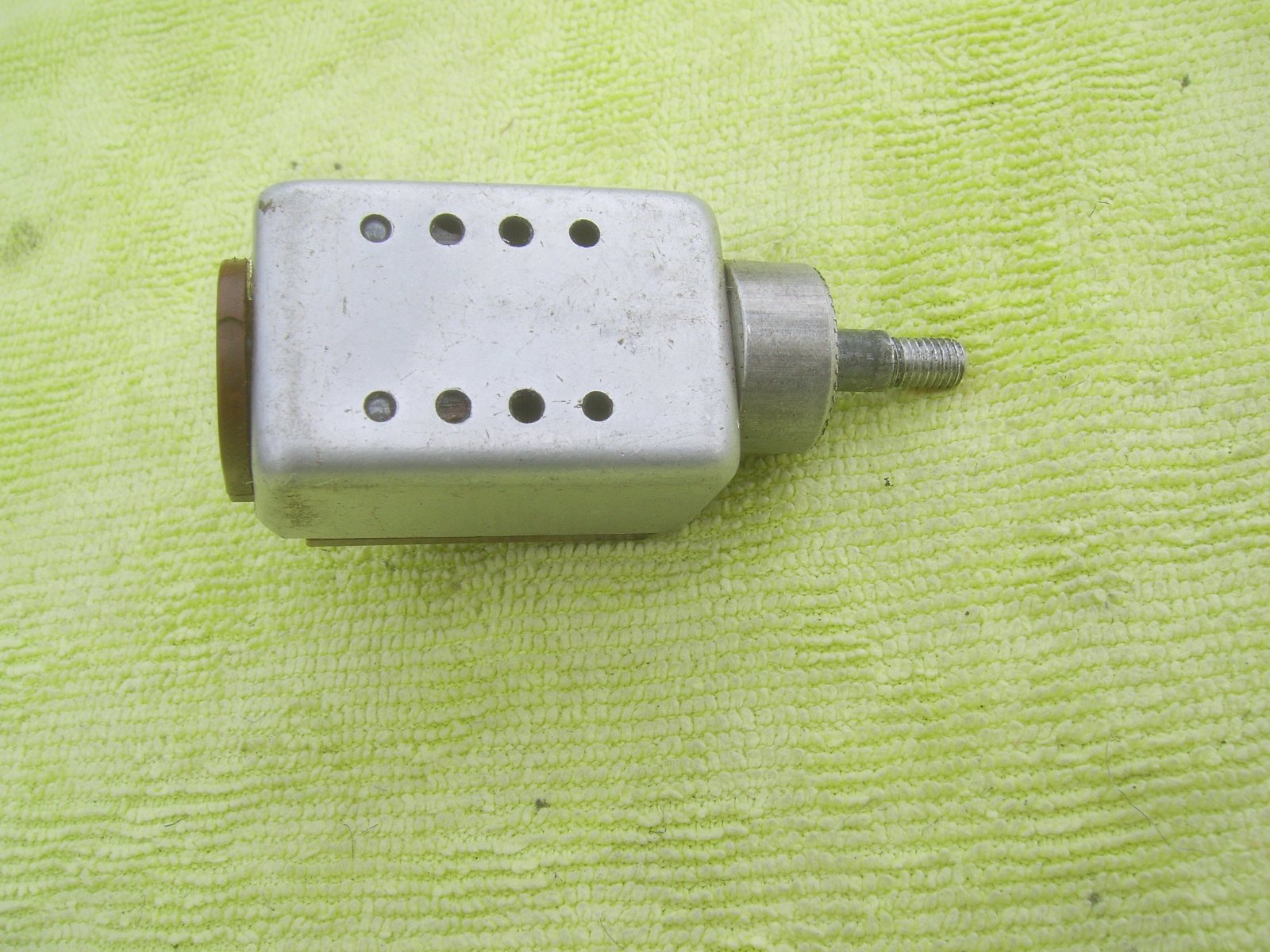

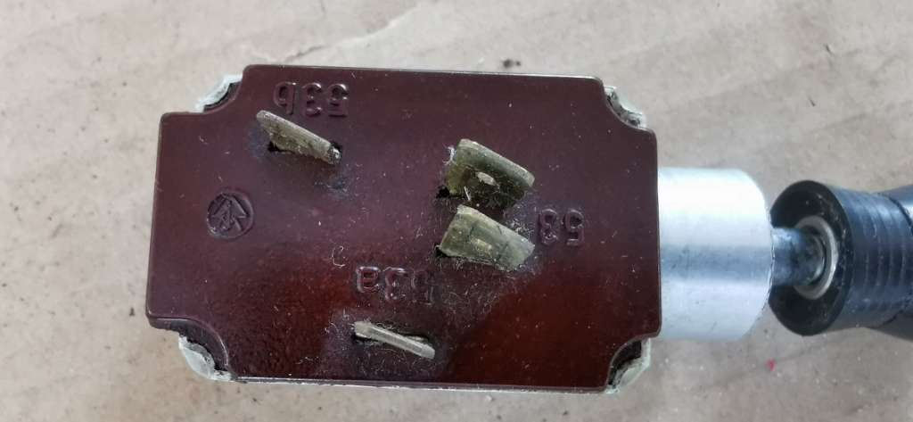

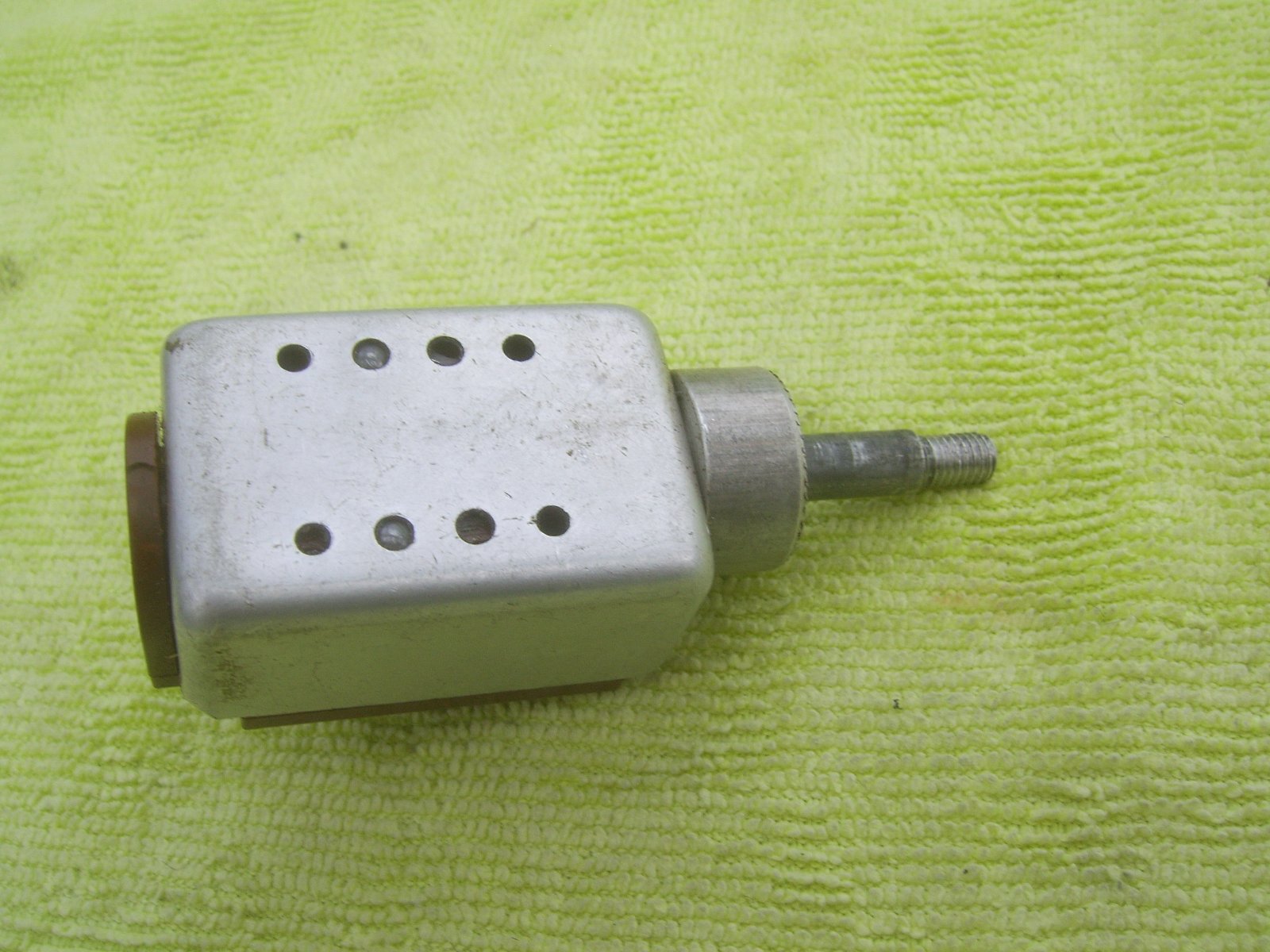

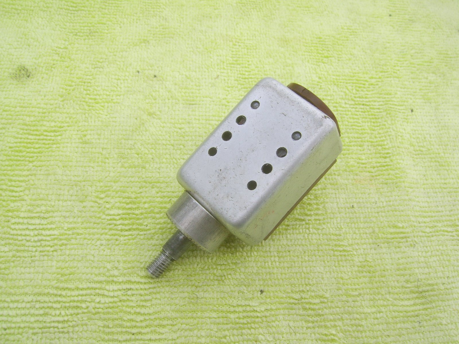

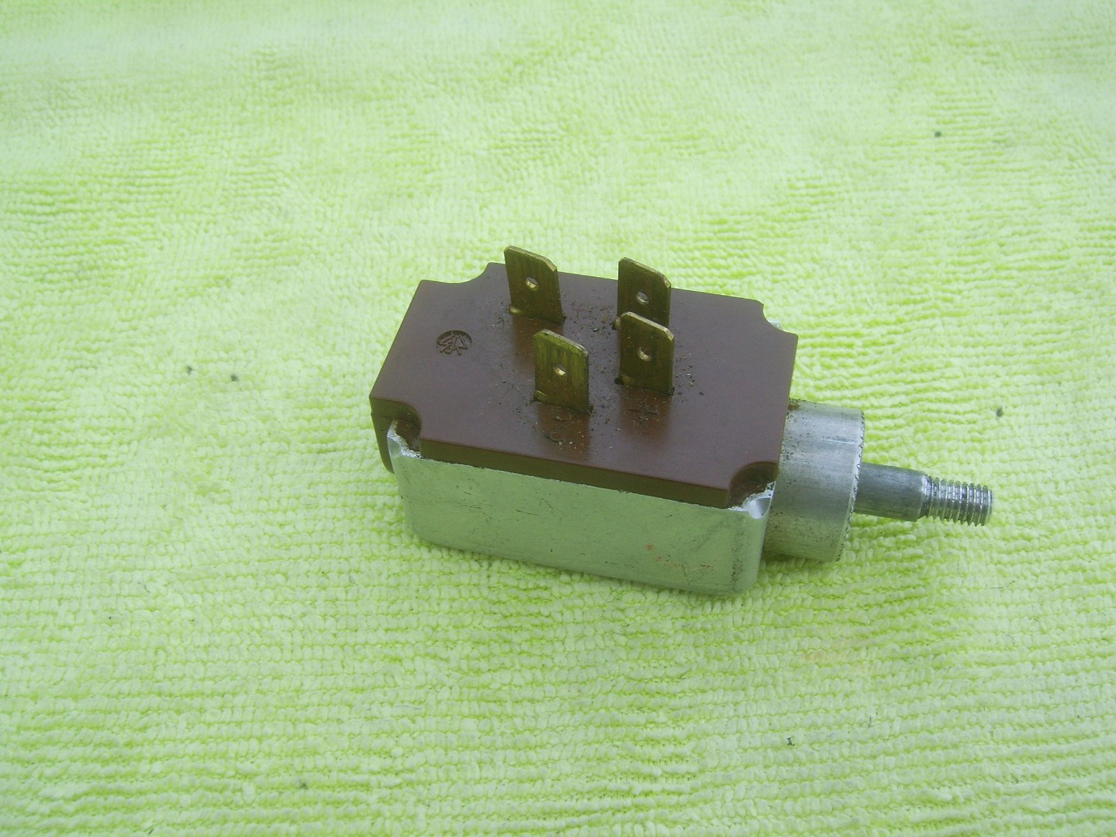

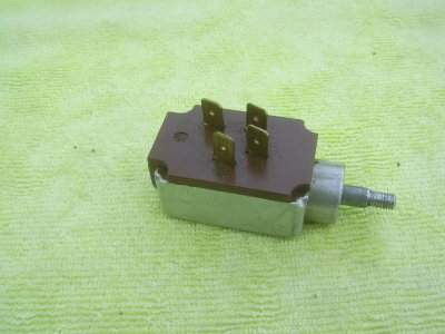

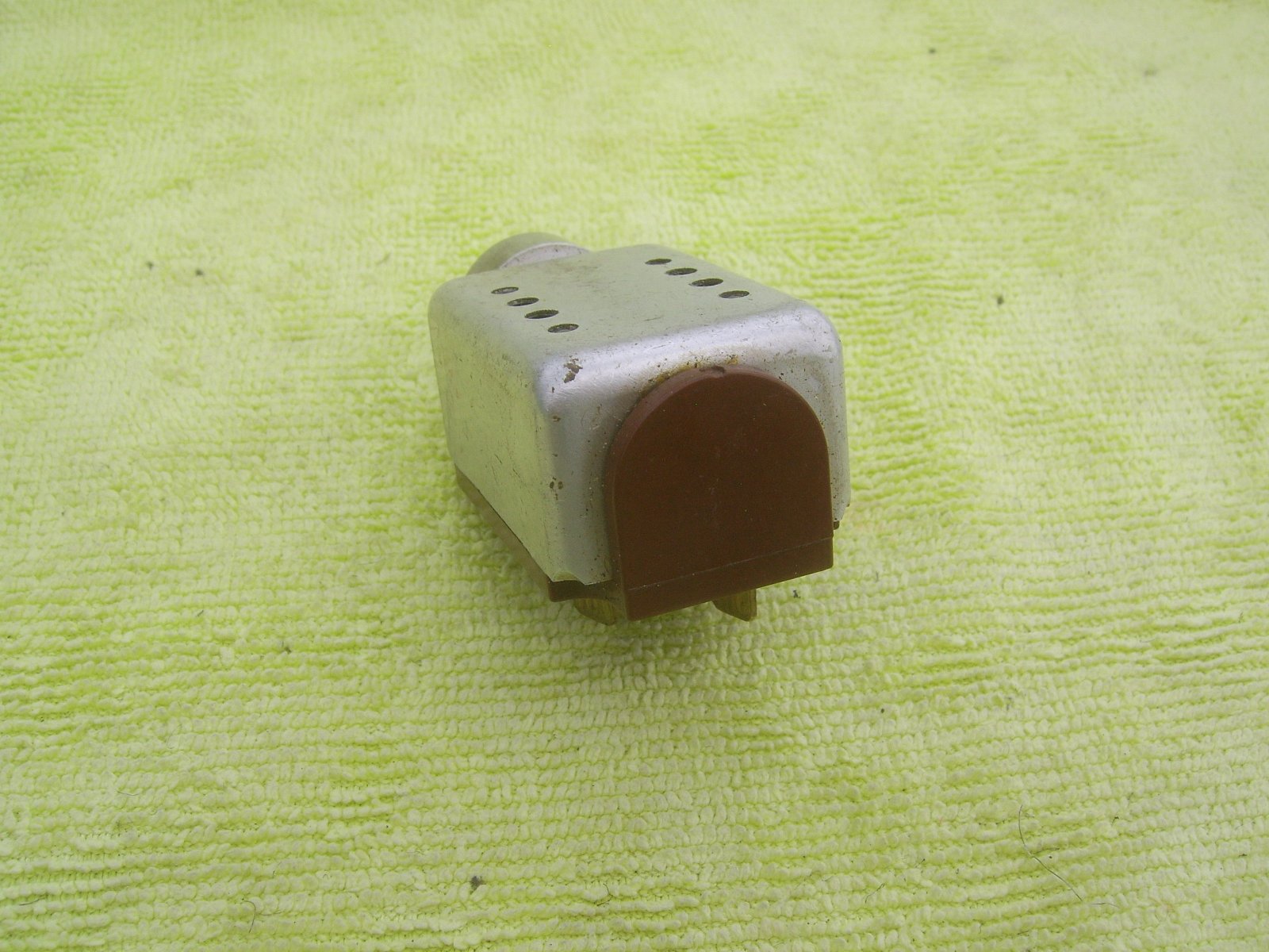

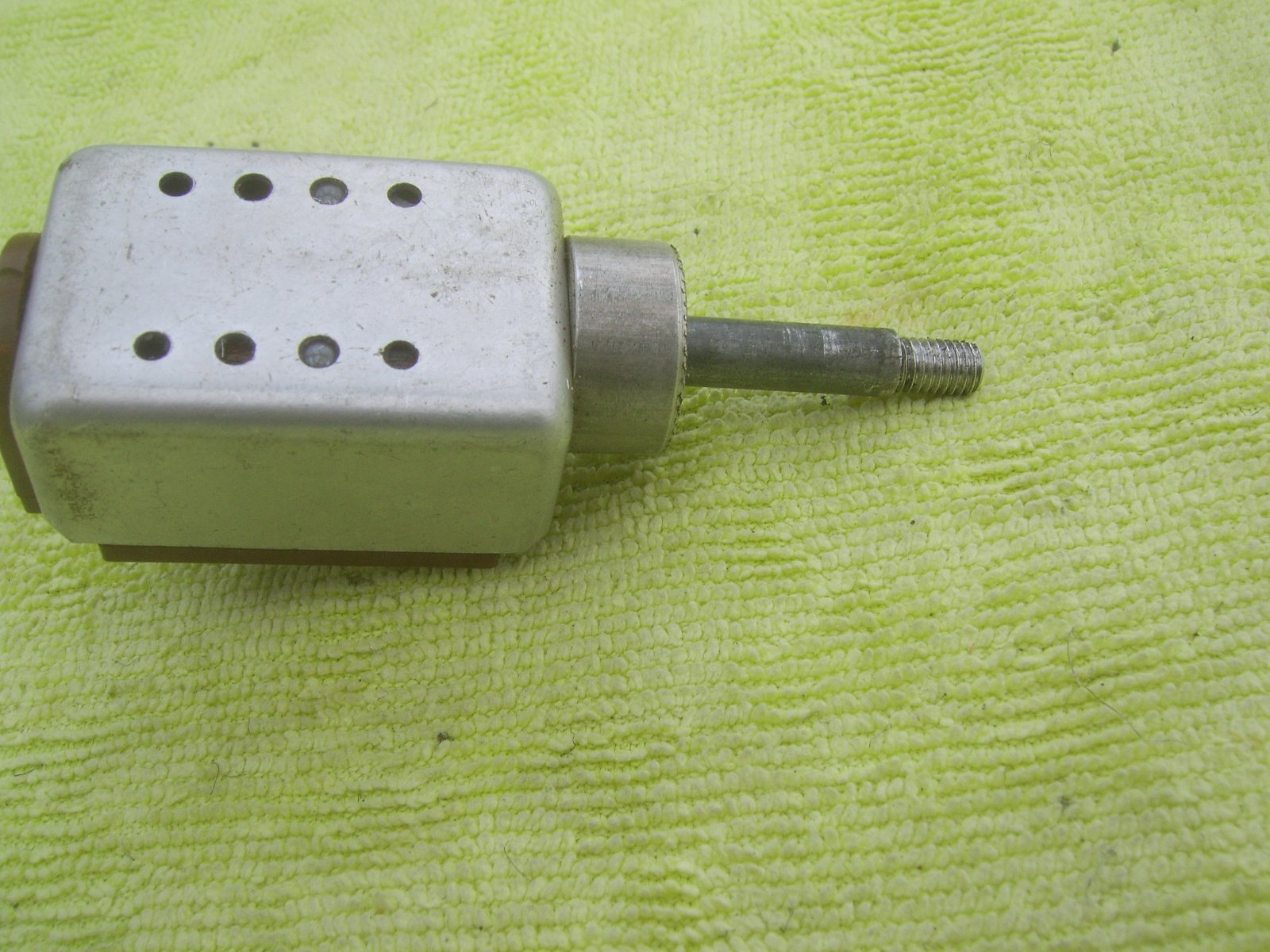

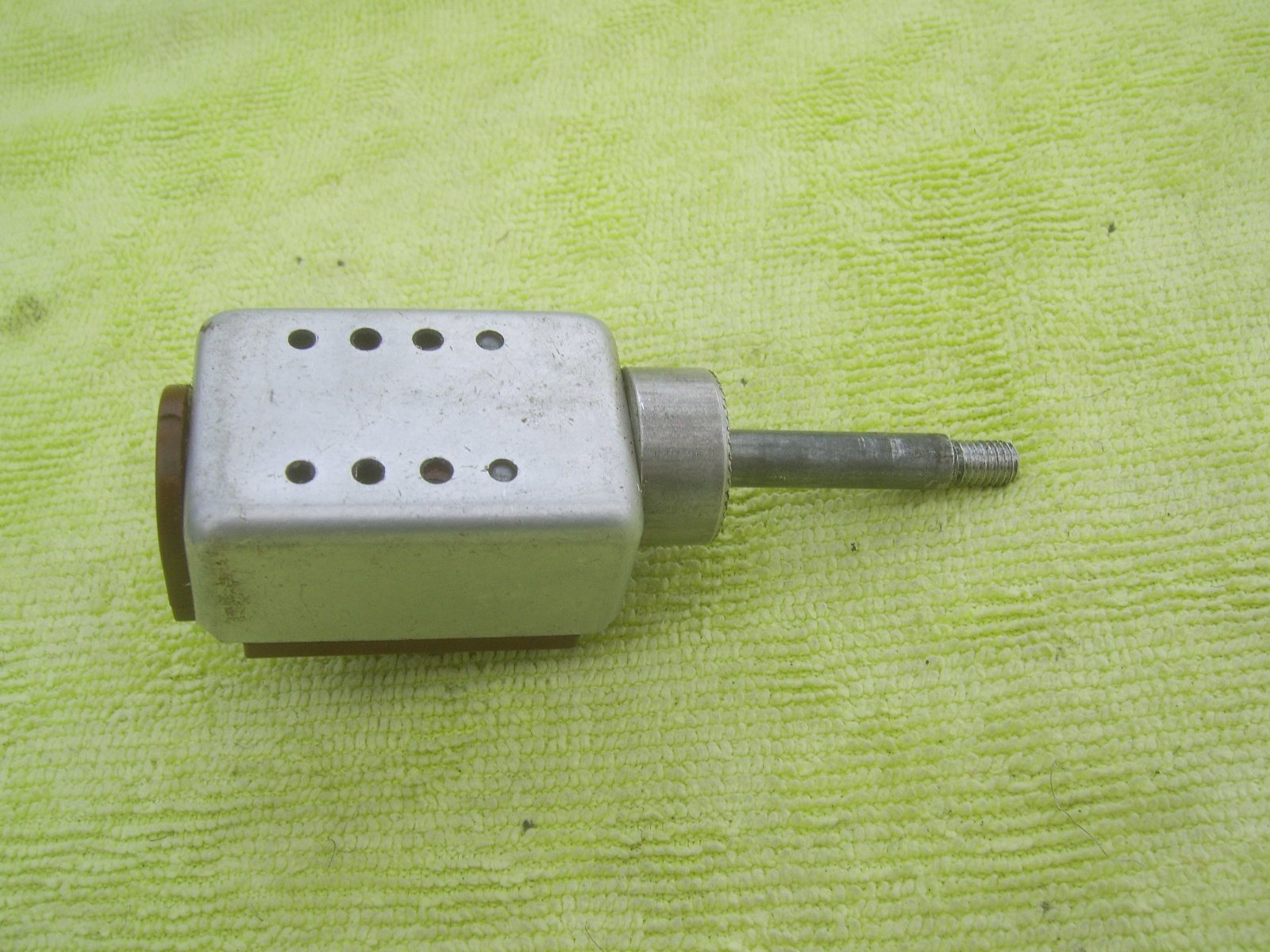

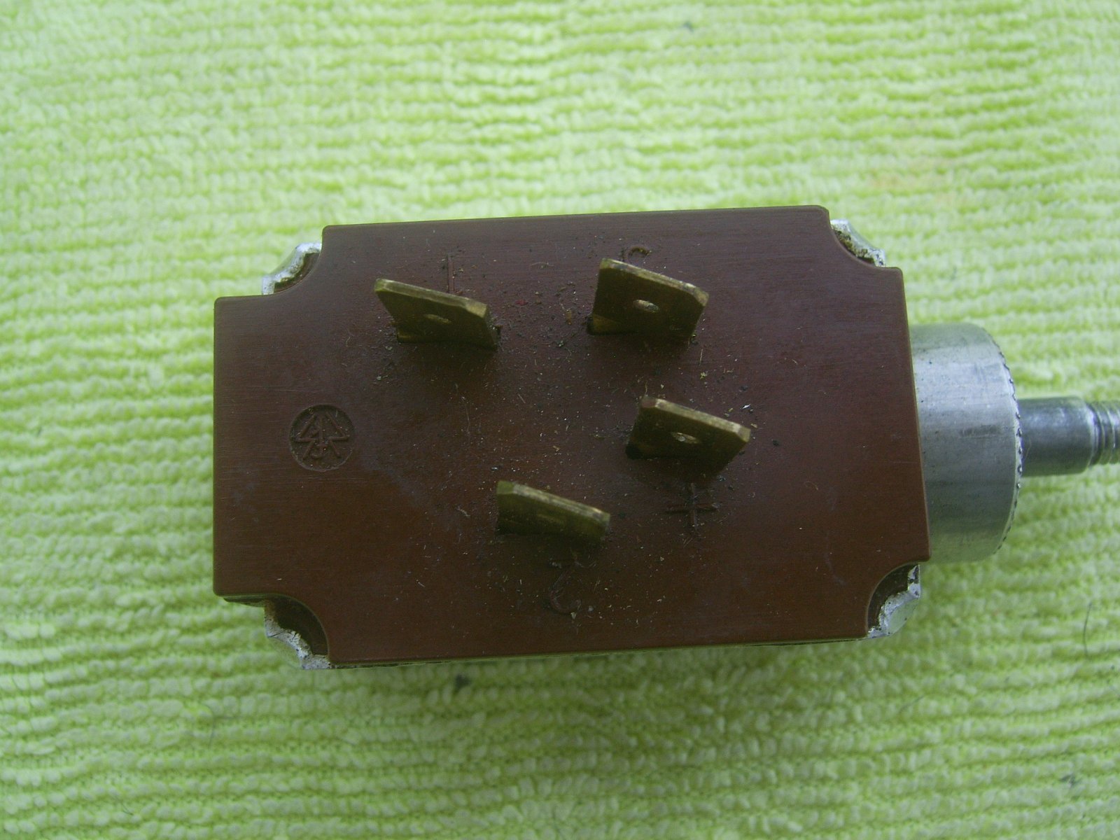

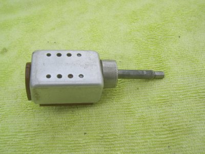

Does anyone knows what switch this is? It can be pulled out three times.

Looks like an early headlight switch to me. I have no idea what year/make/model, but most (at least US) cars in the 50's-70's cars used a headlight switch like this. All in off. First detent parking lights. 2nd detent headlights. The knob would generally rotate which turned a variable resistor to dim the dash lights.

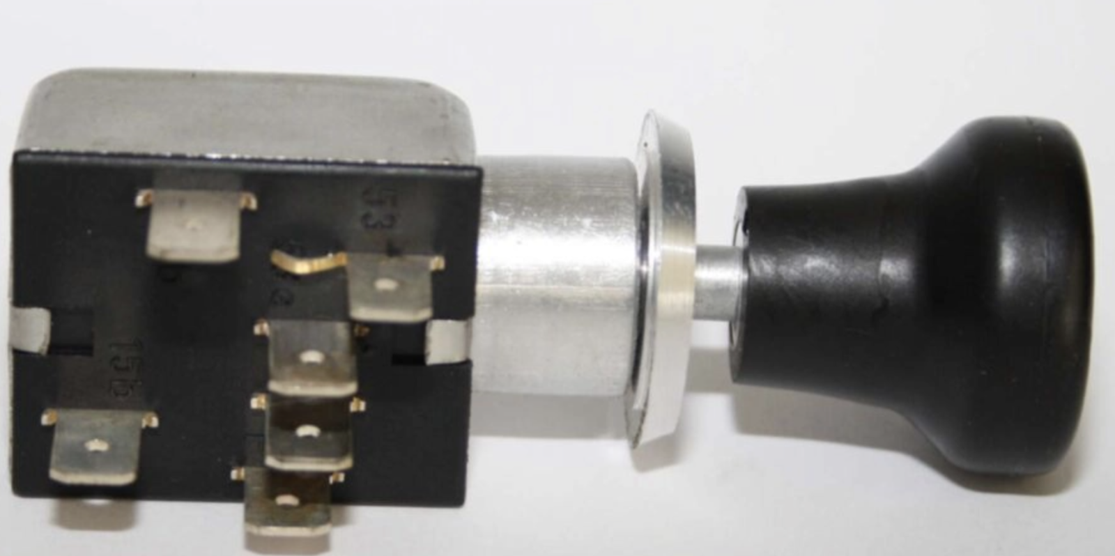

it looks like the E9 wiper speed switch (for early models), but that one has different pins:
I did a quick search, closest match I found is an E10 wiper switch:

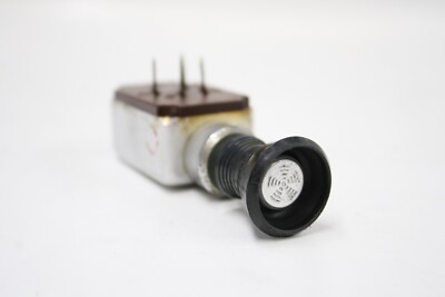

Could it be a BMW 1600 1602 2002 (1966-1971) Fan Blower Switch?
found it:
61318448107
E10 blower switch
