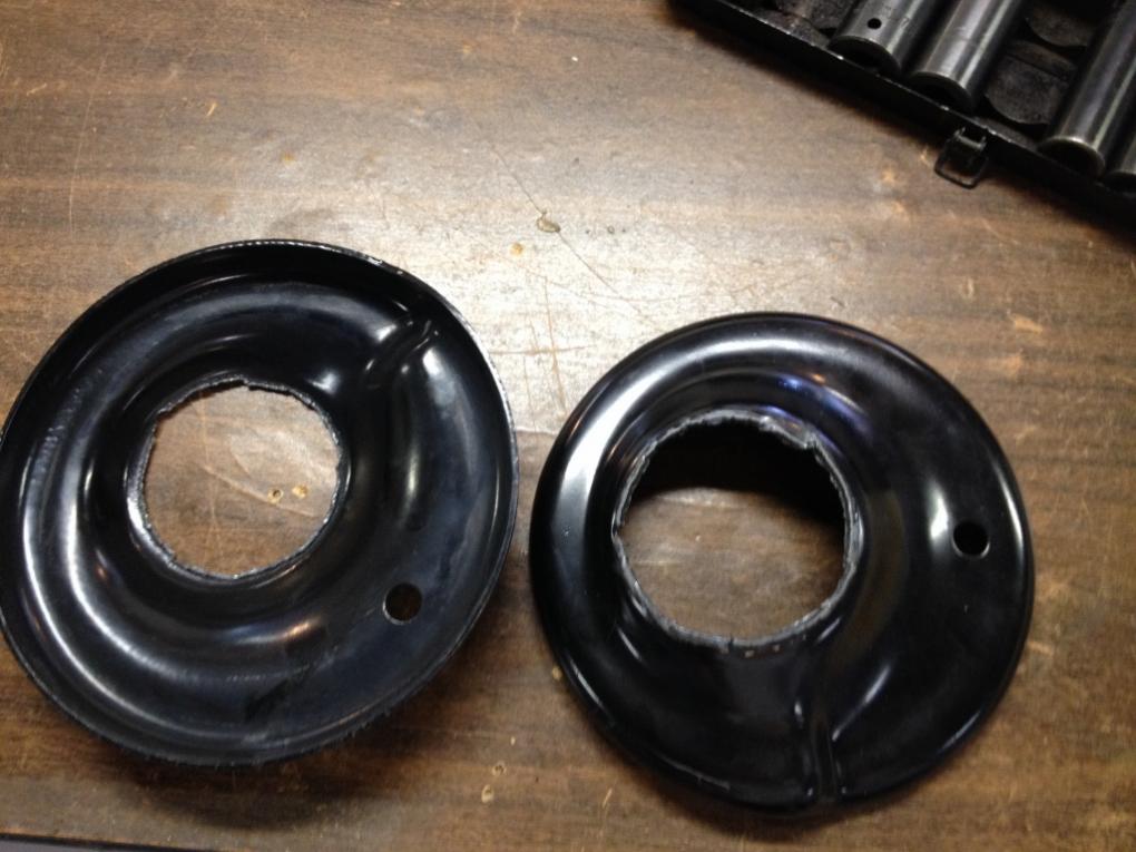

The adjustable camber plates are IE. I purchased the threaded sleeve and spring perch from separate sources. Springs are 7" Eibach 400lbs and actually the ride is great. Not too harsh and the drop is probably a bit over 2" (but not much more). I believe that the adjustable camber plates actually increase the available drop because the upper spring perch ends up closer to the upper mount points. With the 7" spring, my spring perch is bottomed out for maximum drop. The base of the collar and sleeve rest upon the original spring perch that was remaining after I cut off the excess (see pic). Forum member Peterinfla (I still owe him $75) was very helpful in discussions for the setup. I used the adjustable camber plates to make sure that with the vehicle lowered, I would be able to maintain some negative camber in the setup. That said, I think you could probably get by with fixed camber plates (since I think they are good for -3 degrees) if you were only dropping 2" (IE sells an adapter plate for the upper perch for reduced coilover spring diameter.

I gave Ground Control all the dimensions of my strut, including the diameter of the body, diameter of the shaft and the length above the spring perch. They sent me 6", 350 lb springs and camber plates that worked with my existing inserts. I had cut the rears, I think a coil and a half so he estimated the 350 to match that. I used the stock spring perches as is.
