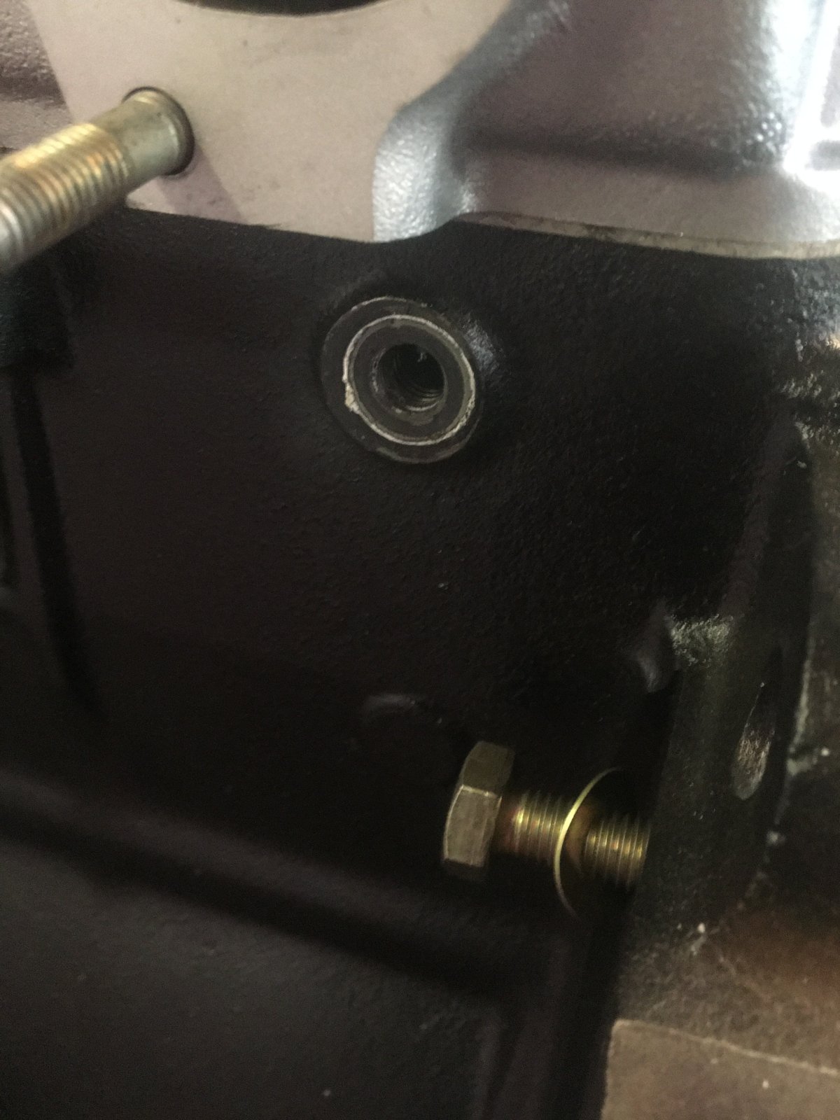

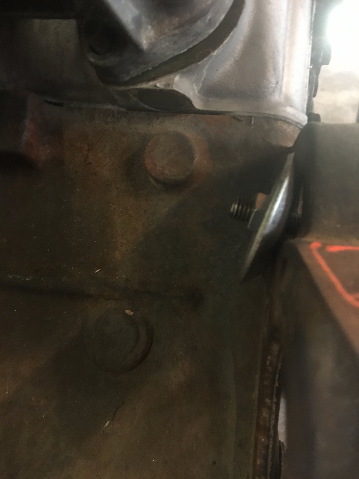

I have a 3.5L engine in my E3 and I have the water heated choke assemblies on Zeniths. The 3.5L block doesn't have a return port for the water line so I need to add it somewhere. What have others done? Do you just tap into another hose with a "T" fitting?
Very clear where it goes
Is there an alternative? I get drilling and tapping is the best thing to do (although I don't like the idea of metal shavings in the block), but I was hoping not to take the carbs/manifolds off again. I know it's faster the FIFTH time! But you know what I mean...
