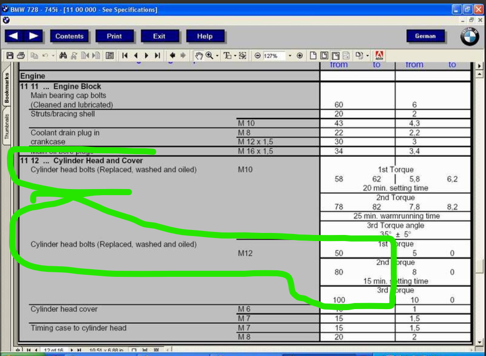

question: to retorque or not retorque the head bolts
I use the BMW torque specs for 12 mm hex bolts
[non-stretch] from the factory cd spec section
