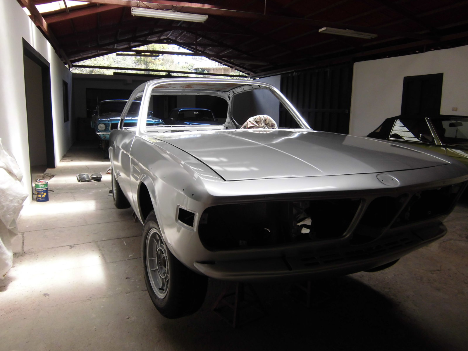

Hi All,
I am new to this forum, my father owns a BMW 3.0 CS 1974. It has been in the mechanics for almost 20 years (partly because my dad suffered a stroke and partly because I was living abroad).
So I am trying to help him repair it. It is difficult for me to find the parts mainly because it is a bit difficult to translate from Spanish to English what the mechanic tells me it needs. So far I have made this list of parts to the best of my abilities. I tried the website classic.com but they no longer provide the service.
I need websites where I can ask for quotes for these parts ideally new parts. Could anybody guide me a bit?
The car details are as follows
We are looking to restore our family BMW 3.0 C.S E9
Serial Number: 2210437
Series 3.0 CS
Bodywork: Coupe
Model 3.0 CS
Version: ECE
Direction: Left
year: 1974
Manual transmission
Production month: All
