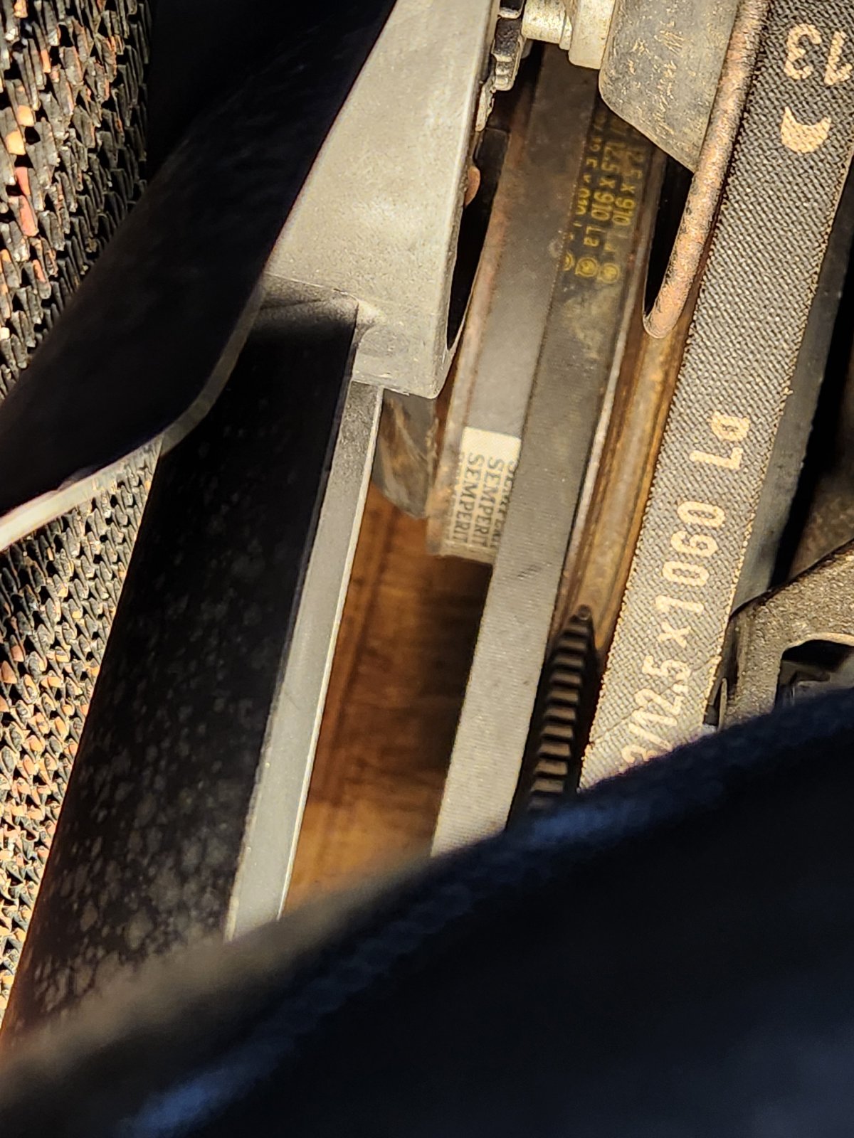

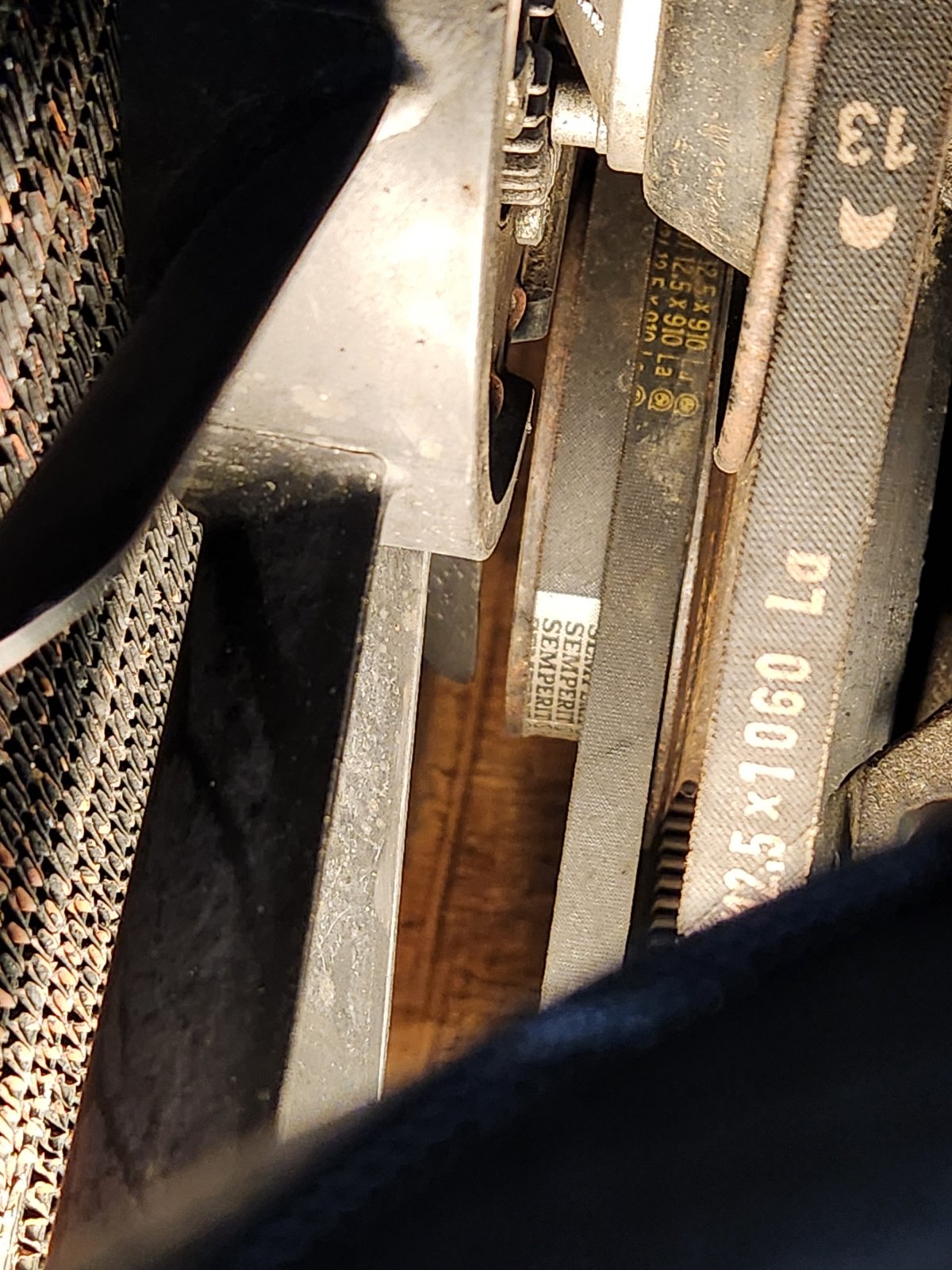

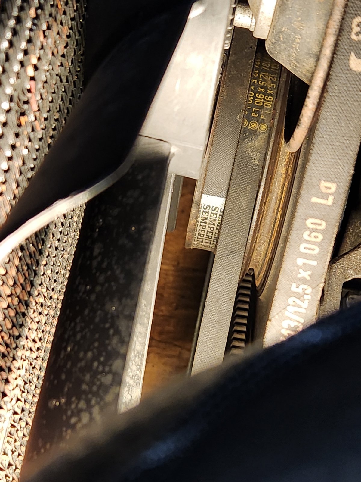

1st pic shows the single blade in contact with ac/ps pulley (look down below by the Semperit belt). 2nd and 3rd pick show adjacent blades not hitting. So WP bearing would be okay? 4th pic shows opposite side blade not hitting.
Seems single fan blade got torqued but not sure how or why.
