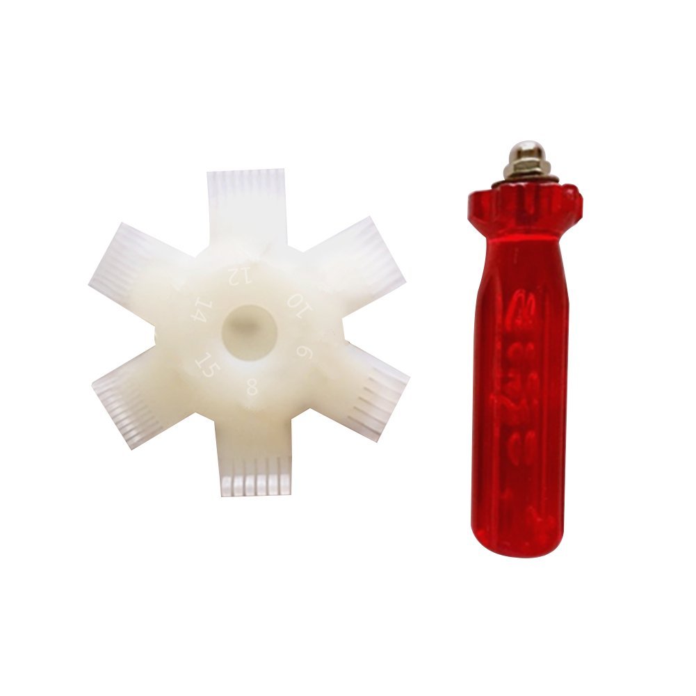

There are "combs" designed specifically for realigning cooling fins - and maybe detangling a wirehaired terrier.
