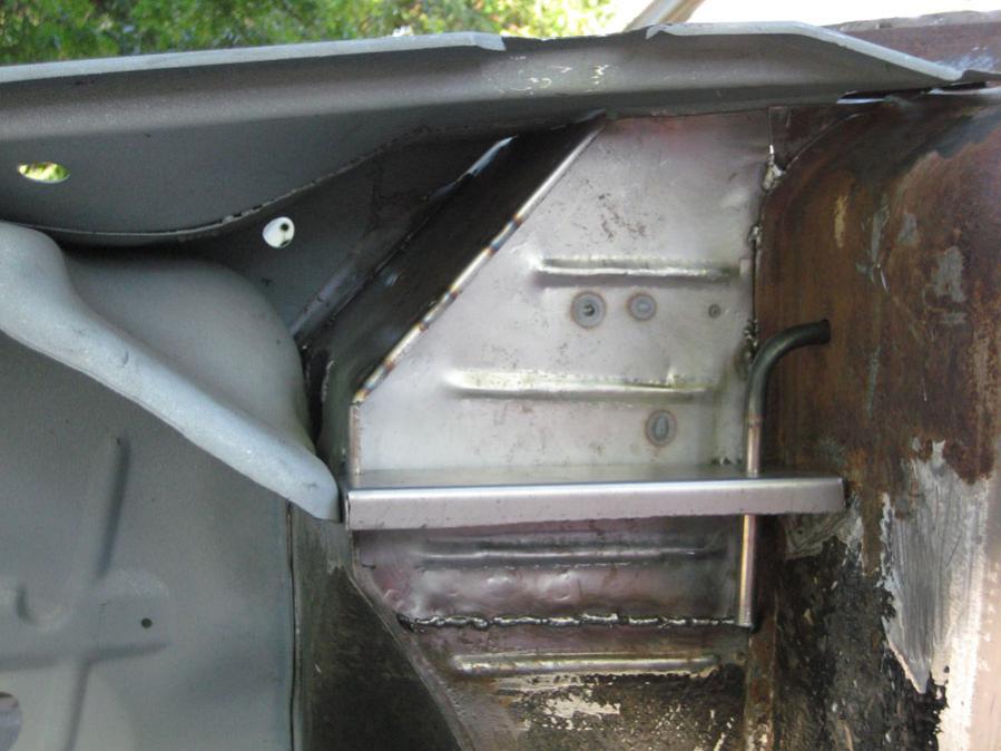

The inner front left fender has a factory notch (see photo). This notch was on both the original car (USA model) and on the replacement inner panel I installed. You should be able to reach up inside the wheel well to find it. Not sure if that helps.

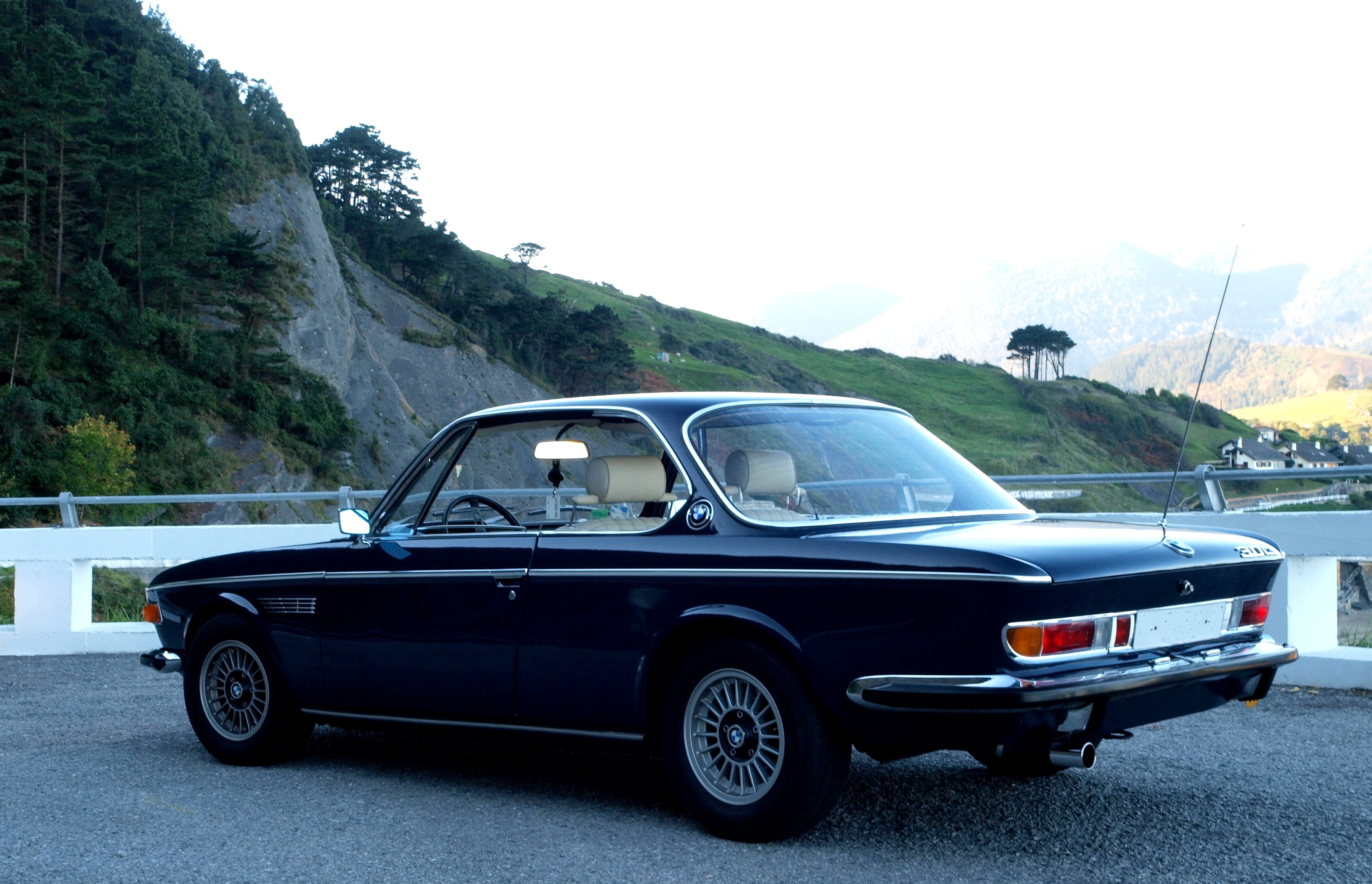

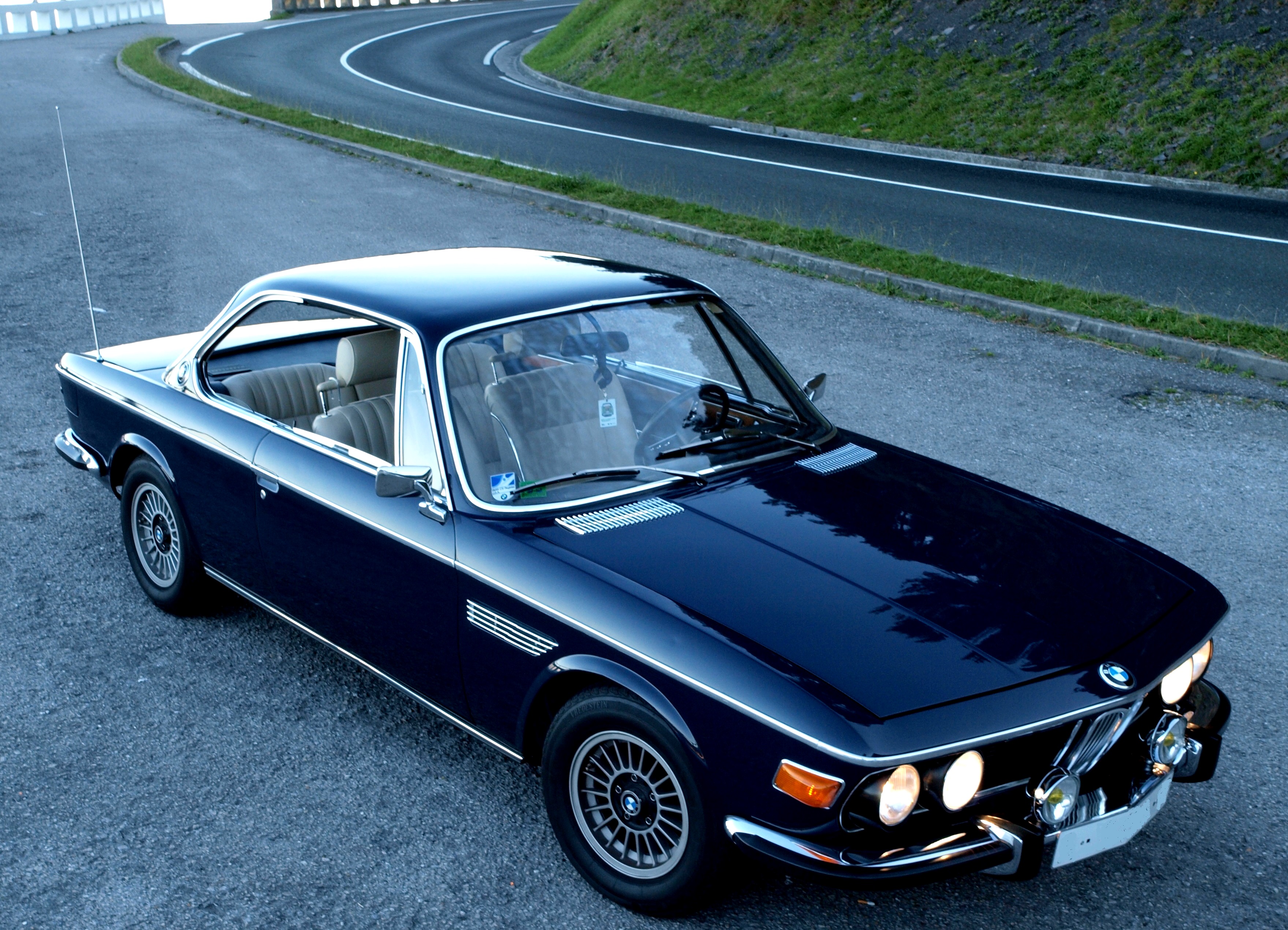

Italian cars (always?) had them on the rear left side of the trunk lid. About half way and usually electric. (just to clarify: the hole was drilled on the fender and not in the trunklid).
Early cars usually had the antenna mounted on the A-post, adjacent to the windscreen edge.
actually not always....not very qualified dealers retrofitted antenna at the left rear edge of the fender simply because is more simple.:wink:

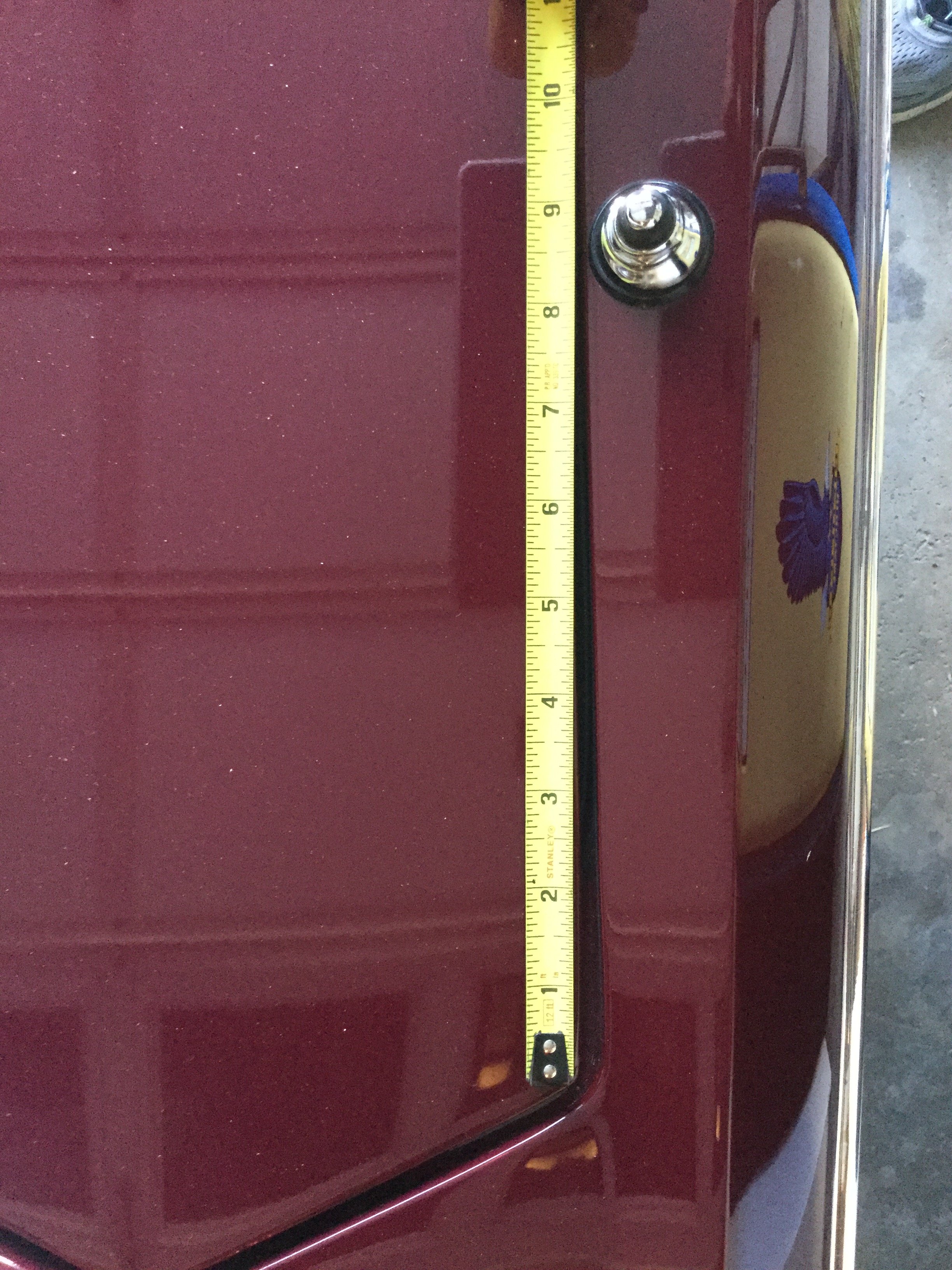

There is no exact location, sorry. Here is mine which works, I installed it 8 1/2” behind edge of trunk lid, anymore forward and antenna will be straight up.

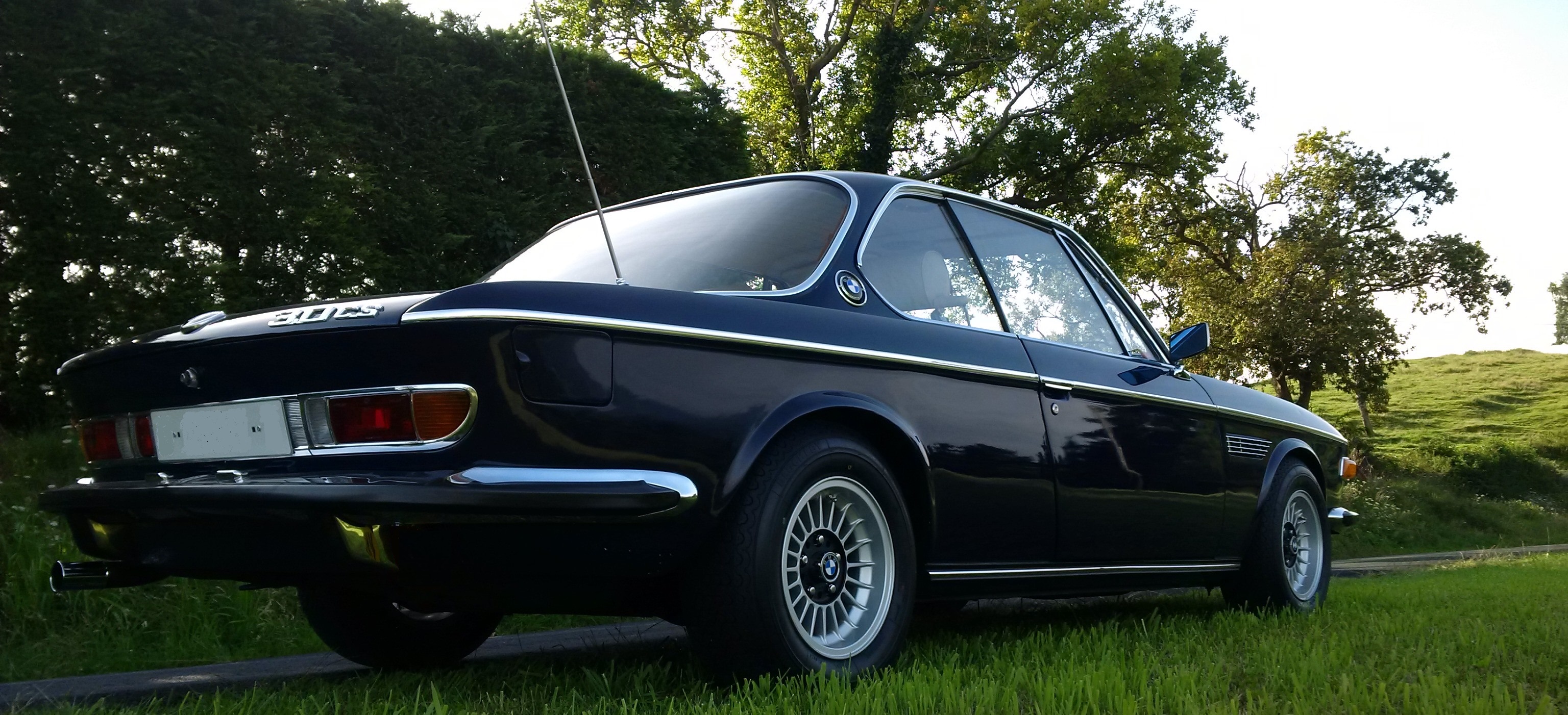

Anyone have the EXACT location on the left rear? I actually prefer that location.
The antenna on my Italian Euro Coupe is on the left rear fender. It came to me with a non-working electric motor. I can measure its location. Don't know how to load photos to this site.
Stev

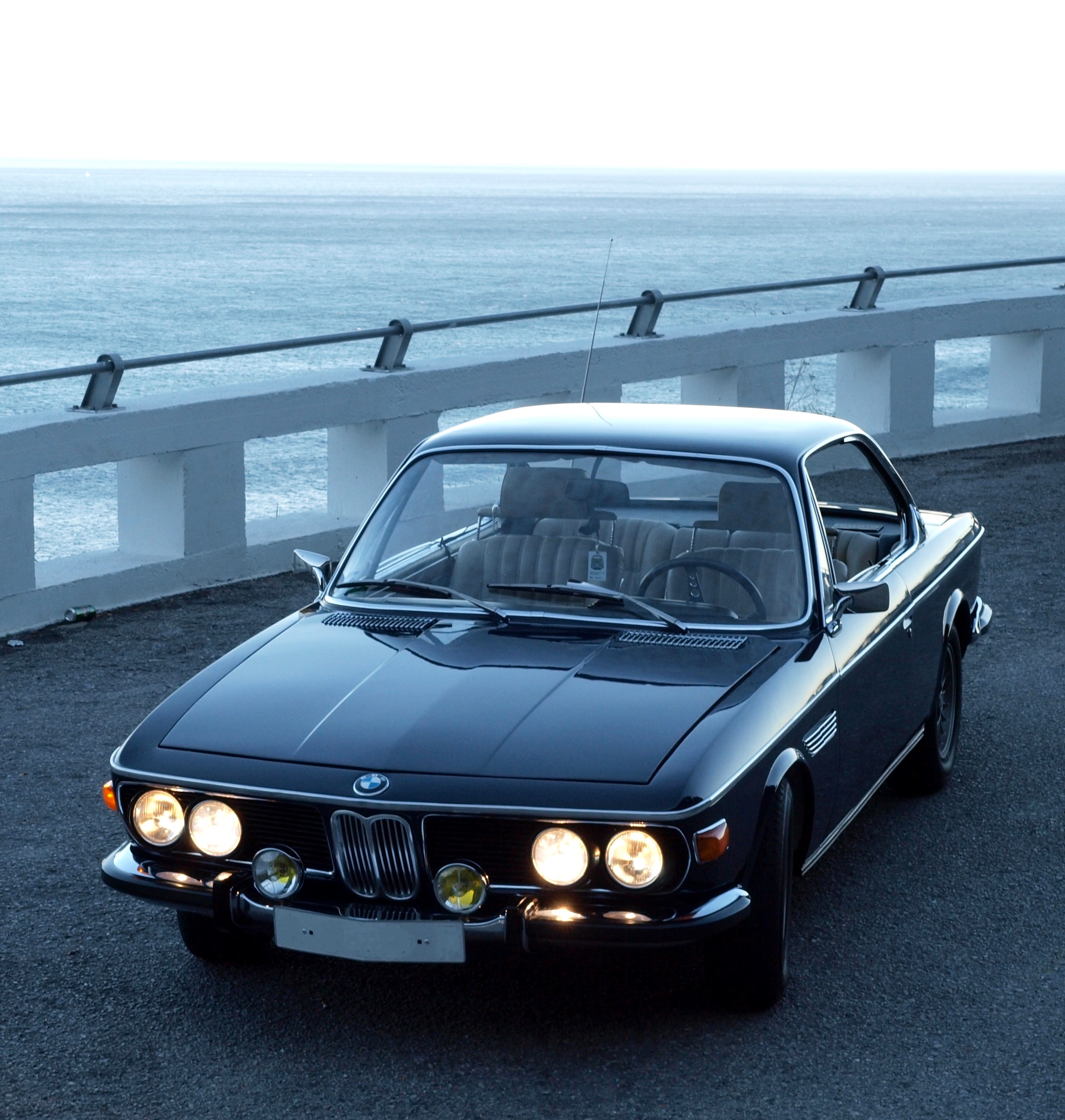

actually i found mine placed in the rear right fender,
deQ, the first one I have seen on the right fender. Seems to confirm that they were not factory installed, depended on the mood and aesthetic sensibility of the dealer mechanic. So we all have "correct" positions. Well, that solves that.
