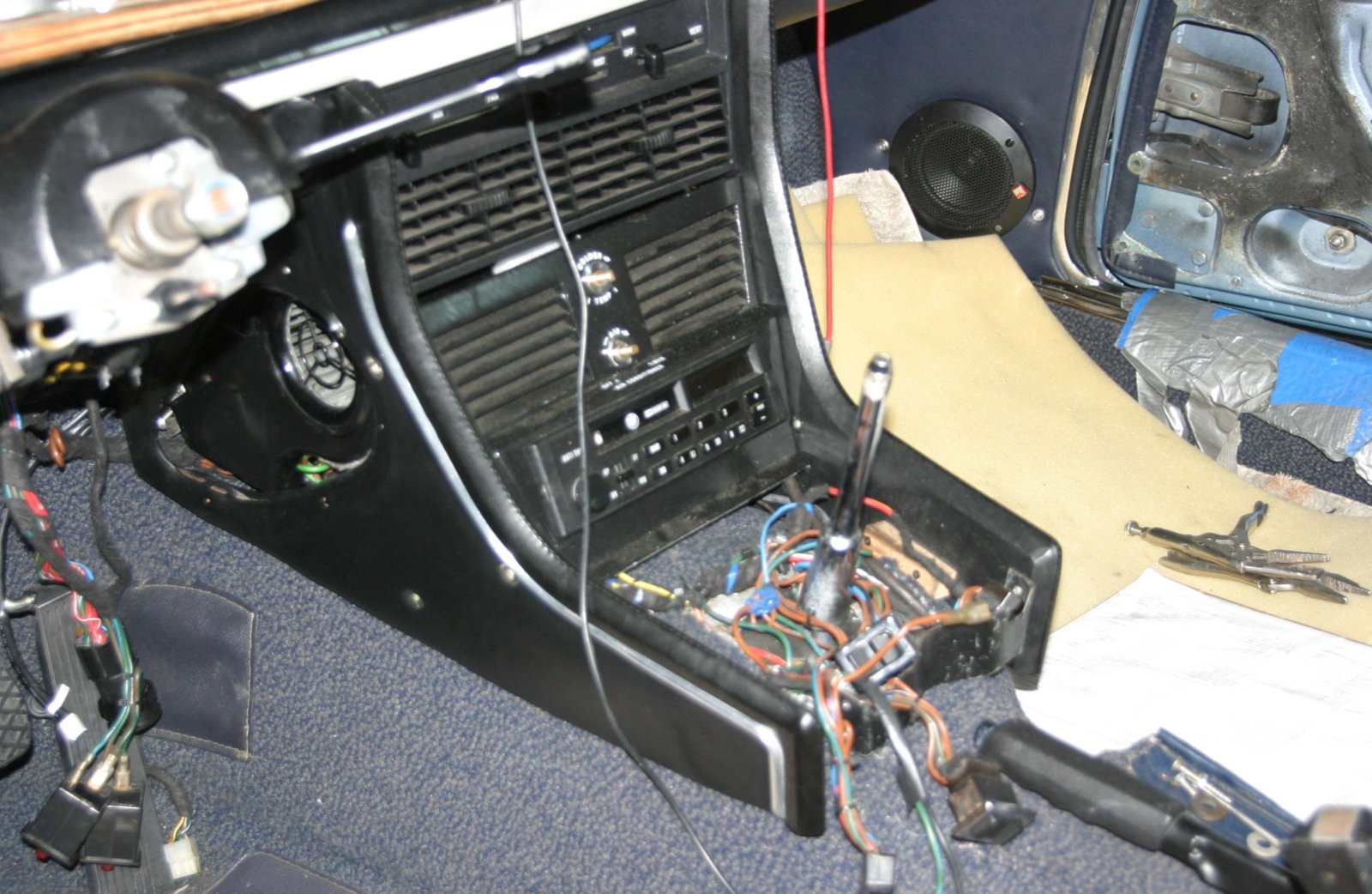

Here's a shot of the Europa II in my coupe. And yes, I'm a bad human being for cutting my faceplate. Well, it had already gotten kind of mangled as the spacing of radio knobs became wider through the 80's and 90's.

I will be installing a Becker Europa 599 model with cassette (don't think that part is operative). Selected this because the push buttons are on the top and easier to access in the e9 location. This is a DIN radio, so uses the large slot cut in my plate. Probably produced in about ~1981, so it's not exactly 'kosher' for a '74 e9. Not too hard to attach an iPod or M3 source for music to it either. I have a writeup I stole from a vintage Mercedes page for building that source adaptation. Contact me by direct email if you'd like a copy/ the link. Nere is a link to an 'auf Deutsche youTube demonstration of the radio,
, and a better picture follows:
Gary
