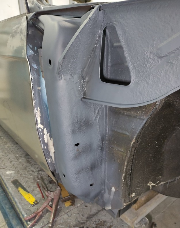

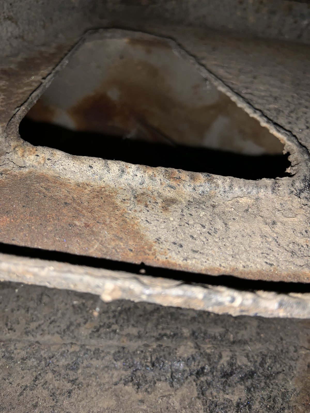

Inside the front fender there is a triangle shaped "rat hole" that seems to be a good collector of dirt and water. Is there a plug designed for this to close it out?
Thank you

Not officially. Clean it, apply some rust converter, then cavity wax it. Make sure the drain holes are clear. Then blow it out with compressed air twice a year along with your fender seams which you've also done the same procedure on :cool:

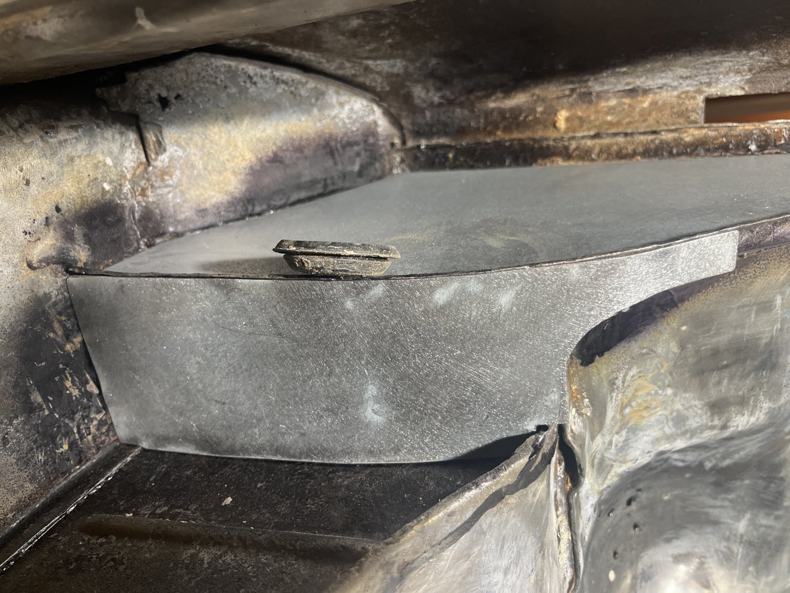

well, normally this opening is not in direct contact with water. When you look up inside your wheel well, you should not see that opening. There is supposed to be a plate with a seal (located between outer fender and inner wheel house structure) which prevents (but not very effectively) water and stones to enter there. Walloth and Neesch still sell it.
Google "Schottblech BMW E9" for some visual clues.

I don't think he is referring to the space behind the covering plate on the fender (part #41141814035 and 36), but rather the cave opening that is open to the wheel well and all the crap thrown up by the tires.

Indeed you are right, the Walloth and Neesch part, if installed, does not hinder water and stone entry here. ( I thought it did). Lokaris are the way to go, even more so with this addition from Steve.

The lower plates behind the wheel well are 51711813031/2 and they are below and behind the rat hole. I have vacuumed out a bunch of dirt today. I am definitely going with the Lokari Liners.

I have vacuumed 5 pounds of sand and very small rocks from both sides.
