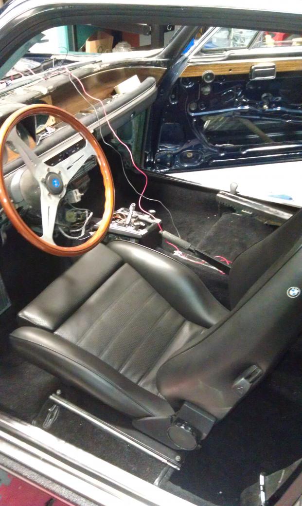

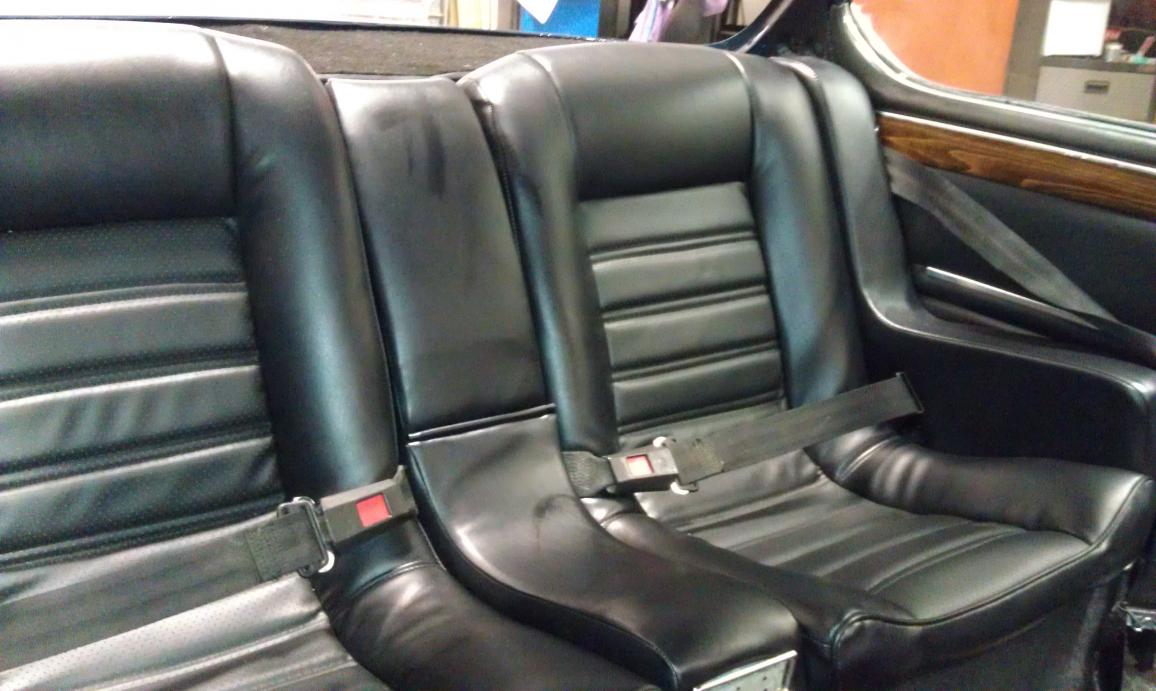

interior going in
As with the exterior, the tolerances are pretty exacting. Even though the upholsterer is good, lots of things need to be re-worked to make them fit correctly. I had the rear seats made to match the new front seats as I saw someone else on the forum did. It didn't cost any more so why not :)

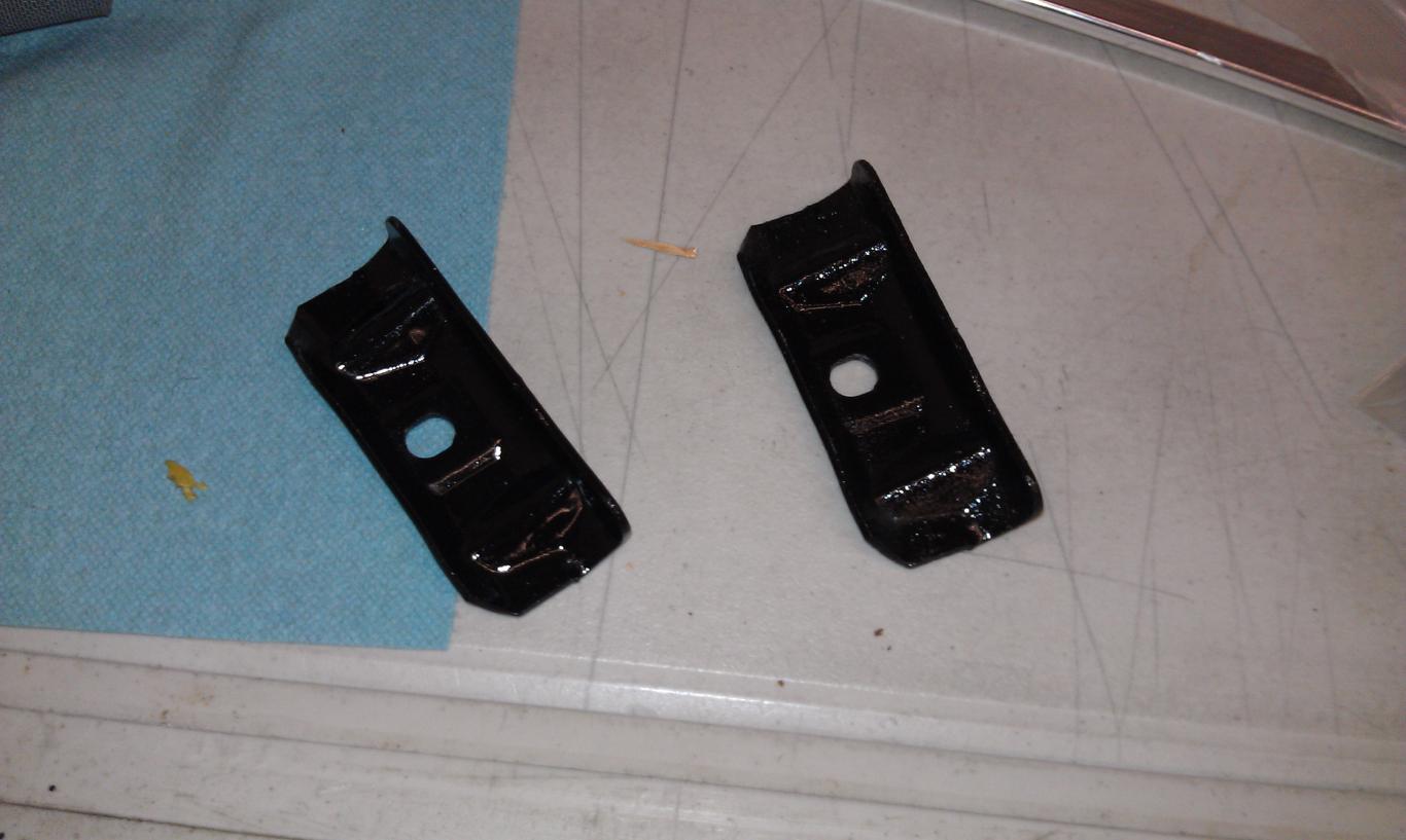

Can anyone identify these parts
I guess I did such a good job that I had parts left over:? These are the last two parts left over- Does anyone know what they are. Hopefully nothing that needed to go in months ago.

Well, Don.. yes, I painted them:-? but do they serve a function? A klobbershaft plate sounds like German for "Big Hammer", don't forget, this is my first e9 :)

Perhaps some sort of washer/backing plate for the 74 rear bumper mounts? I have not seen these pieces on a 72 (which I have had completely apart). I did have some "extra" pieces left over as well. I like to think that they were unnecessary.

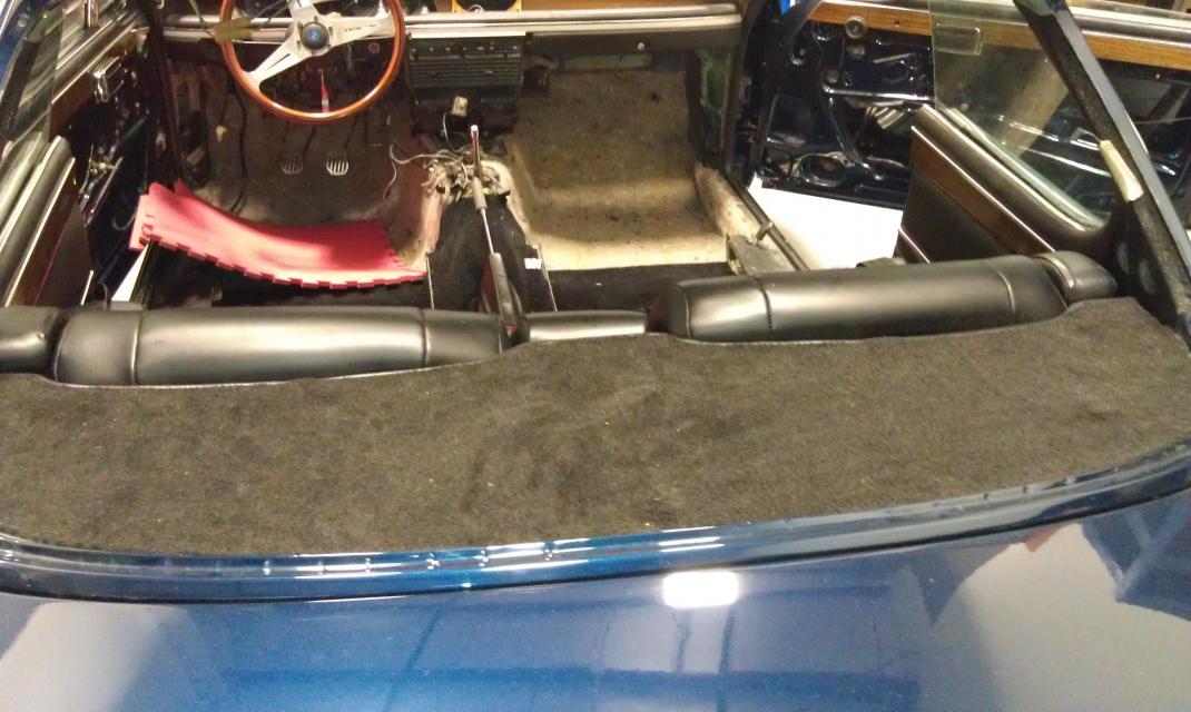

so far...
Those pieces seem unnecessary? I don't know, I think they may have been lose in the trunk when I bought her, maybe they hold something down back there? Not the battery hold down.. I don't think, but you never know. Anyhow, a couple more shots for the record-

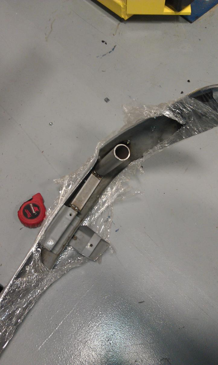

Has anyone tried this with the rear bumper (newer to older conversion)?

no, but interesting
took me a while to figure out what i was looking at there - so you are going to use the three large holes in the body/frame (74) to mount the euro bumpers? including the middle one? how does the bumper height come out?
creative solution and much easier than all the body work needed to weld up all those holes.

I'm Hoping so
Right now I'm bolting everything up and making sure the bolt holes on my brackets are big enough so I can adjust everything (a carry over lesson from the front mounts). Before final mounting I have to weld it to the '72 bumper brackets because the bolts would hit the body. Once I get everything measured I'll take some more pics, but I just could not see drilling into the new paint and it just did not seem strong enough. I think the bumper height is correct because I got the holes for the bumper-etts to line up with the rear valence which came off a 72 since mine was trashed so I think the height will be correct. Once the 2 end ones are on the center tube should be easy:roll:
