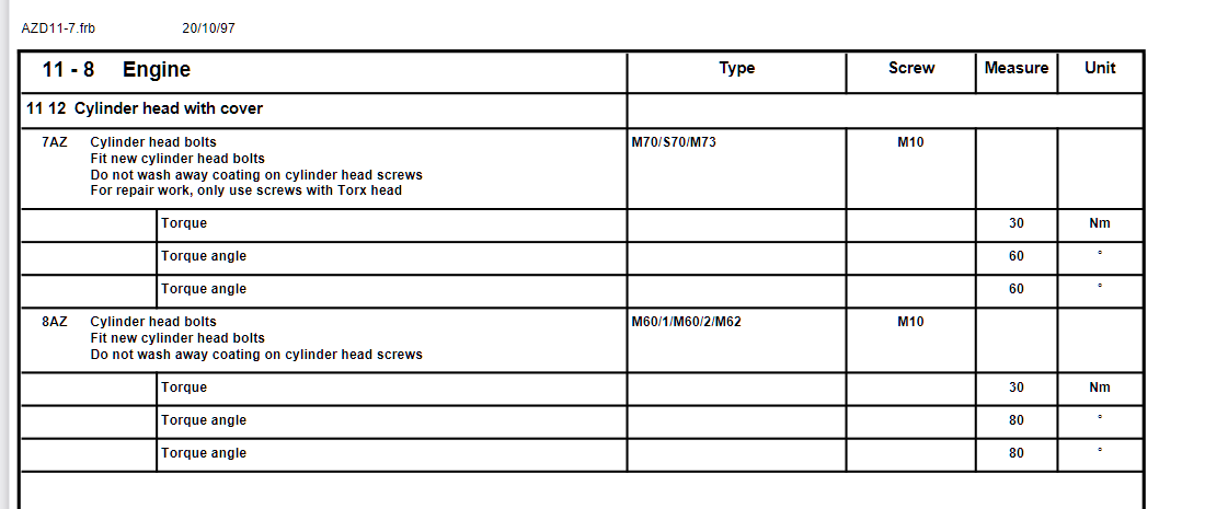

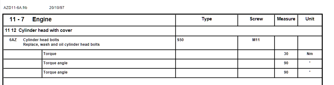

At the risk of stirring the pot, use of the term "replace" is admittedly ambiguous, but contextually, it can be interpreted to mean "re-use." Otherwise, why does the same source specify: "fit new cylinder head bolts," instead of merely specifying "replace?"
FWIW, previous thread regarding torque-to-yield head bolts. >> https://e9coupe.com/forum/threads/question-to-retorque-or-not-retorque-the-head-bolts.10288/
Those Germans, you just never know what they mean. Interpret as you see fit.
