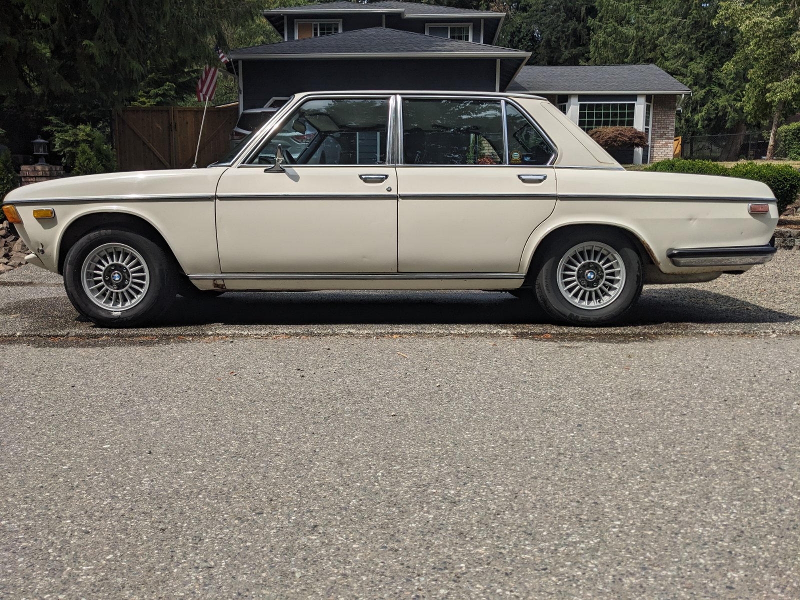

Ready for the Wundercar Social this Saturday in WA State!!!
Finally got my car in tip top mechanical condition and as good as I could appearance-wise given the original 1972 paint.
I've owned the car for just over a year now and have been busting ass on getting this car to where I am happy with it...for now. Still a lot I want to do but she is sorted at the moment. I few highlight items that have been done over last 12 mo:
*Front and rear suspension refresh
*Steering overhaul
*Complete carb teardown and rebuild
*Diff service including bearings and diff mount
* Rear wheel bearings
*Rear brake caliper rebuild with frah pads and rotors
*New rear brake hard lines from distribution point to caliper
*Transmission seals
*Pilot bearing and rear main seal
*New clutch, TO bearing
*Flywheel resurfacing
*Clutch slave Rebuild
*Plugs, plug wires, distributor cap
*All 3 belts
*Engine mounts
*Trans mount
*Shift tower and linkage refresh
*Center support bearing
*Park brake shoes
*Half shaft with CV boot rebuild
*Driver's seat upholstery
*Rear headrest upholstery and
*Trunk lind reskinned in matching Marineblau vinyl
*Rims and tires
*Windshield wiper fluid pump
*Voltage regulator
I'm sure there is some stuff I'm forgetting but that's OK.
Thanks to all who have answered my stupid novice questions along the way! And special shout-out to @sfdon for hooking me up with some hard to find parts, some of which I haven't even installed yet.
Prost! Time for a Paulaner
