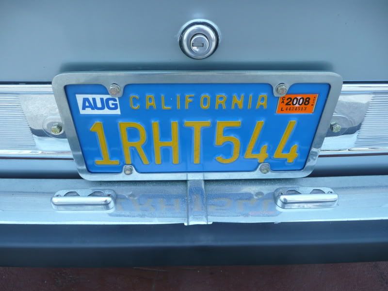

Ears sticking out or concealed, here is my setup. Looks pretty good in my view!
I was fortunately to acquire 2 new chromed brackets, don't know whether they are oem or not. Most brackets that I've seen are cadium or zinc plated.
Anything can be improved upon, even factory designed parts. For something as simple as the plate brackets, why bother! If the single mount method is used, it will leave you with a new problem. How are you going to cover up the 2 outside holes or the exposed bolt heads?

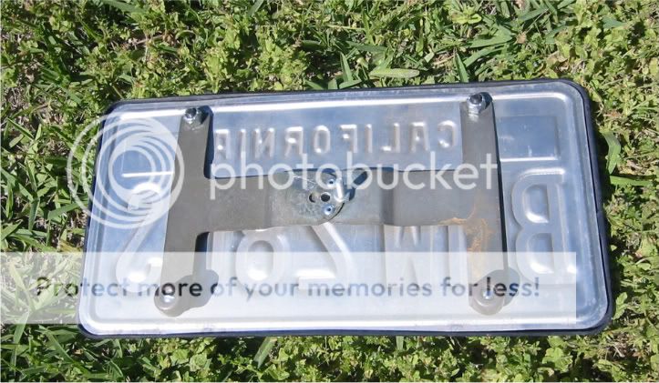

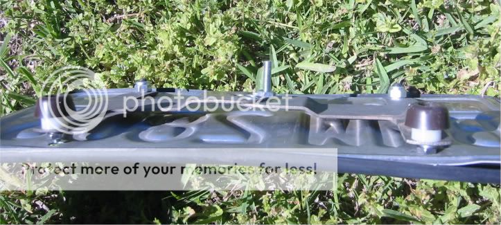

I'm the person who started this thread - I certainly didn't expect it to become such a complex topic!
Here's what I have accomplished in the past week:
- While I understand that a US-sized plate can be mounted using the two outer holes in the rear trim panel, the masochist in me wants to use the center hole, so that the two "ears" won't show.
- Today I discovered that the center hole in the trim panel is NOT centered. It is a good 3/8" offset - which seems pretty odd. So, using the two "T" shaped pieces so that their "ears" overlap at the center (see photos from my first post), and putting a single bolt through the holes in the "ears" and through the center hole positions the plate off-center. Hmm, that's not good.
- I modified the plate bracket by attaching the two "T" pieces with a pair of pop rivets, and putting the mounting hole off-center to compensate for the location of the hole in the CS body (see photo above). Now I have my plate attached to the center hole, with no "ears" showing.
- I added two 1/4" thick nylon spacers and bumpers to the lower tabs on the "T" brackets. These sit against the bottom of the chrome trim panel, and keep the license plate assembly parallel to the body (see photo below)
I'm not sure the job is done, but I have made some progress.
