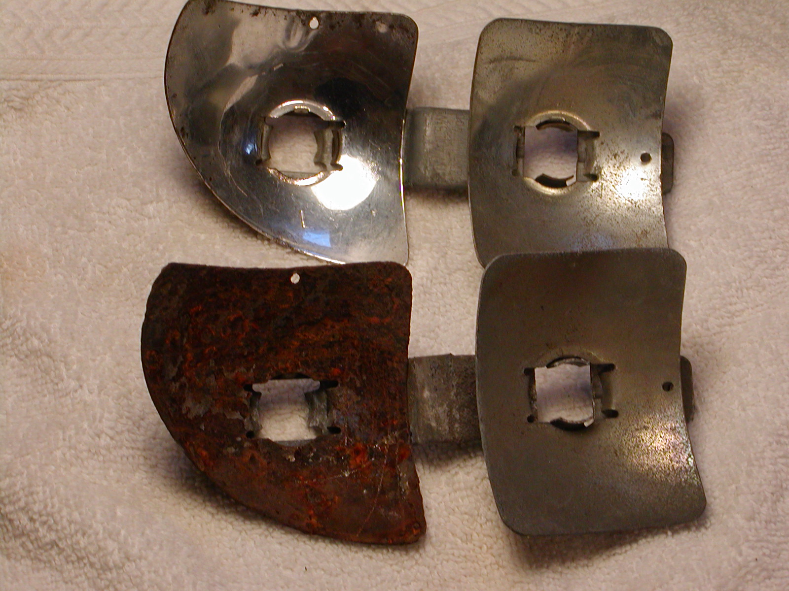

First, two 'as received' reflector sub-assemblies. Top one is exceptionally nice, and sadly rare. Bottom one is more typical, I have gotten several like that. This part is for turn signal and tail light.

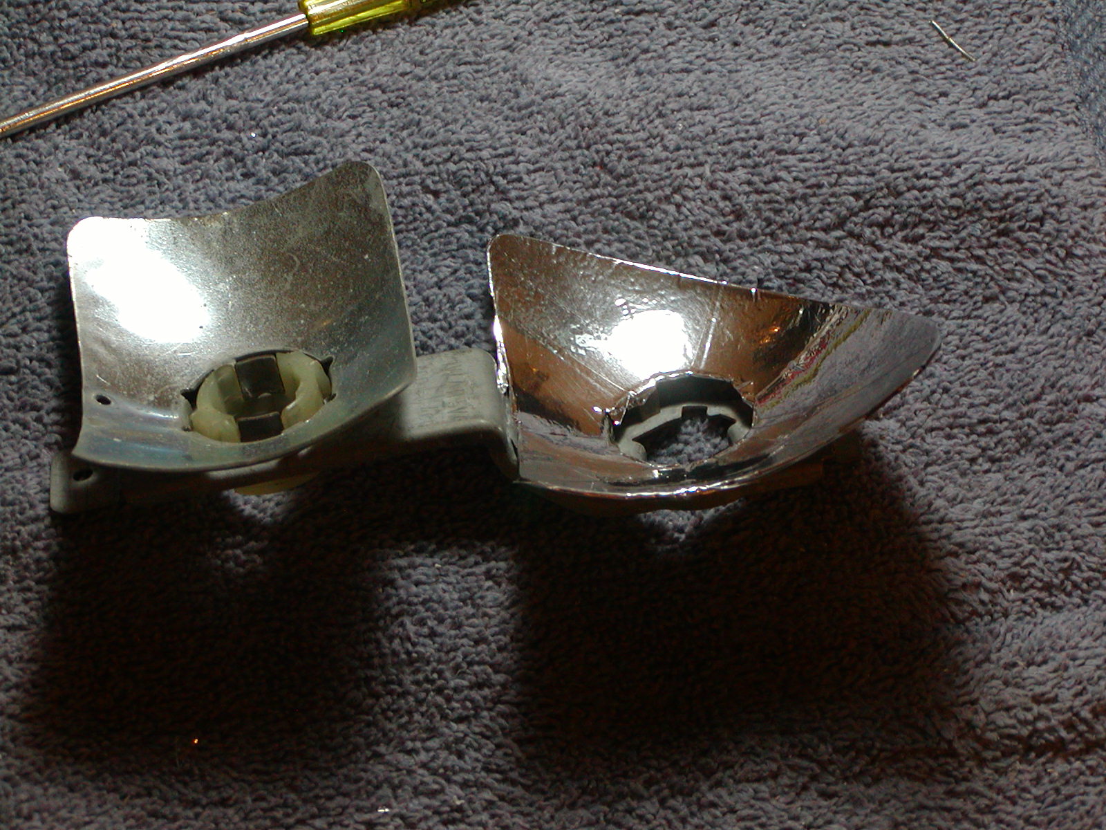

Second picture, silvering applied to turn signal - more than doubles the light reflectance (my opinion).

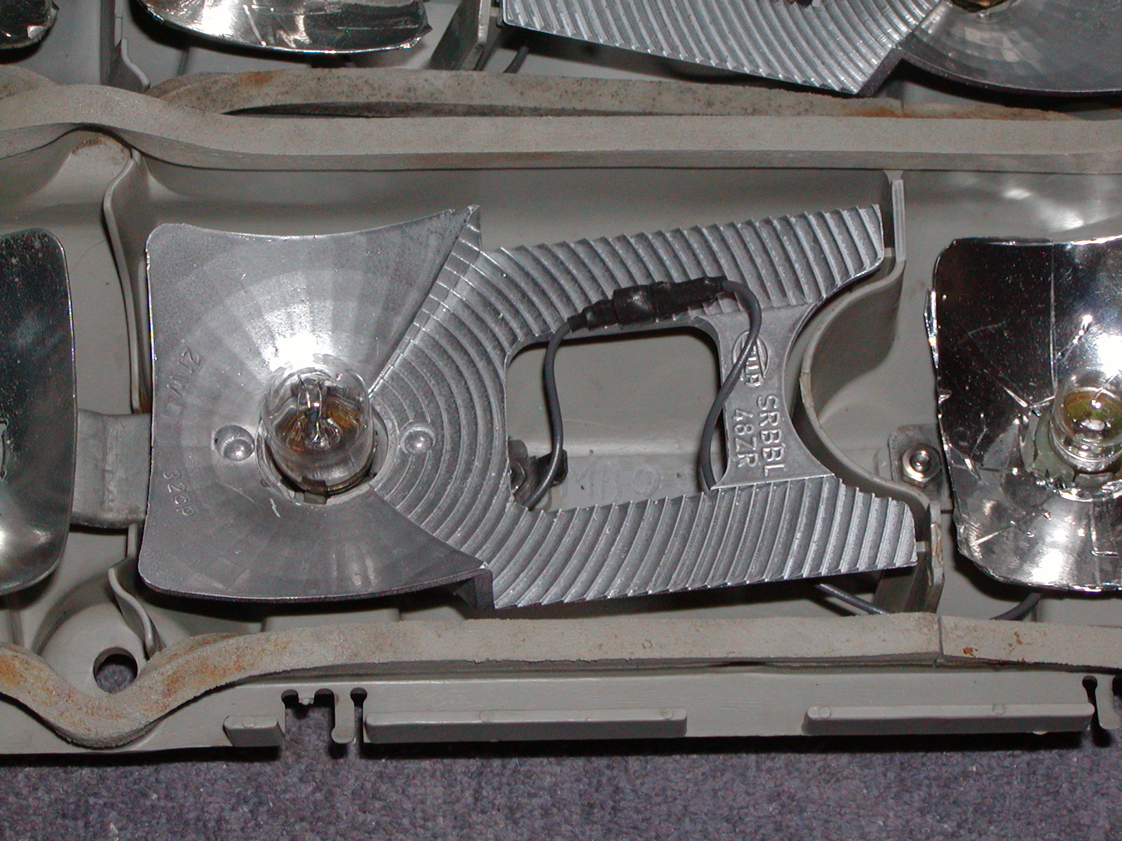

Third picture, assembled with some silver paint (brake), some film. The wire is for the dual tail light upgrade.

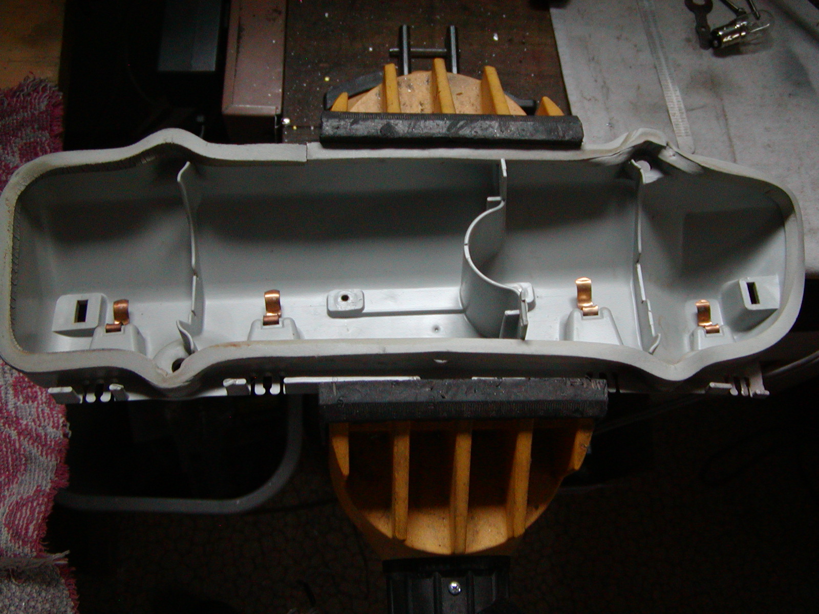

Fourth picture, cleaned shell interior with restored bulb base contacts and restored original seal.

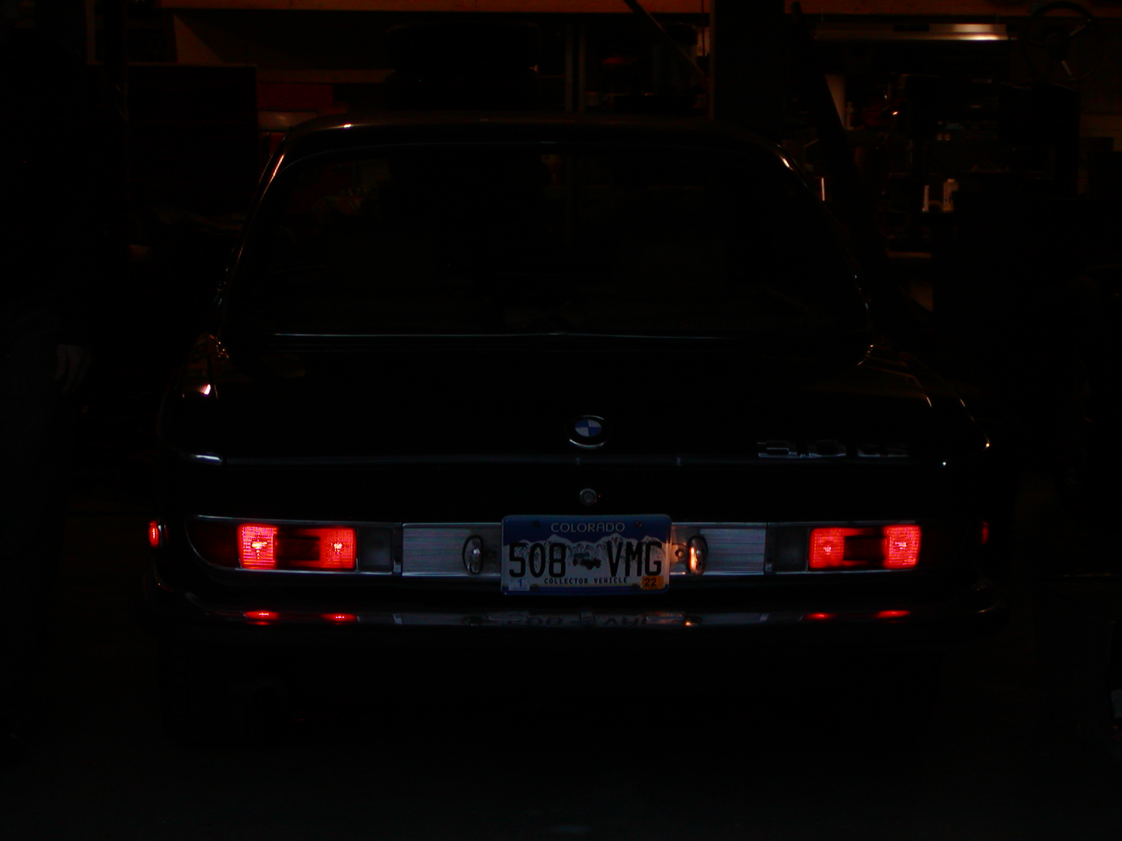

Last picture, neighbor Wayne's coupe with dual tail light upgrade. NO WORK on reflectors, just the upgrade.
