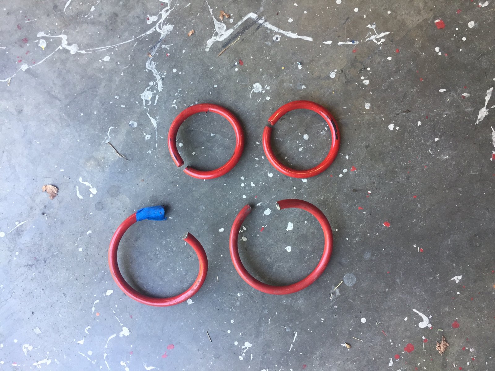

The previous owner of my coupe cut the rear springs, then apparently changed his mind. There was another spring "installed" on top of the now shortened rear springs. I don't think it was the cut off coils, but I'm not sure. The springs were replaced as part of the sale so I didn't see them after they'd been removed. Moral of the story: don't cut too much off!
I'll second that. I've lowered several hotrods by cutting coils. I learned the hard way to go slow. Having to cut the same coil a couple of times to dial in the ride height desired is better than having to cut multiple sets of springs when you cut too much the first time. :mad:
It might have been a helper spring just to maintain some tension in the cut spring when the suspension is at full drop.
