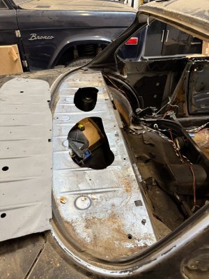

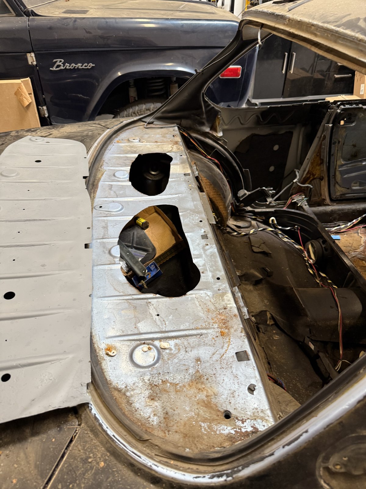

My car has “special” holes for some weird speakers…
