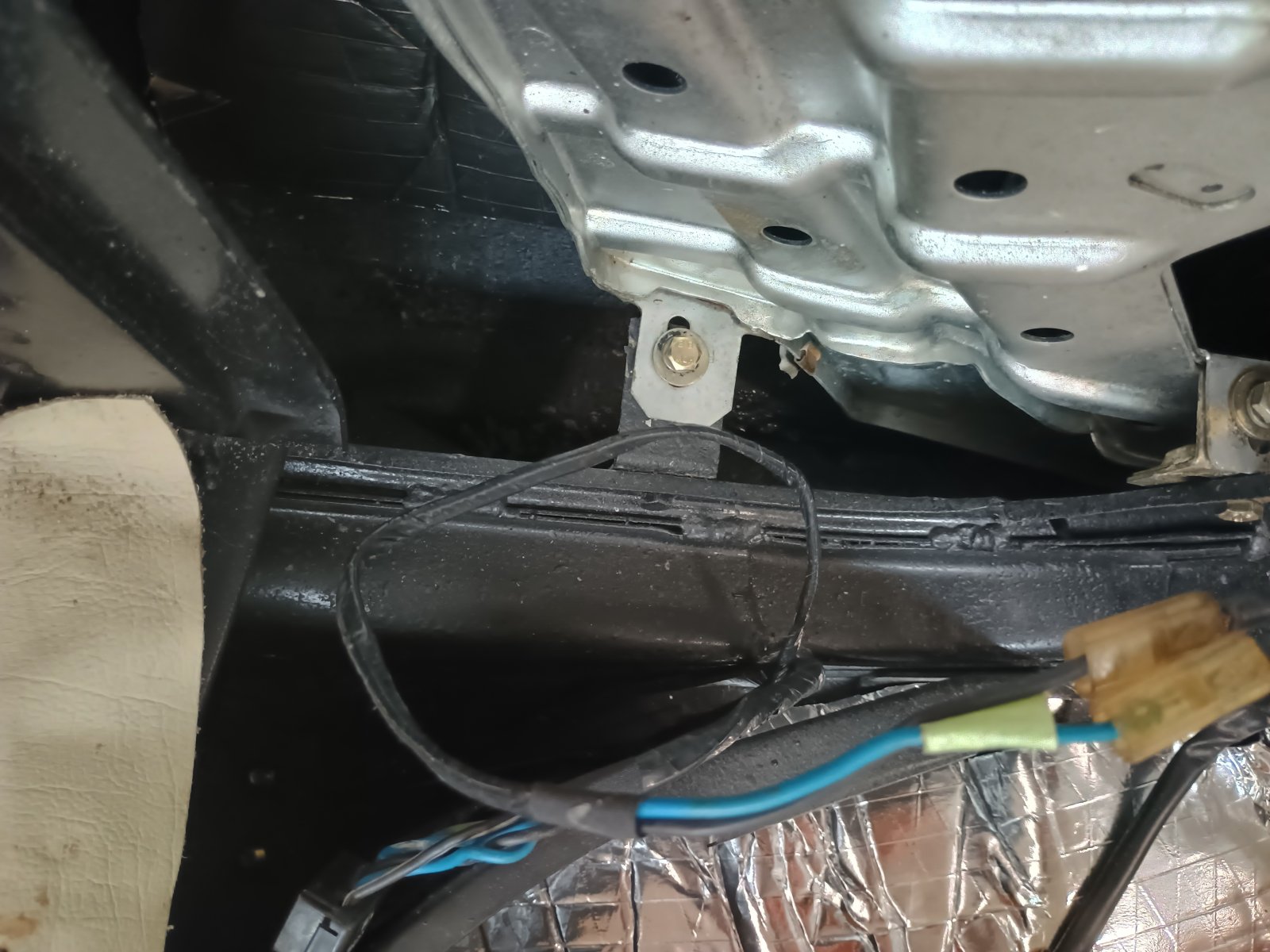

I am assembling the rear quarter panels and trim, the power window wiring is not in the correct place with no clear way to go into the rocker cavity. How does it run? I was not the tech who re and re the wiring harness on it, I have photos but not showing where the harness runs from the floor pan against the rockers to the quarter panel cavity.
I looked at various write ups and media photos but not finding the exact way it routed. Anyone know?
here is where it's located right now but not correct. 1975 CSi
the portion that goes to the motor runs over the top of the bottom rail, then loops into the 'hook' above the terminal block then drops down into the block + screwed in. the insulated female spades go to the switch at the front of the rear arm rest. the rear side panel doesn't put any pressure on the wiring and everything is covered up by the rear side arm rest. remember, i have an early car with sardine motors, so it might be slightly different ... but should basically be the same.
Thank you for the response. It seems to me based on the photos I have the wires came up from below in the rocker cavity but not that “clear”. I can certainly route them over the rocker box section just not sure the switch harness will reach that way
the wires should run down the inside of the car under the carpet on both sides. there are little hooks that hold them into place. the passenger side is fed from the drivers side and crosses the car in front of the front seats and goes to the switches at the console. they do not go under the car or into the rocker cavity
