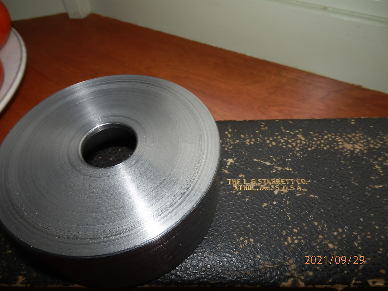

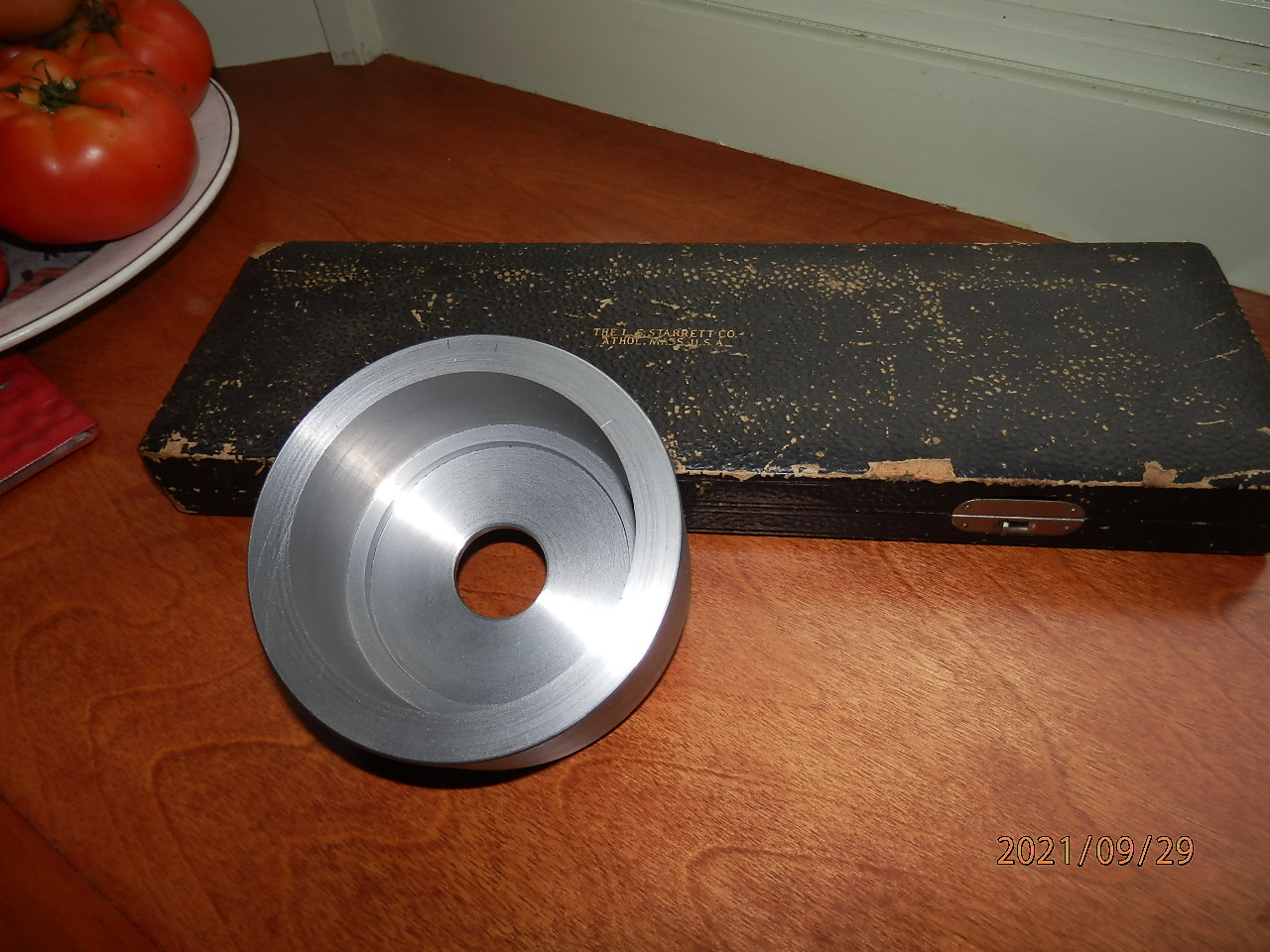

I now have one of the repair parts made up and will be contacting a Lodge Brother/neighbor who is certified for submarine welding. Thing is, he's retired and I don't know if he's flexible enough to get in the trunk!!
