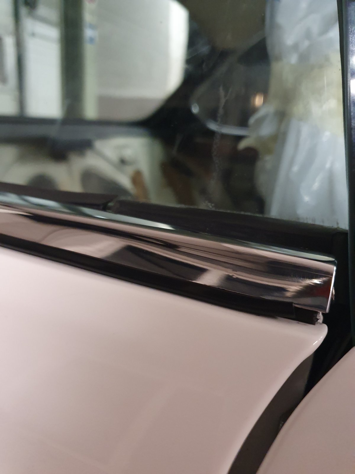

Agh, the rear side windows! I read another thread where a guy said he’d spent nine hours on his and I thought well, no way – but totally found out that it’s a bugger of a job and it took me longer than him! A few tips in case it helps someone facing the rear window challenge:
1. Assuming the window is in, before removal put some tape along the top of the glass where it meets the felt channel – check that there is a good and regular seating of glass in the felt channel and adjust tape if necessary. These tape marks will help when winding the window up to clearly show whether it has fully seated all the way round or not (otherwise it’s hidden inside the channel).
2. I replaced the rubber blocks. I agree these don’t need cutting, it is just a matter of fitting the glass correctly. When fitting the rubbers to the glass, ensure they are pulled forward properly – the back of the block on mine kept against the chrome outside trim piece.
3. I superglued the top of the rubber bock to the glass - otherwise if it touched the outer chrome trim it pulled away and jammed.
4. There is some forward/back adjustment in the glass where the two bolts secure it to the frame. Also, forward/back adjustments can be made with the two bolts on the black inner skin.
5. I didn’t find much ability to change alignment with the lower bolts as once the frame is fitted at the top it is pretty secure. Luckily, I didn’t have much in/out alignment issues.
6. I trimmed a 1cm long shoulder in the top seal to better allow the chrome strip on the front edge of the glass to seat better inside the felt channel – it’s obviously wider than the glass but the channel doesn’t normally allow for this.
7. I had problems with the block being too far outboard, and catching along its side edge on the chrome strip. There are two in/out alignment bolts on the black panel, but mine were fully wound inbound so I needed to grind off some of the front of the window mechanism frame to allow it to move more in board and put a 3mm spacer at the top bolt between the B pillar and the frame to bring it onboard - otherwise the frame caught on the B pillar internals.
8. Clean and re-grease mechanism while it’s out.
9. The bung stop for top alignment on mine was fully wound in, miles from touching when the window is closed - I left it like that as couldn’t see the need for it given the mechanism stops when the glass is fully seated. I thought one less headache to bother with! I wondered if this is the factory setting, leaving it redundant.
10. Before removal or refitting, stick some protective wrap on the glass to avoid scratching when getting the mechanism and glass in and out. It’s a tight fit and took me about 10 ins and outs to work out the best manoeuvre to get it in and out. It’s got a mind of its own and seemed to be slightly different each time
Best bit of advice – pay someone else to do it! I was going to replace both sides’ rubber blocks, but can’t face the trauma again!
Cheers, Chris

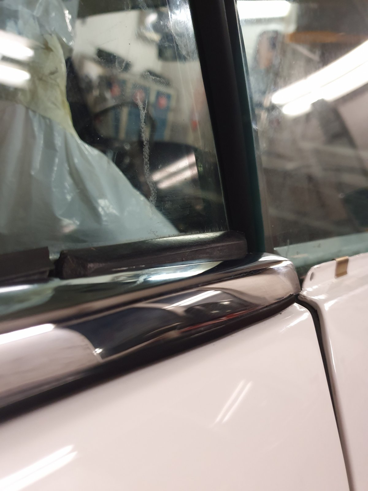

I feel your pain and these are some good tips. I did this two weeks ago and dread ever doing it again. One thing I found and mentioned in some thread was that the new front lower rubber blocks that secure the window dragged exactly as you describe and would jam the mechanism preventing a full closure and also thereby not making a tight seal. These new blocks I had were thicker than the original ones on there. You superglued them to prevent them rolling. I tried gasket adhesive but that didn’t hold well enough. I didn’t want to use something as permanent as superglue so once I had mounted them onto the window but still on the bench, I used a small electric handheld sanding tool to thin down that rubber. Took a few repeat sandings (each time putting the window in to test and then taking it out) but finally got it. They start at about 14 mm thick and should be closer to 10 (for each leaf, the front and the back). I had sourced these from W&N for about $20 each, I think? Maximilien Imports has them but it’s $299 for the pair - that’s more than I am willing to spend, and I don’t know whether his would have the same issue. Where did you source all the rubber parts?
Also, for the rear rubber holder the hole in the glass is much larger than the screw that goes through it (an M5 or 6). When I pulled the windows there was some rubber “debris” in the space suggesting there had been some type of washer. OilsDesigngroup sells this part (for a good price, wish I’d seen that before my W&N order!) and it comes with two plastic washers to fill that empty space. The W&N ones didn’t, and there’s no washer shown on the oem diagram. In the end the window just rested at the bottom of that rubber but it does seem a bit weird.
