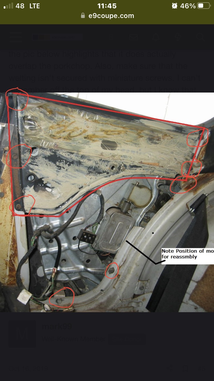

I am putting back in my rear side windows
And I want to use new bolts
Do you guys know the sizes that are needed for that and maybe the order they go in ?
I am asking about the ones circled in red below
Thanks again

Realoem says M6 x 16, which is my recollection as well. When you say the order, not sure I understand. Install all of them loosely and then adjust the window guide position, tighten one or two to hold it, activate the window up/down, loosen and adjust further as needed, retighten, etc and repeat until the window is moving correctly and then final tighten. It’s a lot of annoying adjustment.
I did find this video very useful
Perfect
M6 x 16 it is so .
Thanks a mill!
Realoem is usually spot on whennit comes to the screws and bolt definitions, even down to head shapes.
These m6x16 bolts only secure the black panel, not any part of the window mechanism or alignement

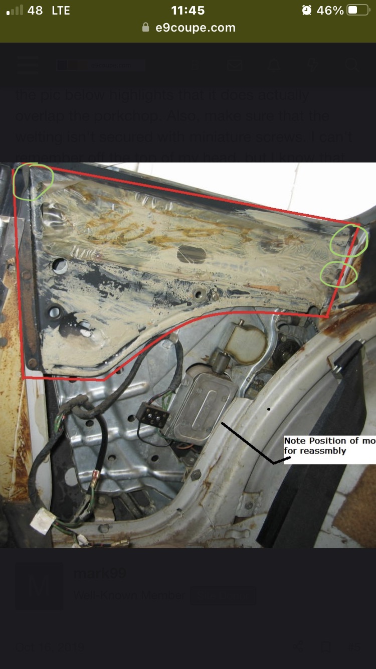

Yes, I do recall that some were shorter than others, realoem only shows the 16mm. As you place them back in, just be careful that any of the longer ones are not protruding in a way that would prevent the window from going up/down. It should be obvious - if the bolt sticks way out the other side towards the window, make it a shorter one. I found this process very annoying, but since I was starting with a nonfunctional window it needed to be done. Are you upgrading motors and adding relays while you’re at this point? Please say yes

I have started putting in the m6 x16 and I do think that I will swap out 3 of them for m6 x 10 as they do seem close to the window as it moves . ( circled in green below )

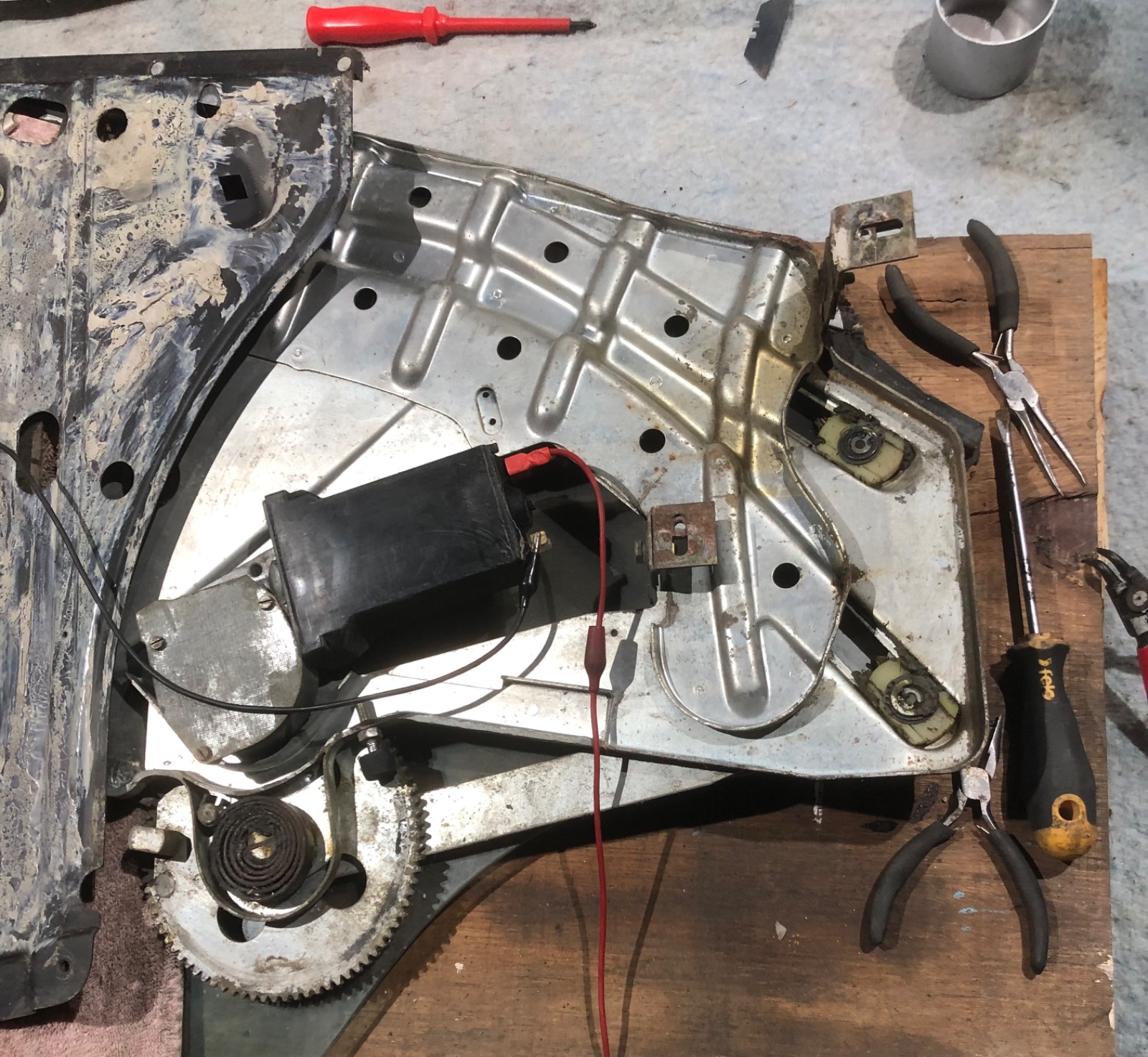

I do have the newer motor version , not the sardine ones , so they should work better. ( I used a photo from someone else’s car )
I have disassembled everything on the bench and cleaned out all of the old grease and re greased everything , so thankfully they seem to be working well as they are now

Hi Barry, you can easily remove the steel cover from your window motor, as it sits connected, and check the quality of the old grease in that gear box. Maybe you have done.
