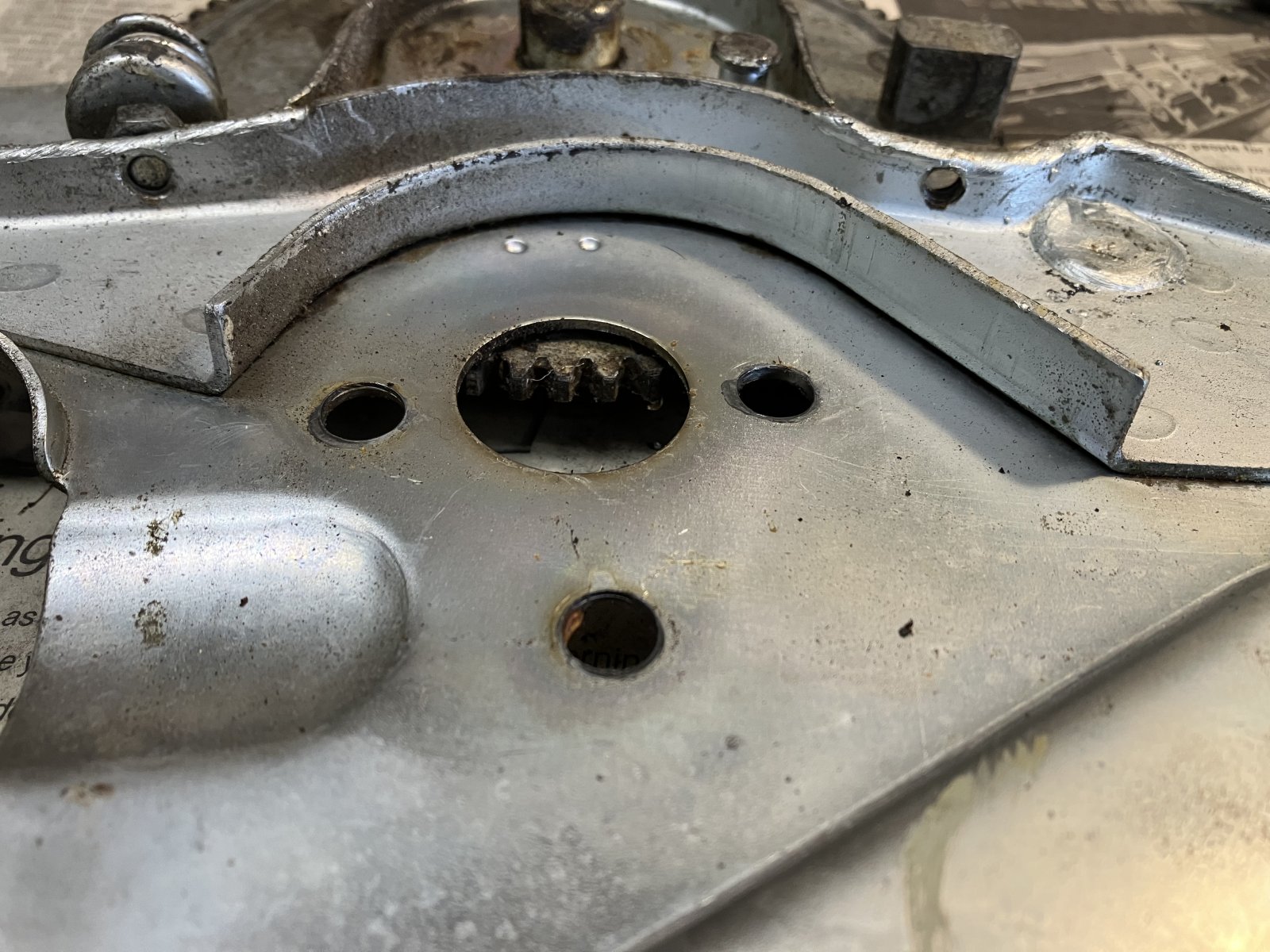

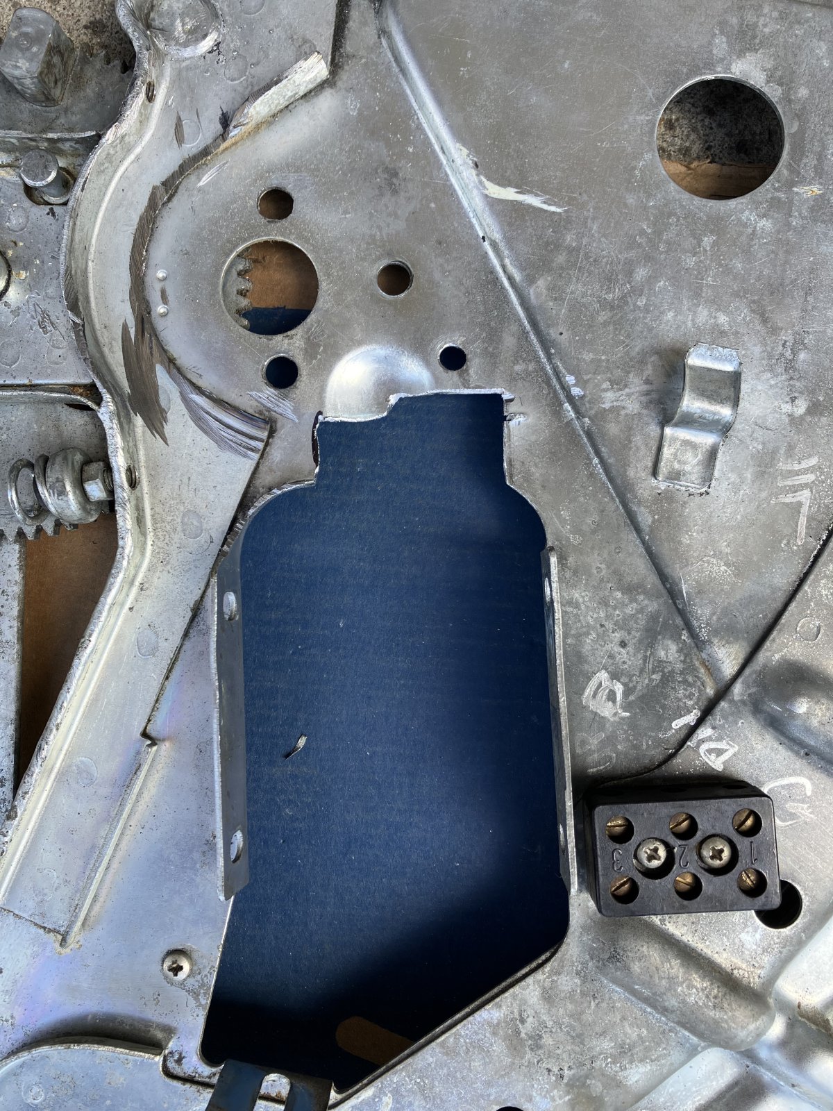

I recall posting a thread that addressed the necessary modifications to the rear regulator sheetmetal, but for the life of me, I can't find it now. In summary, the rears are similar to the fronts, in that you need to re-shape the cut-out that accepts the motor for the shape and location of the e28 motor. Additionally for the rears, you will need to cut off some sheetmetal - what HB Chris refers to as the "ridge" - that is present on the rear regulator (not clear to me what it's purpose was). The following photos show this:
Rear regulator sheetmetal before modification. The "ridge" is the folded-up, curved protrusion at the top of the photo:
Rear regulator with the "ridge" cut off, and the motor opening re-shaped:
