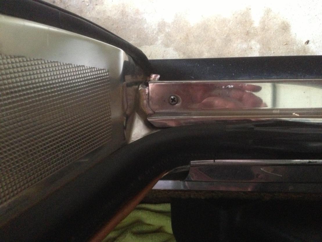

here is a pic from my car - ignore the electrical tape on the door seal - i need a new seal. Henrik is right, the painted rocker cover goes on 1st, then the door jamb trim, then the door seals ... then the outer chrome trim, then the inner chrome trim.
hope this works out
scott
