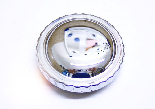

My Valve cover oil cap is leaking oil. Any recommendations on replacement? I found this one:

I think chrome looks really out of place in our engine bays. The gasket can be replaced. Suggest if you buy a chrome cap that you swap the gasket. or get one from Hal.
