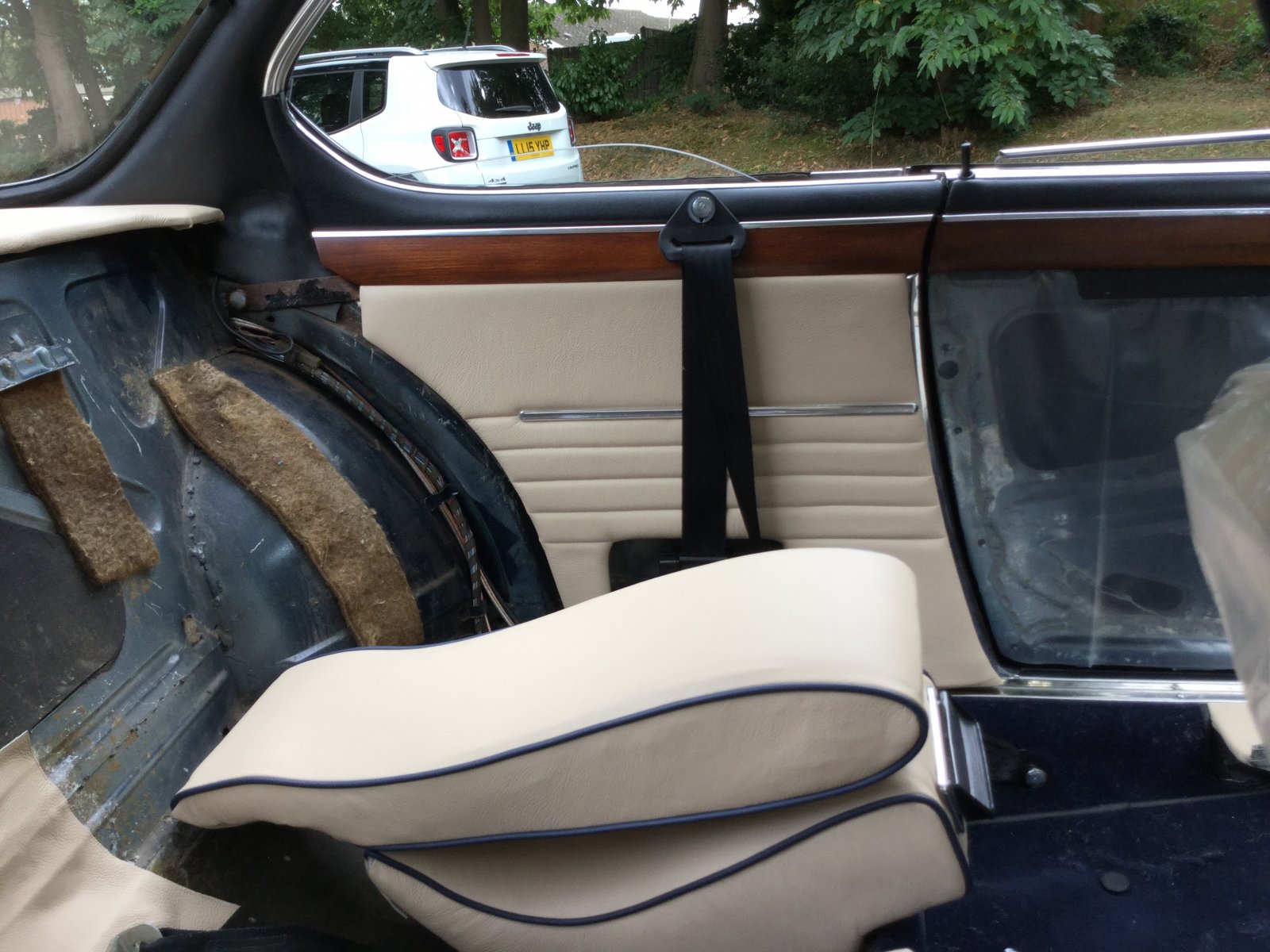

Here are a few snaps that show the rear door card, covered in leather which as stated above is not factory original.
The ash tray, which most defiantly is now where near factory finish.
I also liked the idea of blue piping to match the Atlantic that the car is painted with.
The leather rear parcel shelf, again not factory fit. I think the carpeted rear shelf was introduced with series II in late 1973, mine was built in December 73 and had a carpet covered rear shelf.
So you are all correct about the originality, but I thought they would be nice so put them into my car.
