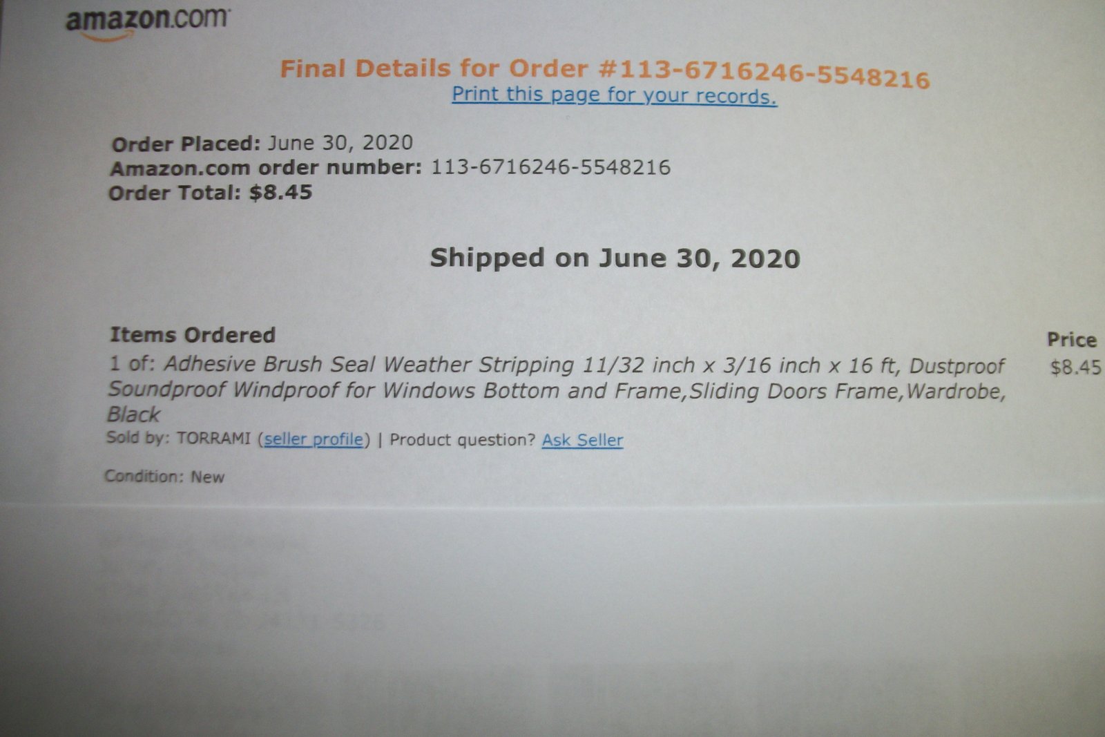

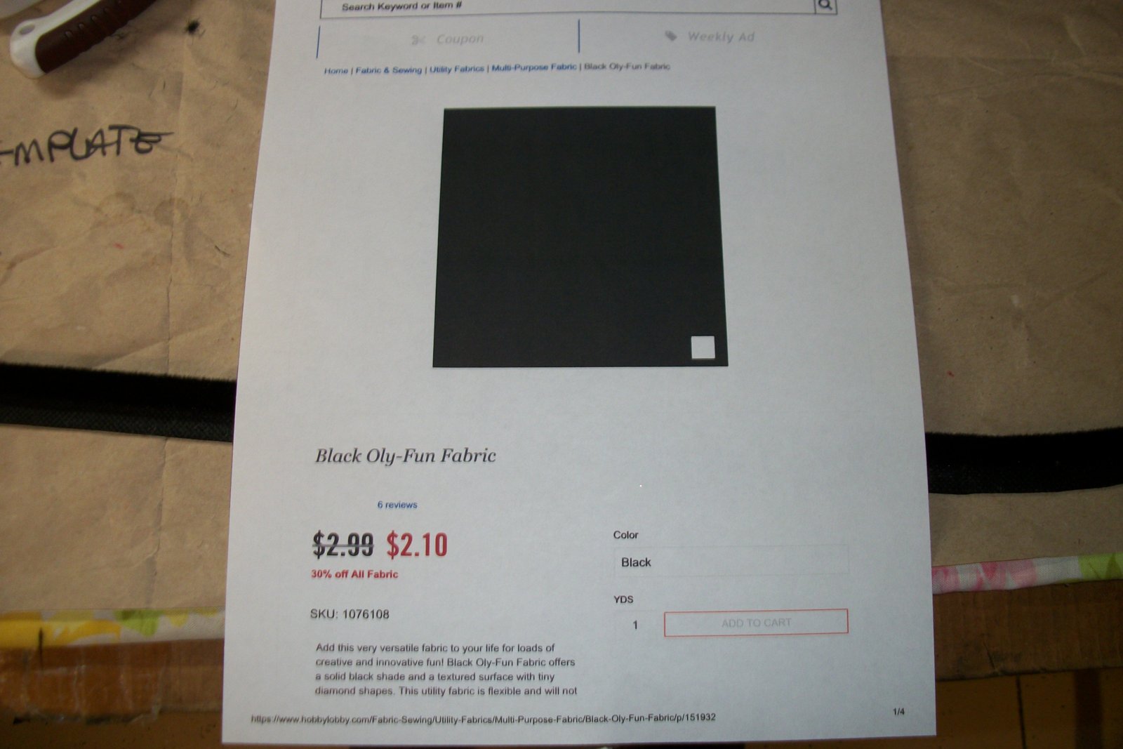

First locating suitable material. The front and rear inner and outer fuzzy portion of the weatherstripping basically consists of a thin black material that looks somewhat perforated with a fuzzy strip attached. We found what seems to be suitable material Hobby Lobby and Amazon.
The black material from Hobby Lobby is cheap
The fuzzy strip from amazon also cheap

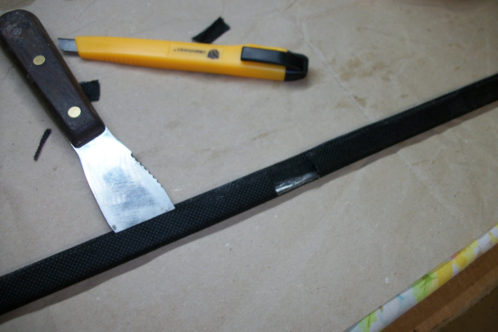

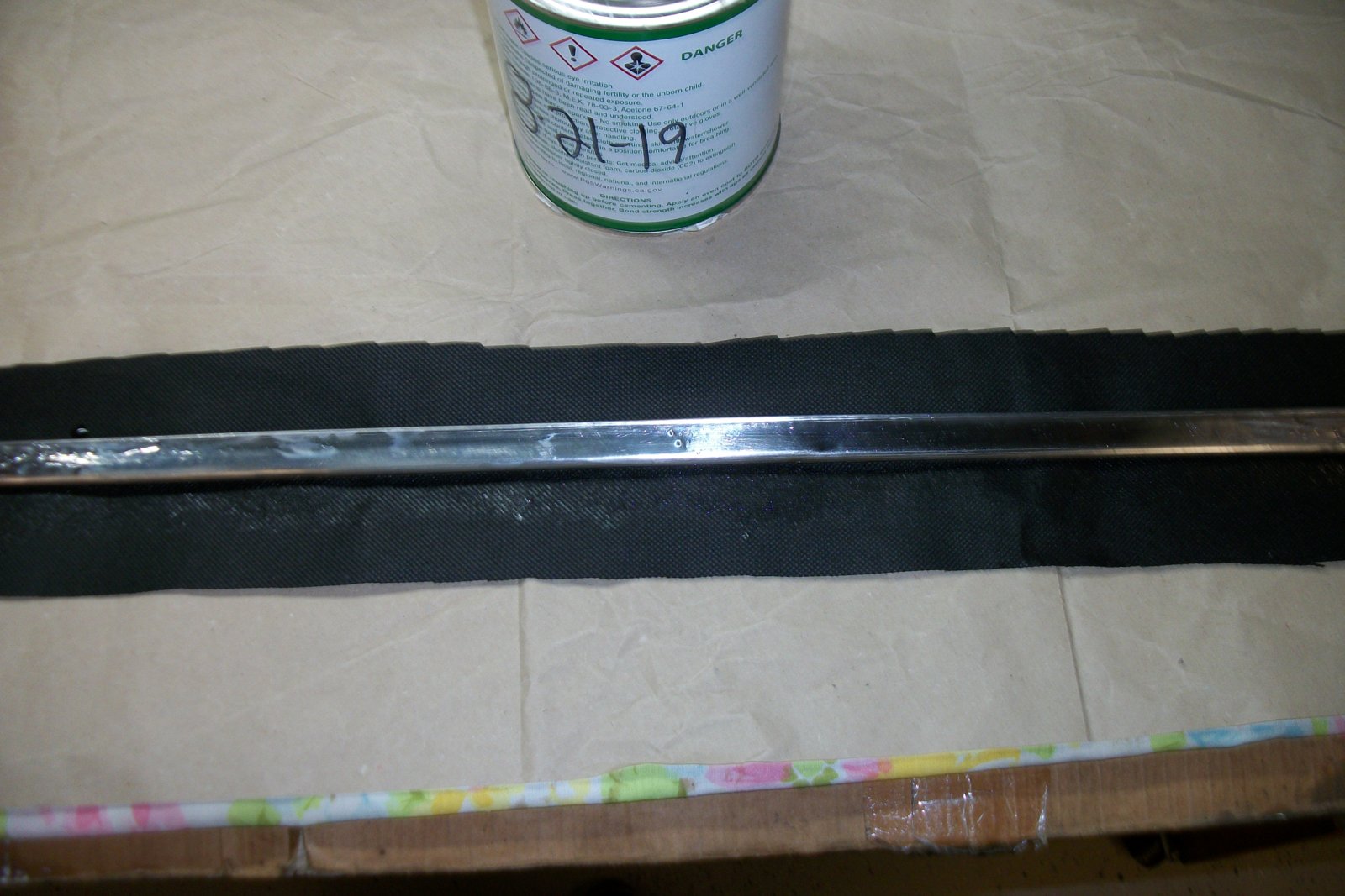

Here is the piece after we stripped away the old covering.

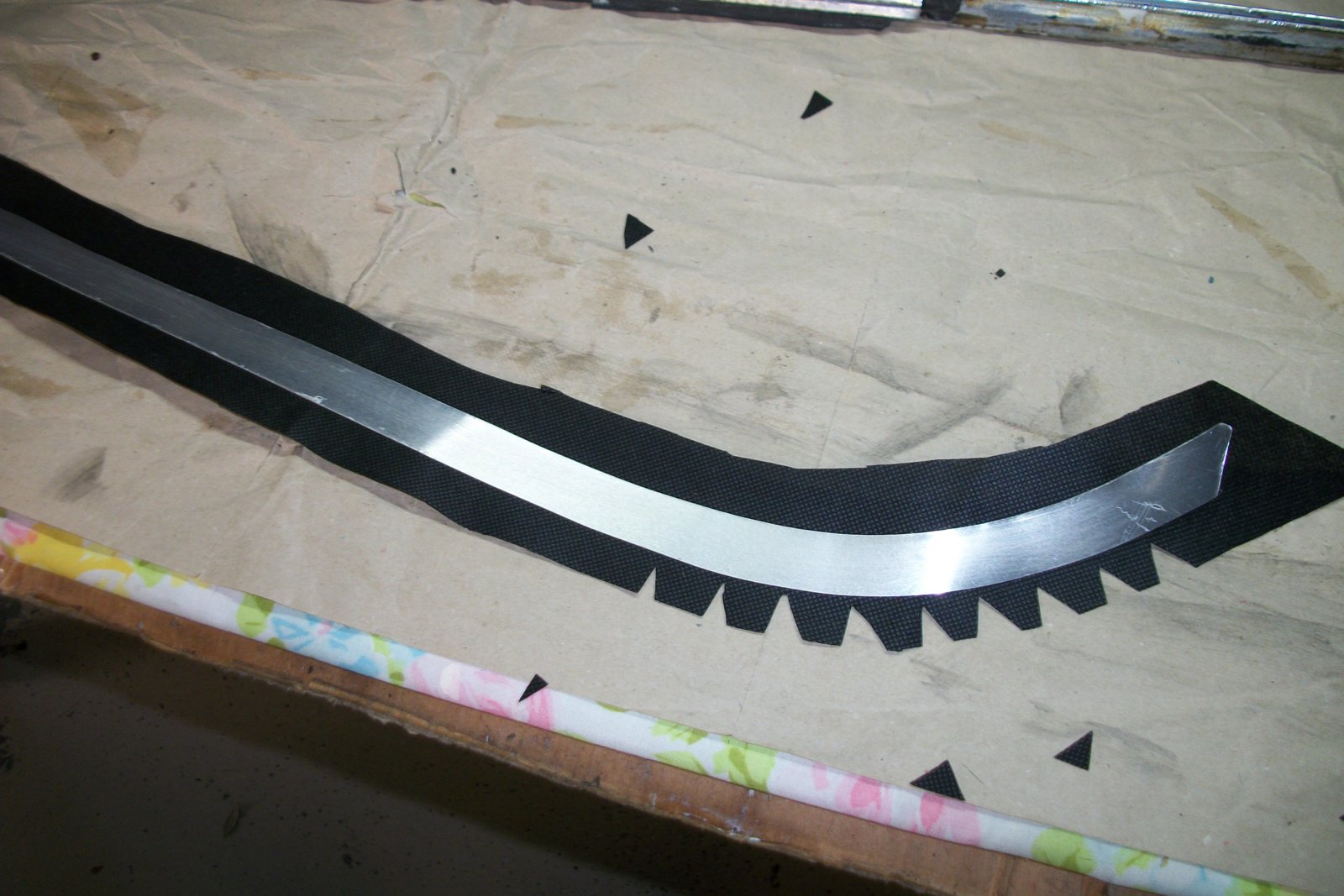

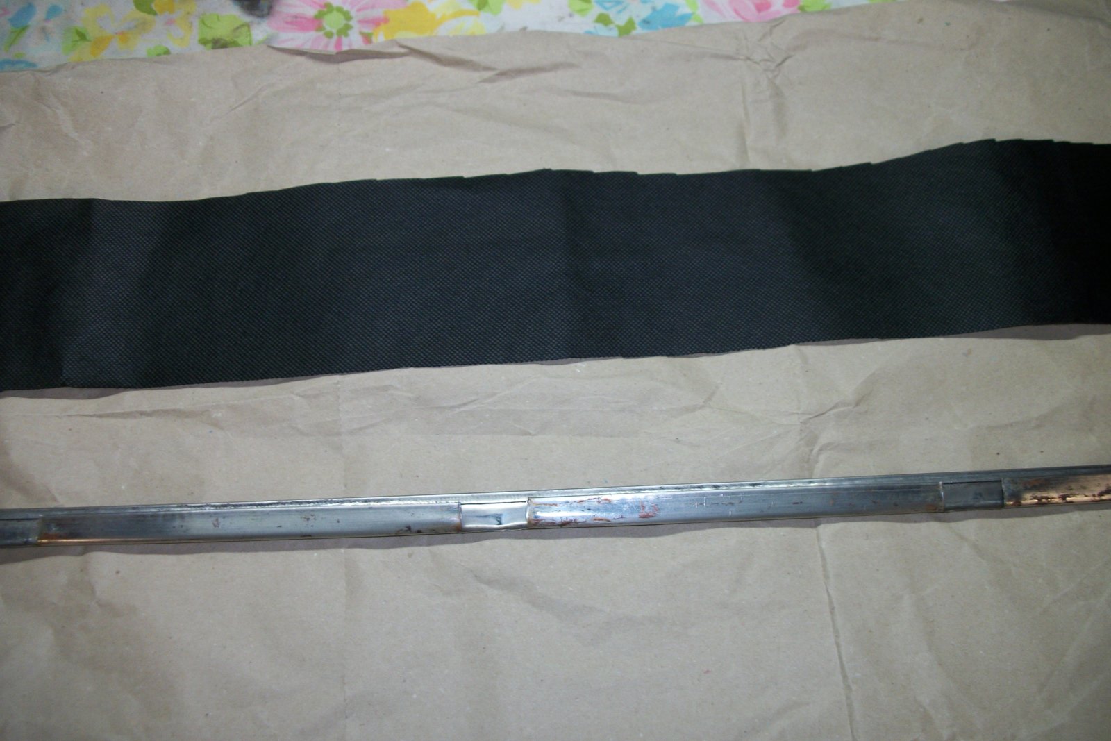

So cut a strip of the black material and glue it onto the cleaned metal sub-straight.
We use a vinyl cement

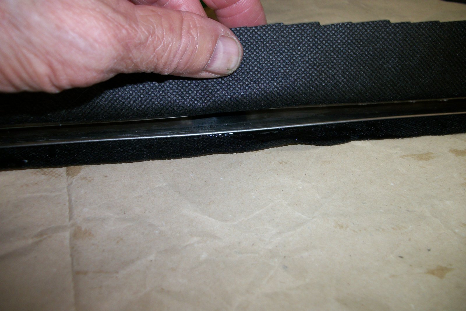

trim the material to be pasted inside so it just fits in the leg. Use a putty scraper to work the material inside before glue sets.

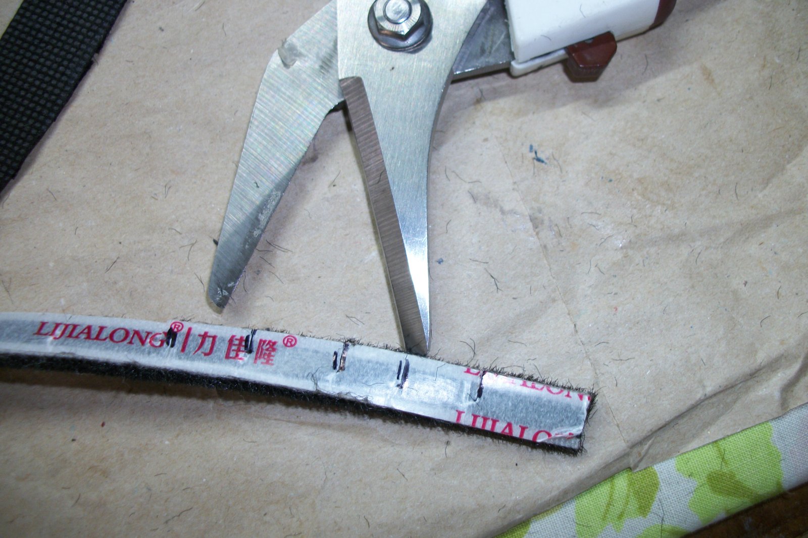

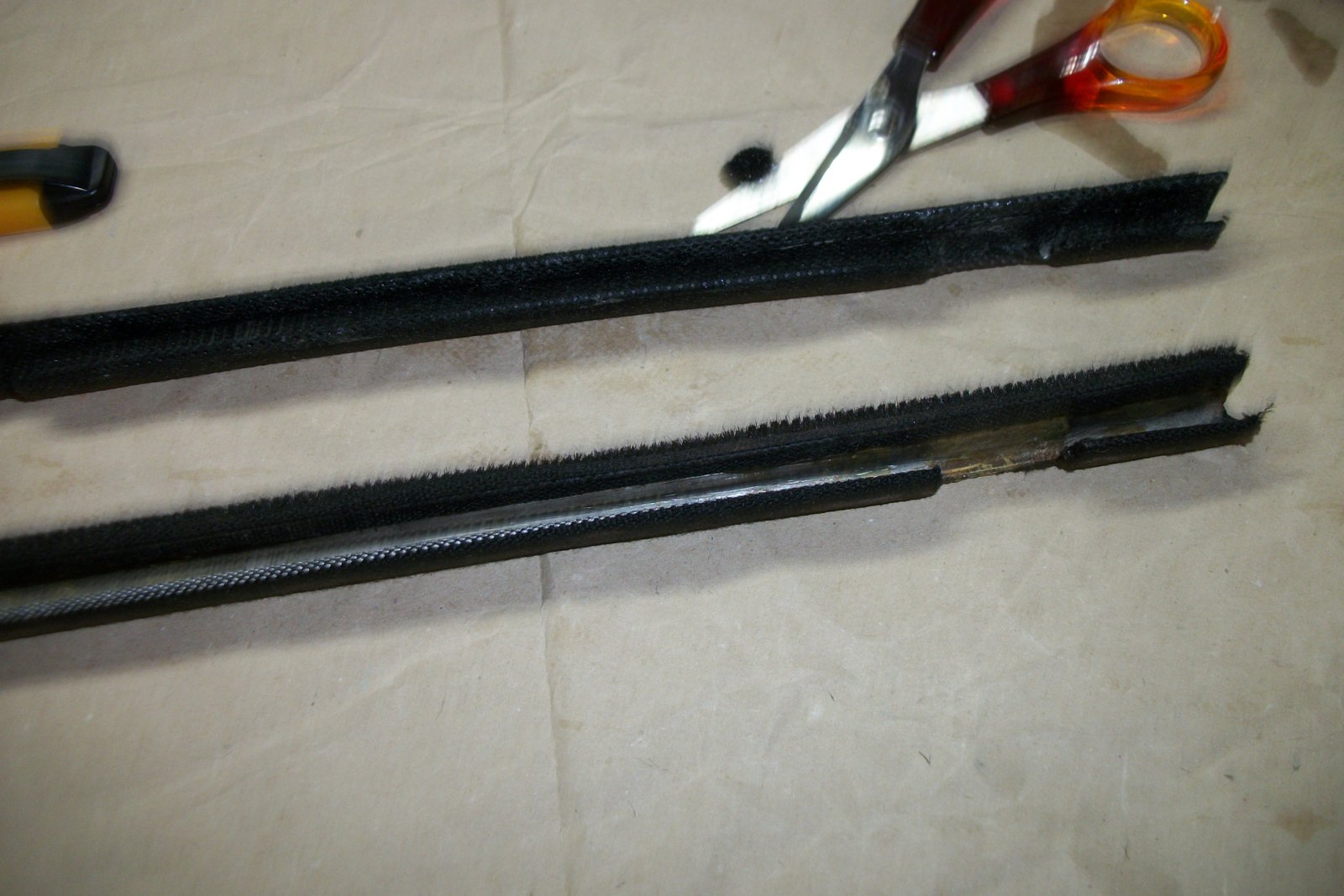

After glue dries trim around the cutouts and then apply the fuzzy strip, The fuzzy strip comes with a very strong stick-on adhesive after peeling off the paper backing. Get it lined up as one it is pushed on it really sticks. We suppose time will tell how it weathers and if it can withstand the window sliding against it. A lot will depend on making sure the window is subsequently aligned properly.
Finished items. In like manner the inner fuzzy weatherstripping could be recovered in the same way.

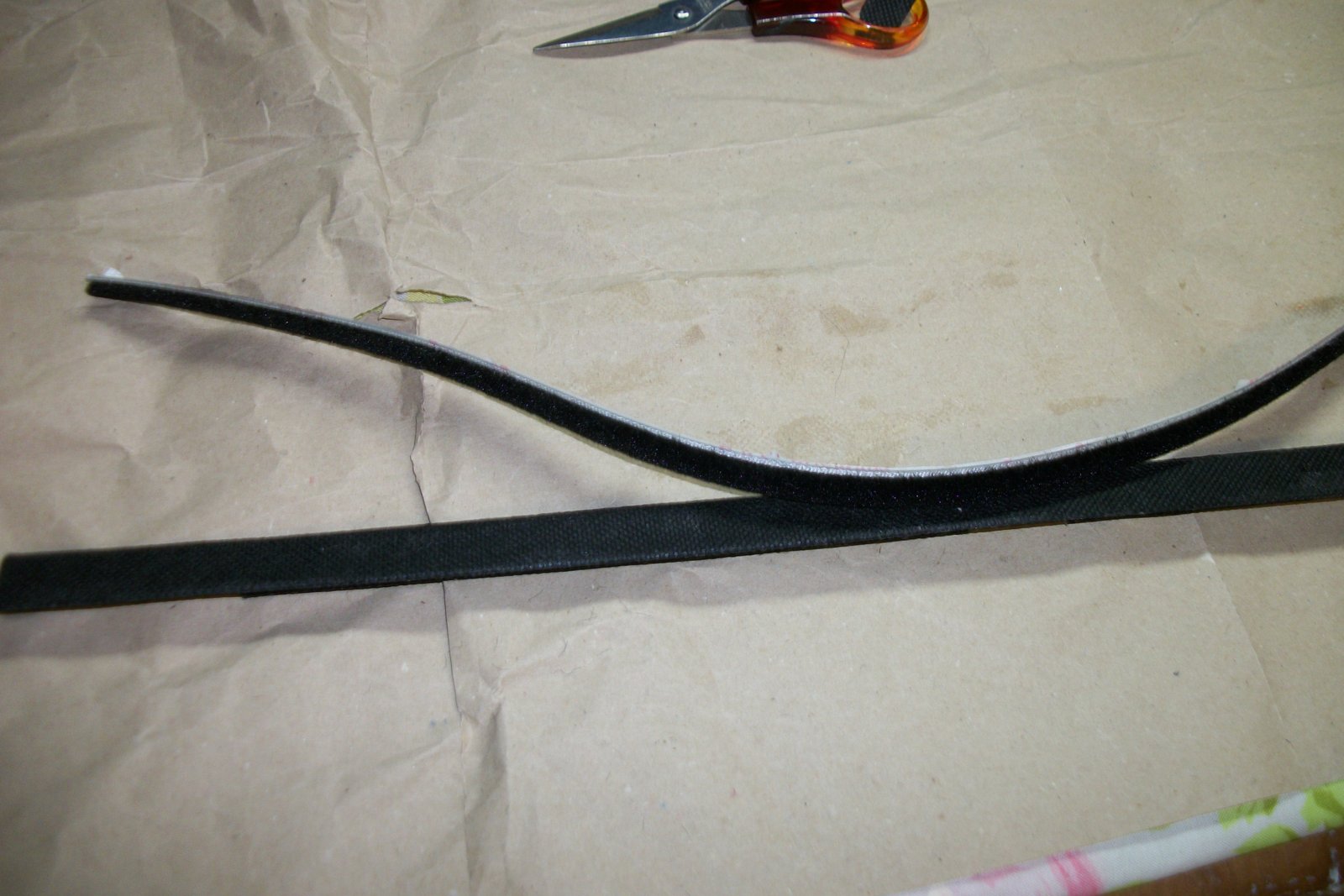

The rear window fuzzy strips are completely made as new.

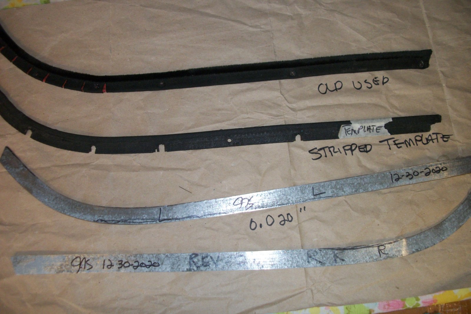

Again reference our prior (above) post about the rear window part numbers. It appears the curved sub-straight is the same for both the inner and outer strips. It just depends on which side peel and stick fuzzy strip will be applied. We took the best of the removed strips and used as a pattern. (could recover it, but ours were a bit rusted). The sub-straight is approximately .020" thick. We had some pieces of galvanized AC house ducting material laying around and it is about the same thickness. One could go to local Home AC installation companies and they would probably give you excess cutoffs. Using the old sub-straight new pieces were cut with tin snips, a bit wider than needed. Then they were trimmed on a bench belt sander to get them to match the original as close as possible. Suppose thin Aluminum could be use but don't want it to be too flexible.

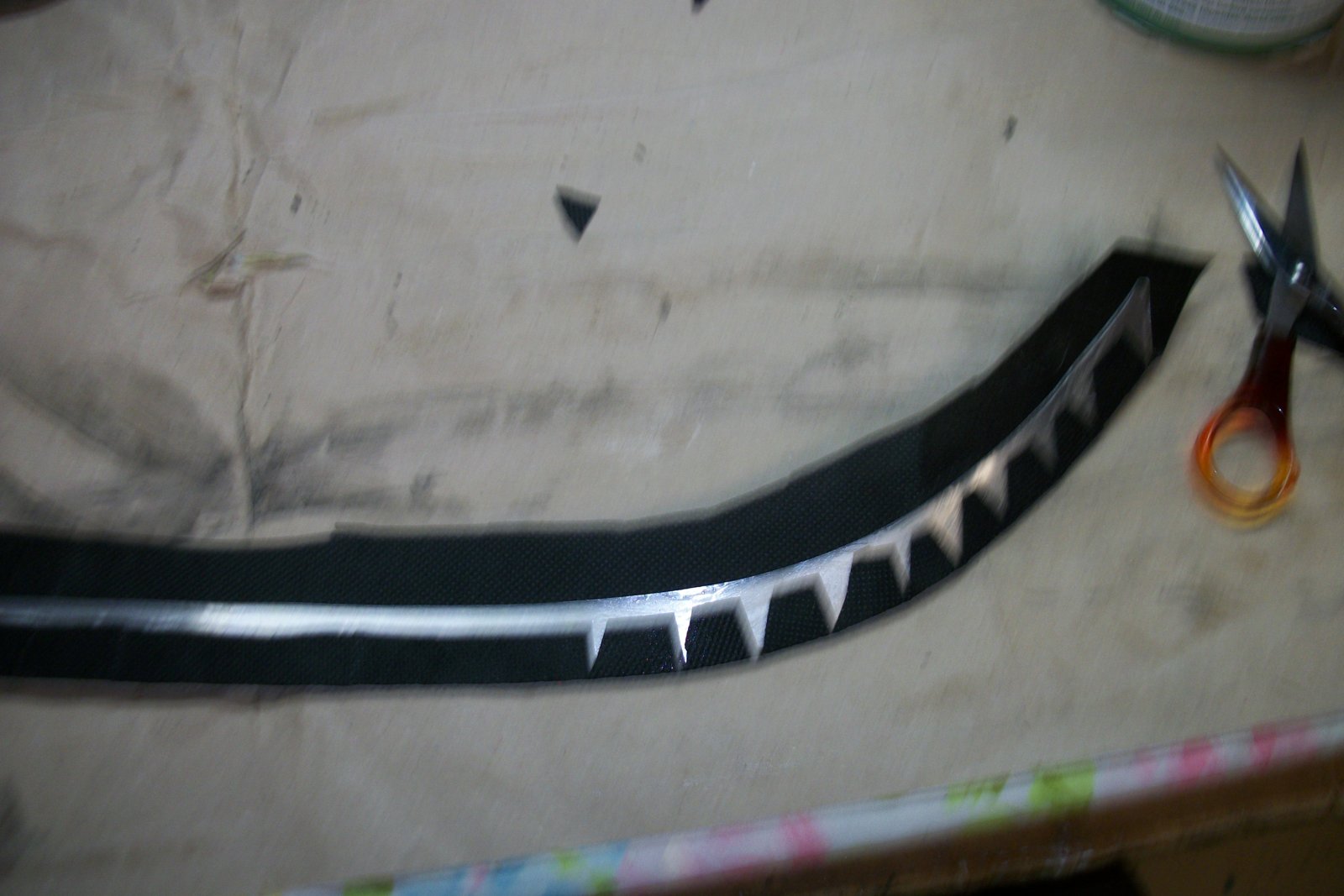

Then its just a matter of gluing the black material on the piece and peel and sticking the fuzzy strip.
The fuzzy strip will have to be snipped about 1/3 or so of the way through in places to allow it to bend to fit the curve.

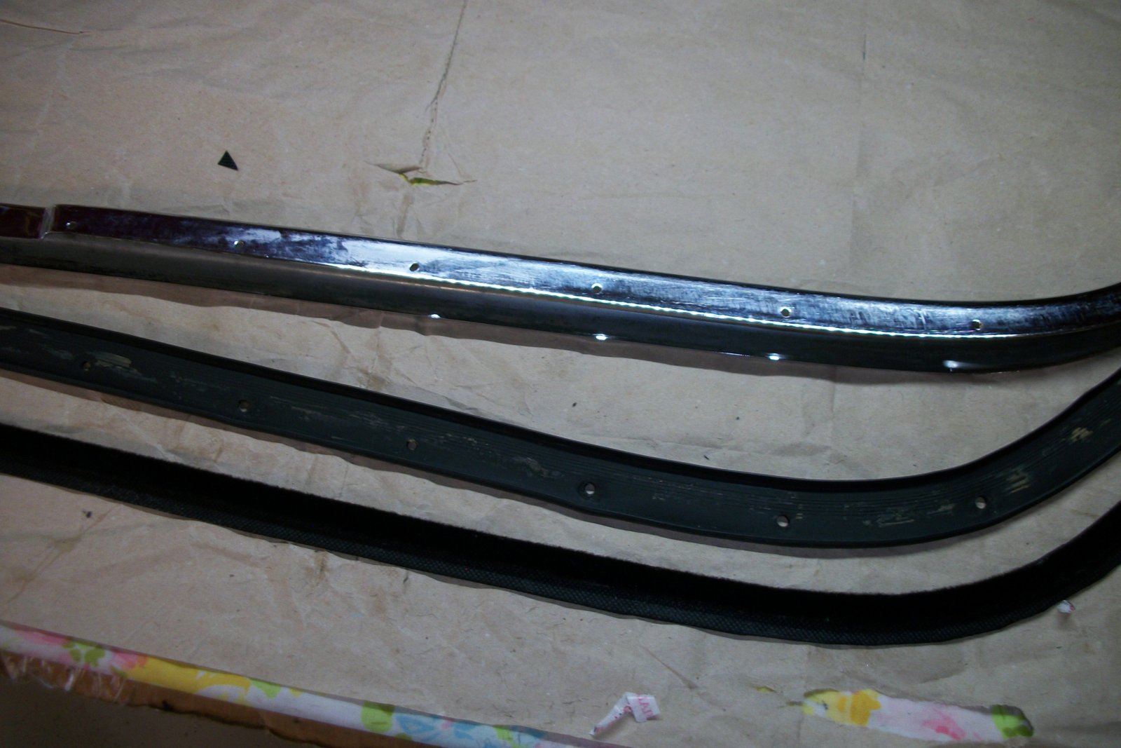

Final product that will fit into the still available outside rubber squeegee strip. The pieces fit into a similar guide on the inside. Of course holes have to be punched to fit onto the metal holders.
As mentioned, we have no assurance of how long the fuzzy strip adhesive will stay on. Looks like the originals were all molded together. But it sure seems like the adhesive is quite strong.

Excellent write up, thankyou for taking the time to do it.
Thats another job on the list to do. Thanks for the reference on the materials on Amazon as its useful to track it down to buy it or similar products.
Nice trick having the date on the glue so you know how old it is and if its worth keeping without opening the can. That'll be me now marking each item as I open them to start using them
thanks @Henrik but from the write up it looks like something I could have a stab at doing. If I mess it up I can always buy it, but I'd like to try first.
I want to try to do as much as I can, as I know some things I definitely need others who have the skills to do for me and to save time. I think its the best way I can to get to know the car and its idiosyncrasies more
Great write up. Was able to purchase the material from the same sources. Completed project yesterday. The finished product turned out great. Thanks for the help.
