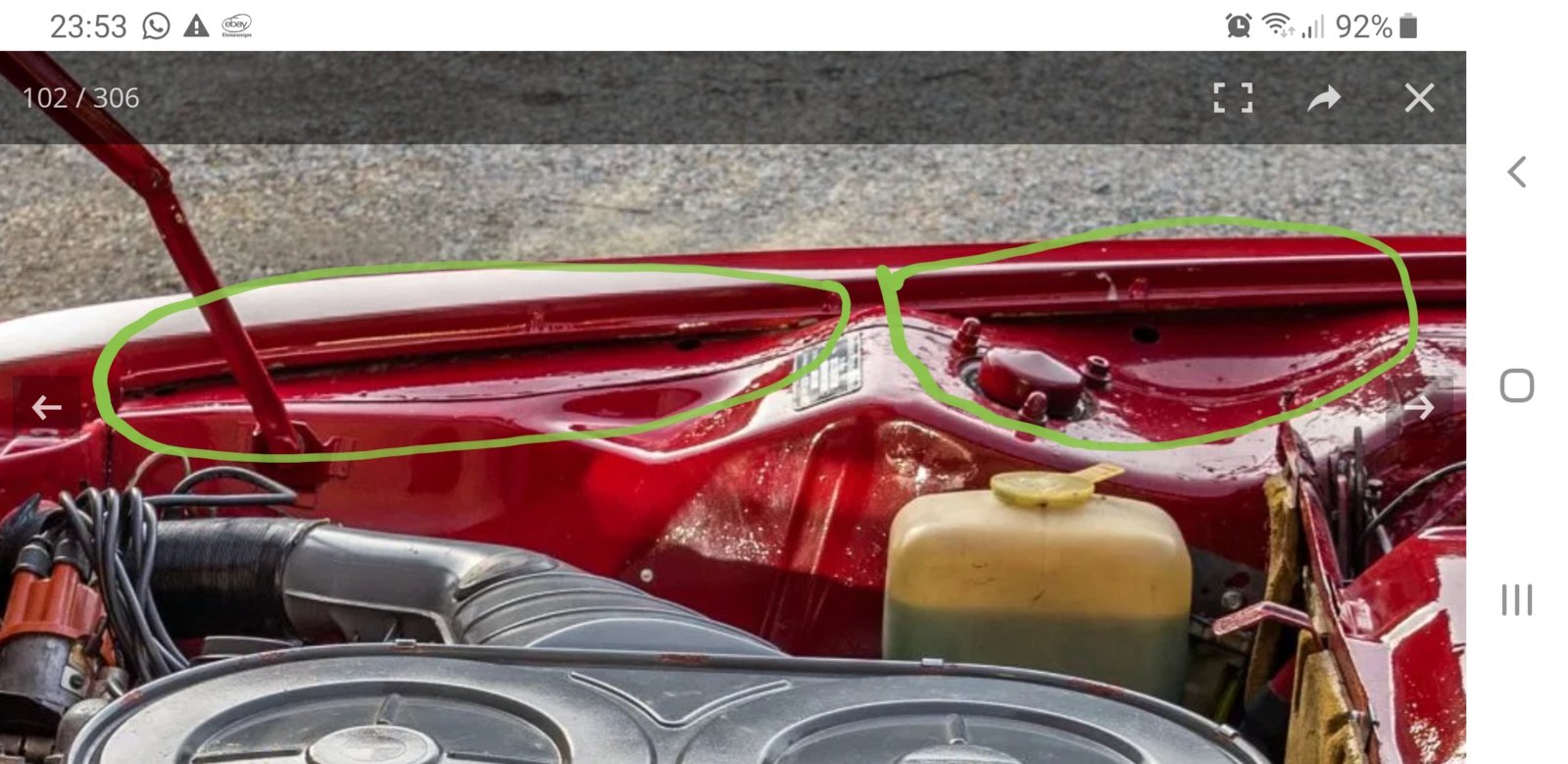

And pics 98-102 show a cavity under the fenders where it meets inner fender, very strange repair. But then again, look at the crude spare tire well.
I think you right!

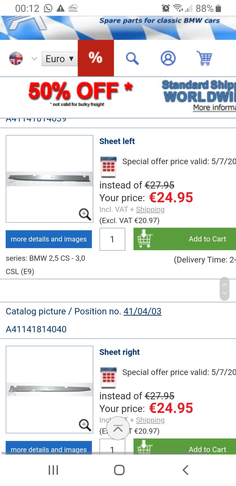

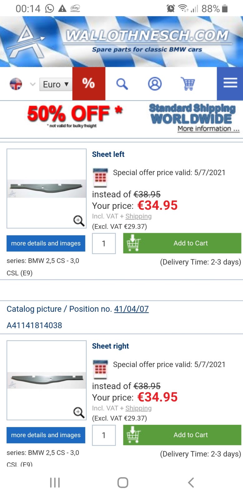

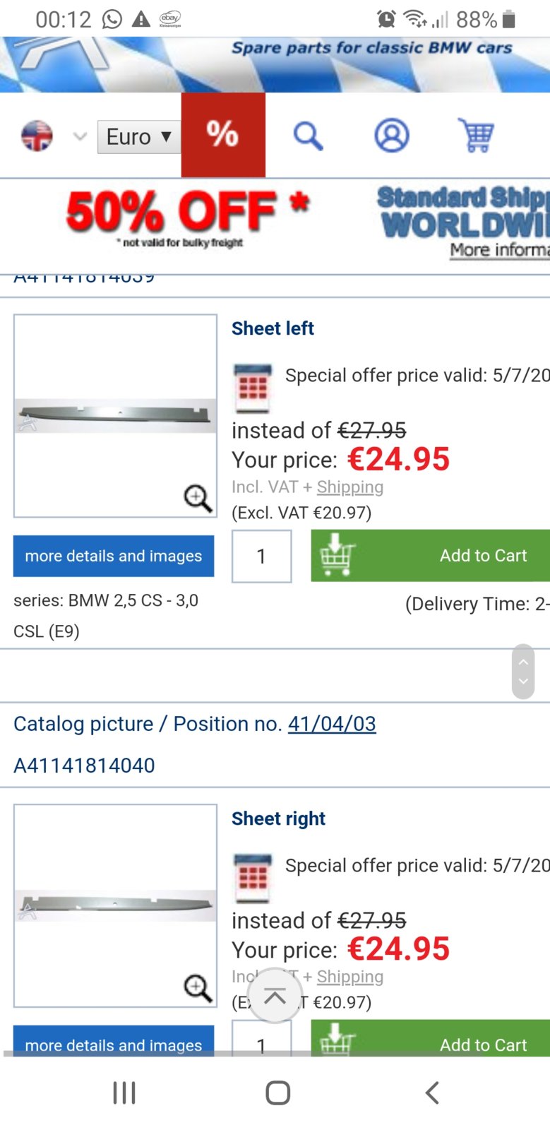

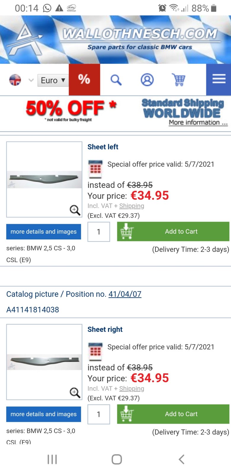

It is missing there 2 pieces that connect the tops of the inner fender to the outer fender. 2 are missing on the left fender, and 2 are missing on the right fender.
Not sure how stiff that front end is with all that metal missing....
Luckily they are on sale now at Wally, so for only 130 euro, but it'll cost you dearly if you want to weld them in!
Funny side aspect; the open cavity that we now see in those pics, is actually THE reason that out coupes rot badly in those place.
The 4 missing pieces close the cavities, adding structural rigidity, but also creating the cavern for dirt to trap, and soak up moisture.
Everything has a positive side; this solution sure kept it from happening again.
(Just to be open; my car is the same wrt this aspect :-(
Prepared by PO once like that. I had no issues driving it 20.000 km, but for sure my car is now getting the missing pieces.....)

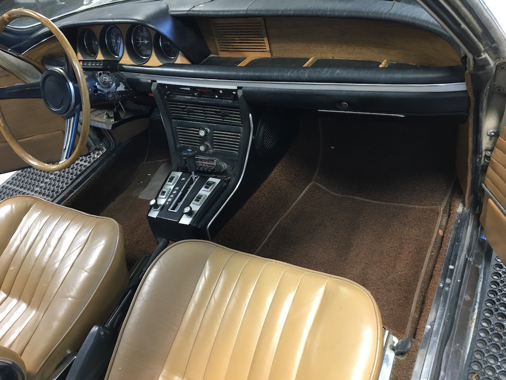

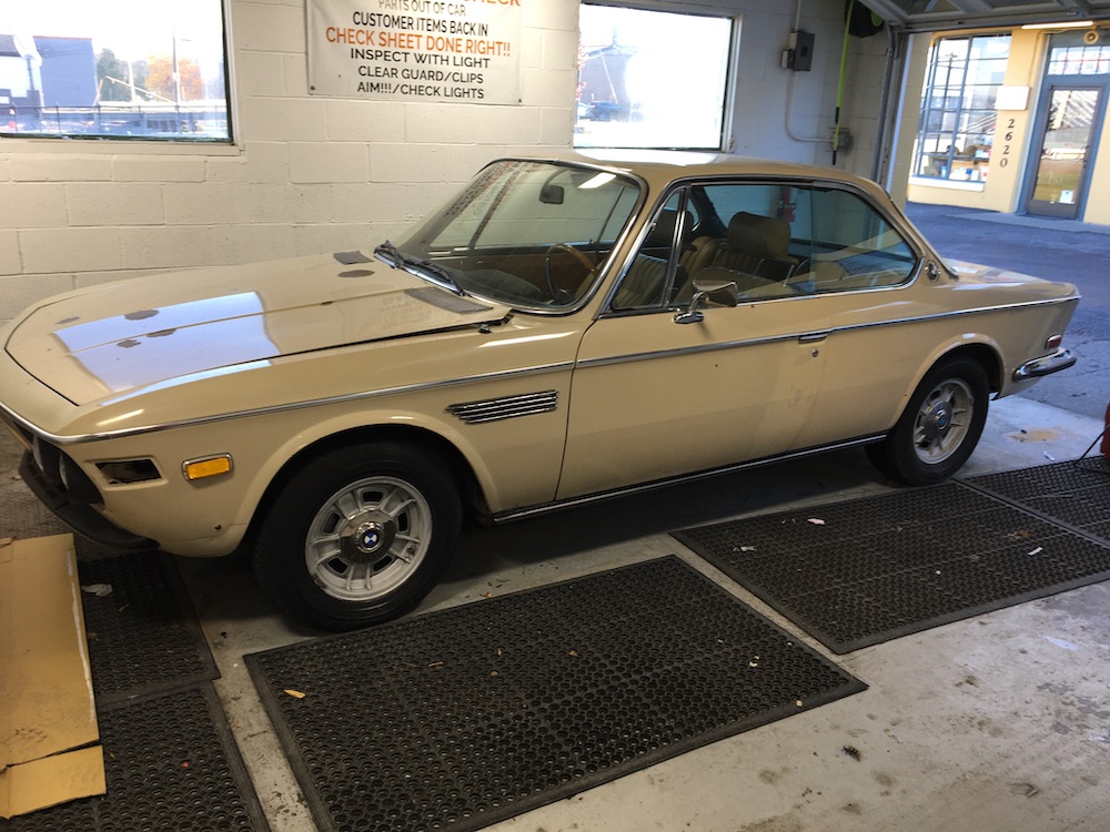

I'm no E9 expert, but I think that is all the money for that car....maybe even more. That one that was posted here that was on eBay late November/early December was in Seattle. He wanted $15k for it. I went and took a look at it. Clearly a project and clearly with some rust issues. Original paint and interior. I'd much rather have a car that wasn't messed with by someone else than one that was poorly put back together like the red car. Here's that $15k car...
I think you'd have to start over on the red car for any peace of mind. On one like the above car, you could just do it right the first time.
