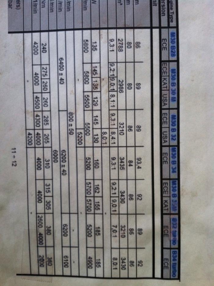

BMW M90 redline spec is 6200 rpm +/_ 40, constant speed limit 6000 rpm The M88, on the same bottom end has a 6900rpm redline, 6500 constant speed. I've just started my M90 build.
Dead on Ian!
M30b34 ECE version
