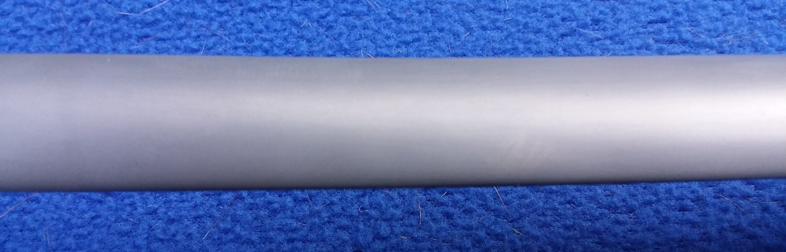

This is what my 48 yo trim looked like.

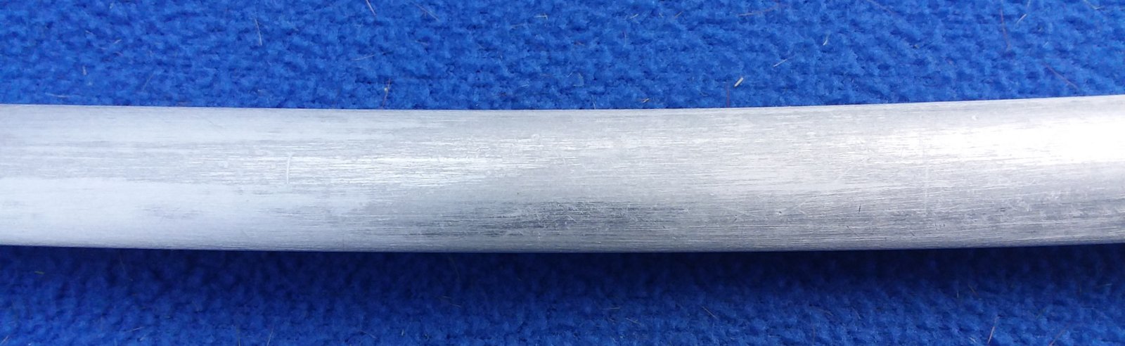

I tried oven cleaner to remove the anodize, with little or no luck. I ended up using 220 wet sandpaper & lots of elbow grease. Work on a small area, cleaning frequently (I kept a bucket of soapy water nearby to rinse the sandpaper & a rag to wipe the piece). I wrapped the sandpaper around a foam block for most of it, but found a bit of the 220 with a popsicle stick worked better on some areas.
Starting to get through the anodize layer (this is the hard part).

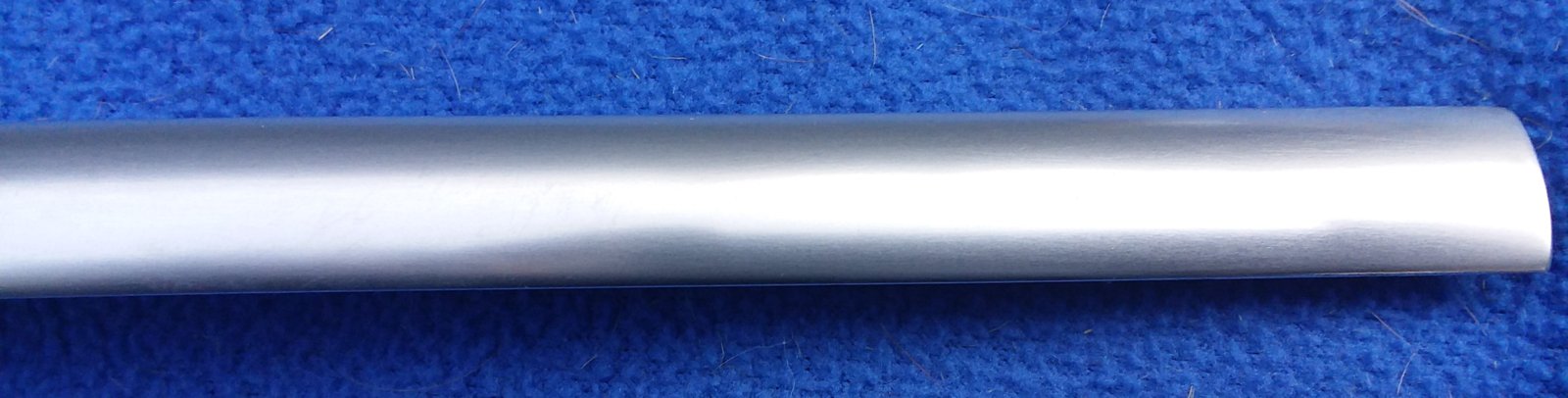

All of the anodize layer is removed.
I then went to 400 & 1500
I had some abrasives that went as high as 12000, so I used them, but really think that is not necessary.

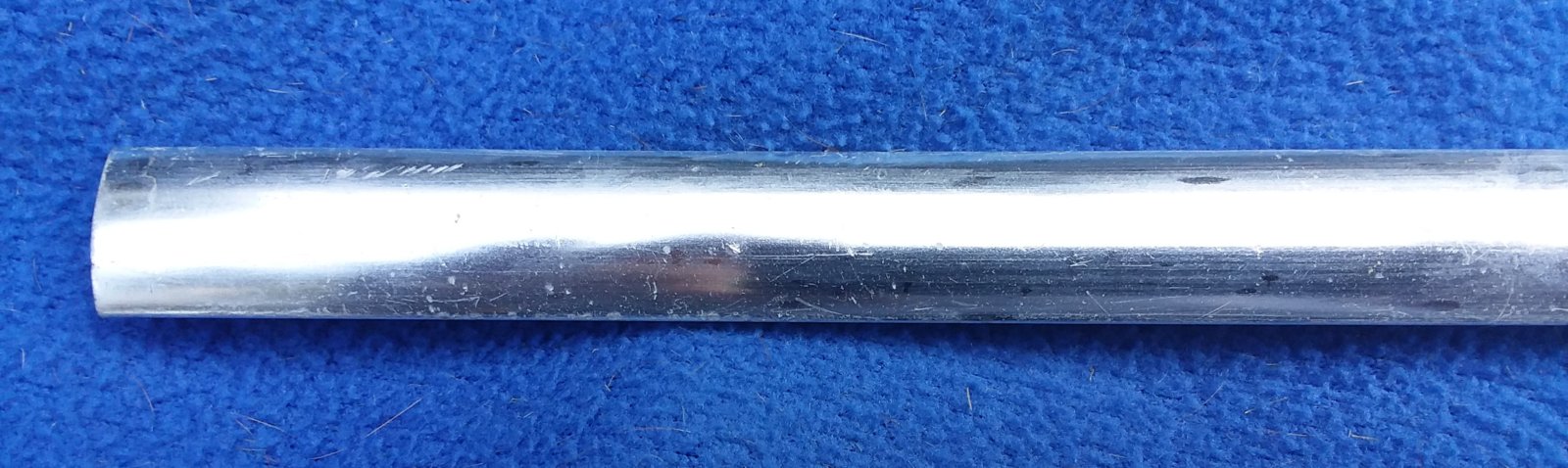

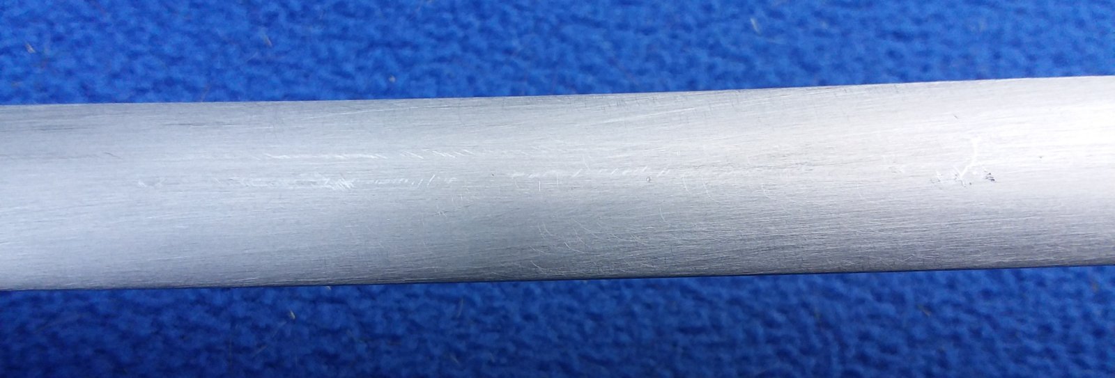

I then used Eagle One's "Never Dull" wadding polish and Mother's Mag & Aluminum polish to finish it off.
The last step will be to have them re-anodized.
