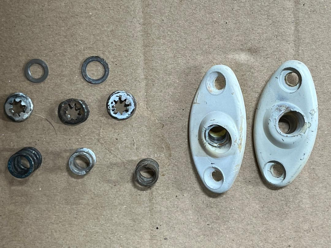

they aren't very visible until the visor is down - i had a 3rd visor in need of repair. the part that is visible is the gnarly part with the curved metal
these are the springs + clips that were a PITA to remove - i see one of the washers stuck in the housing mount. interesting that the 2 springs that were in the mounts were shorter than the one that was in the trashed visor that didn't have a mount.

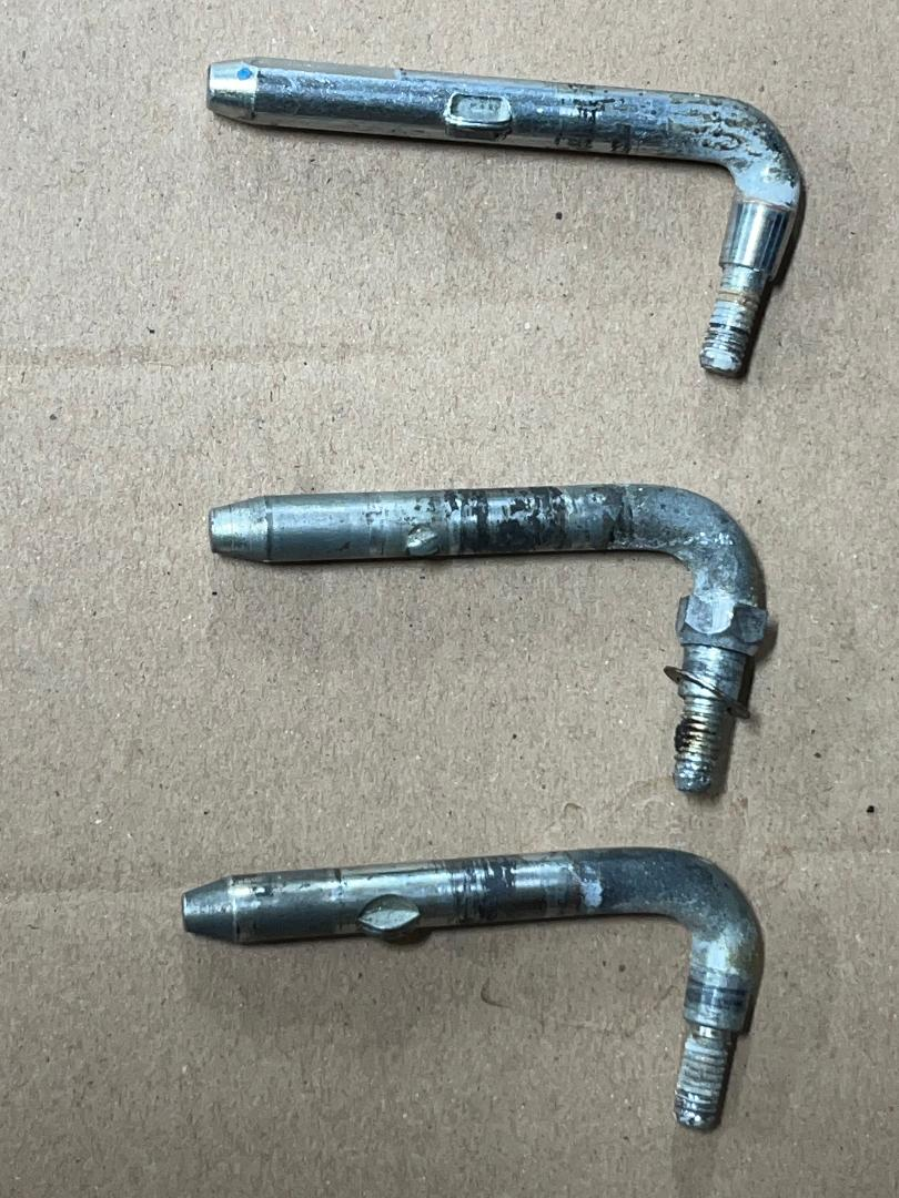

Can the chromed L shaped pieces be removed from the sunvisors without opening the vinyl ? Do they simply slide out in some way?
( I'm asking something while fearing the "while you're in there" effect)
absolutely Erik, you take out a single screw, turn the L shaped piece parallel to the width of the visor and it should gently pull out. there is a single flange on the arm and that has to lineup for it to come out. just move it around a little bit and then it just pops out.
