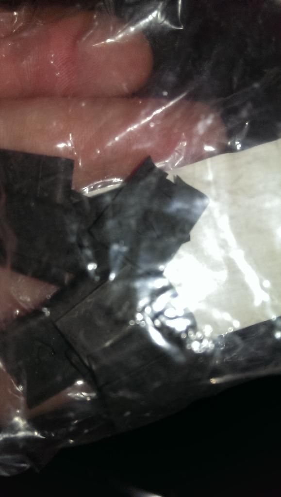

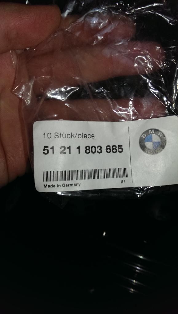

I thought I bought the correct fixings for this job, do they attach to the car door and then the trim slides onto them ? They won't sit tight in the trims but I guess might when expanded by the door sheet metal.
deQuincey
Quousque tandem...?
8,437
2,460
yes they are the right clamps to fix the chrome rail to the top of the door
as here,
http://www.e9coupe.com/forum/showthread.php?t=13485&page=5
to be honest i do not remember if i placed them (only a bit) in the door upper lip, or completely into the chromed rail,
then place the rail over the door upper lip and tap evenly all of them into final position
hope another member can chime in and comment

Ill ry putting them on the door first as they are too loose in the chromed trim.
