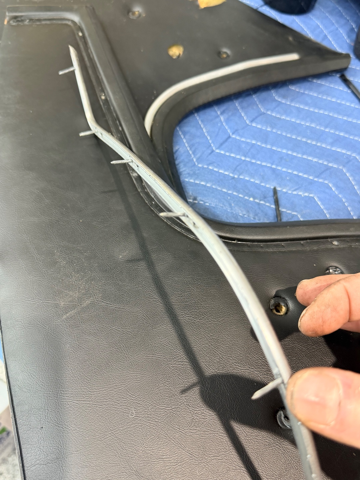

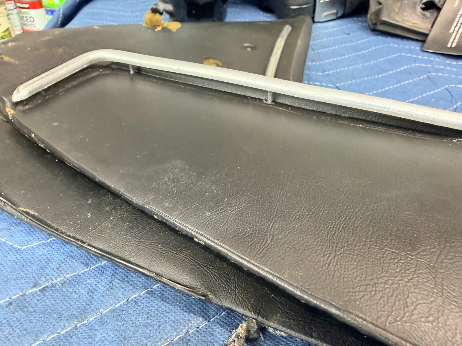

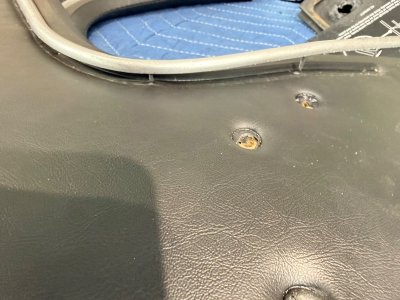

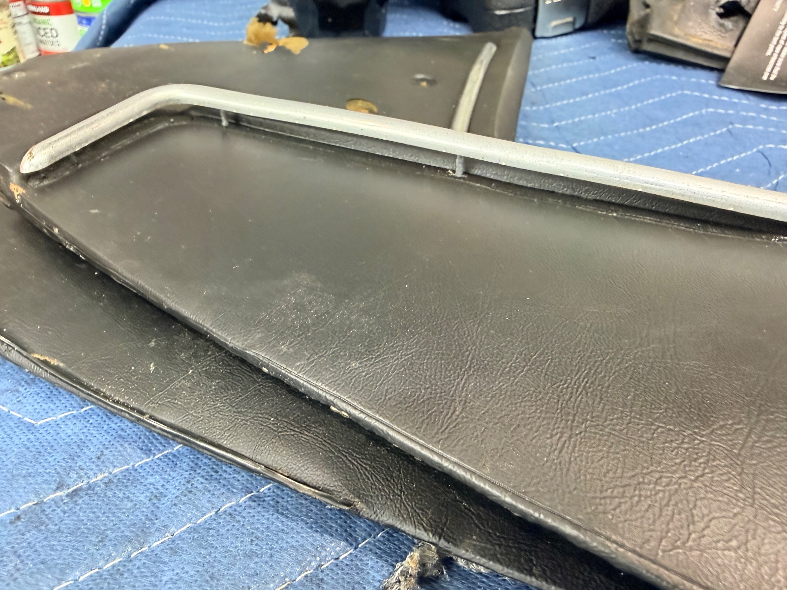

How does one remove the 'chrome' trim on the sides of the center console?
Any tricks to not bending it?
Posting a picture since I just did this today. Use a small screwdriver and start at the end that’s tucked up high under the dash, then pry it down towards the front.
