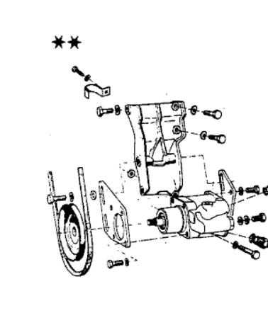

The power steering pump mounts via two steel brackets (one in front and the other behind) shown on the diagram & picture below. To loosen the pump you need to loosen the four bolts that are in the slotted position which fasten to the aluminum mounting bracket.
The alternator bolts you need to loosen are top and bottom. You may have a slightly bent mounting bracket (or just stuck from age) which could prevent movement.
