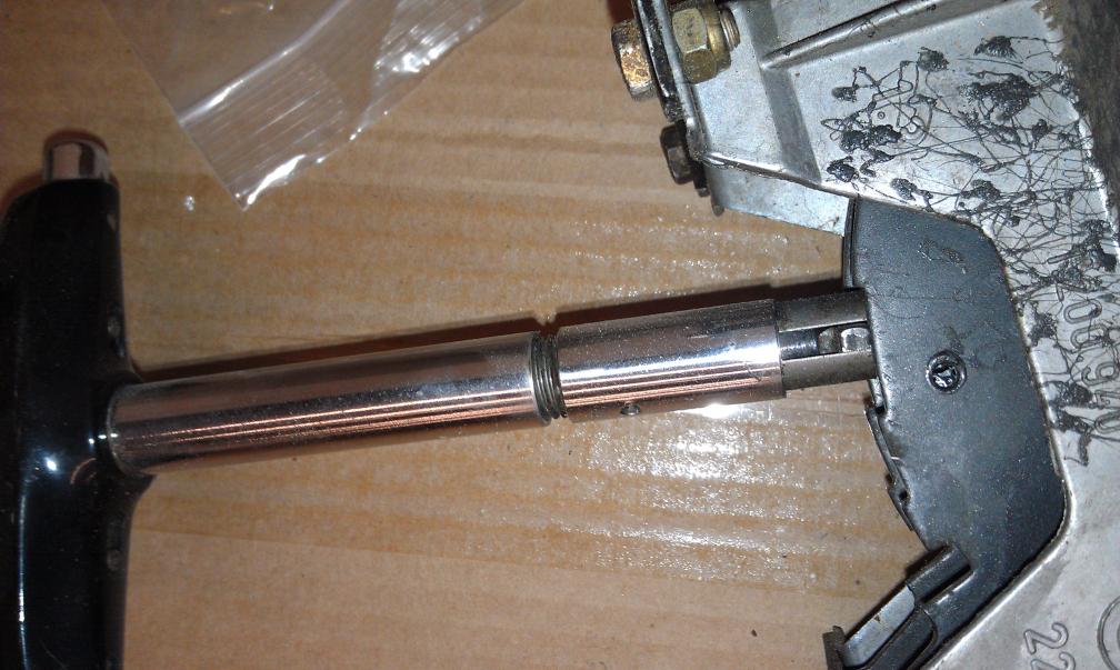

Can anyone advise me how to remove the upper part of my '74 auto gear lever?
So that I can remove my console section.
FYI, it is the T-bar version not the gated version shown in the repair manual.
Thanks (in anticipation)
Carl
From the pictures below you just need to grab the T and turn it to the left.
Thanks Peter - Worked perfectly !
Took a few tries to put it back again. Inside tube is also threaded and also has to line up or you can't get the lockout to release.
Thanks again
