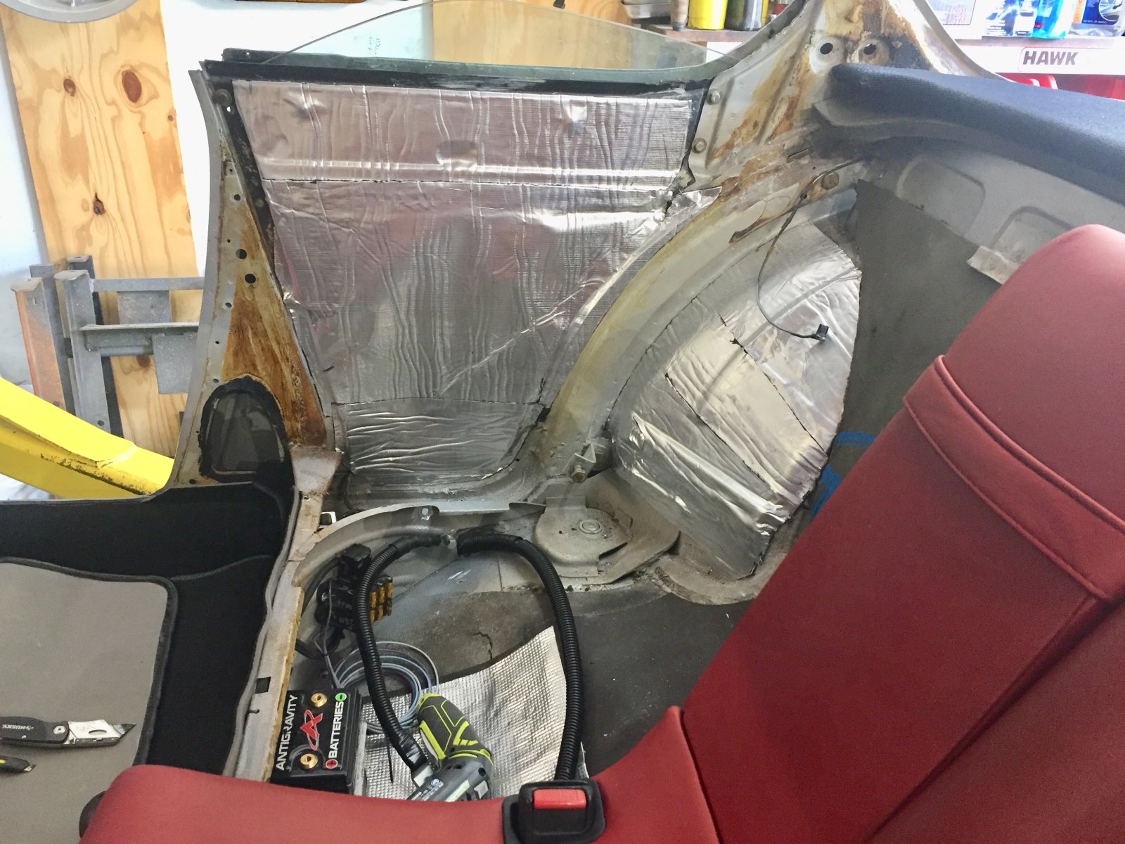

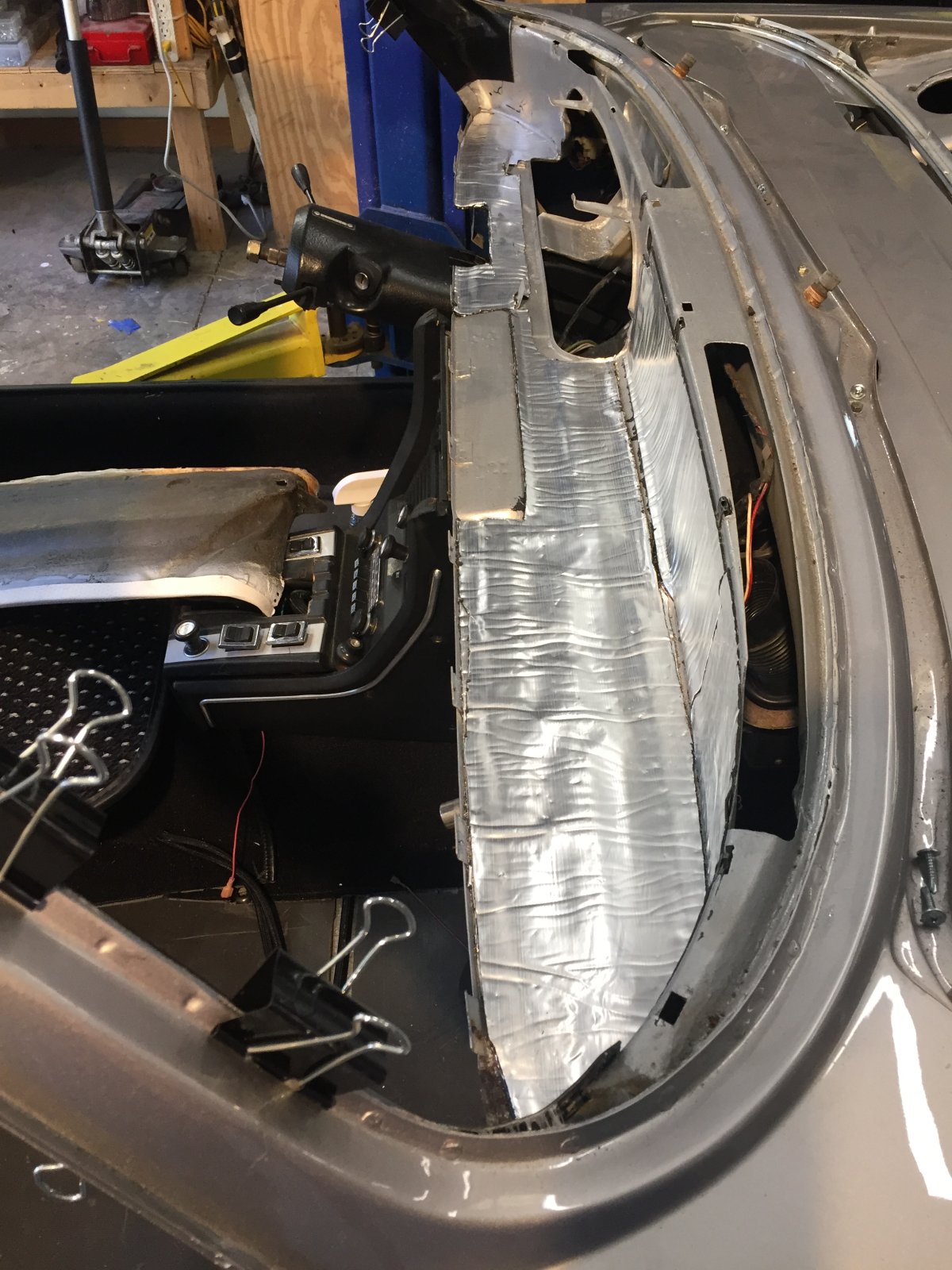

Alternately, I have a product I’ve been using under the hood and in the interior called b-quiet that comes in a roll sheet.

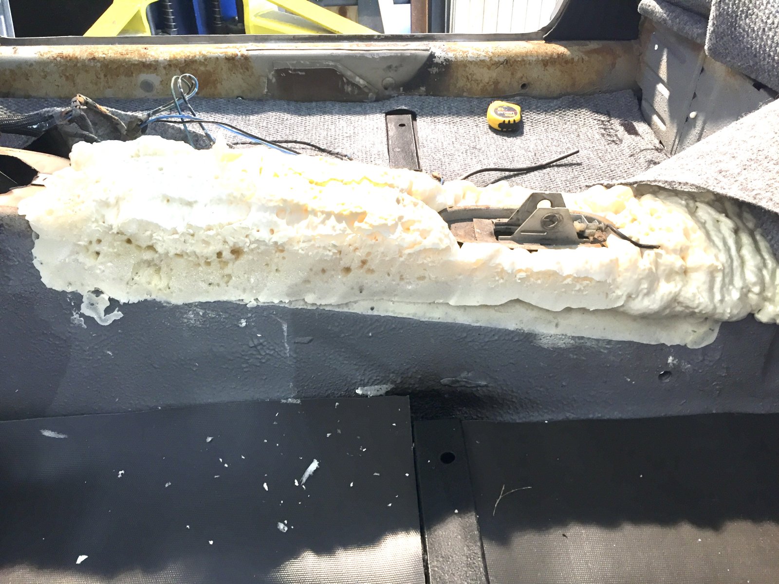

Don’t forget to use some expanding foam to smooth out that awkward hump in the transmission tunnel. The carpet lays down much easier.
