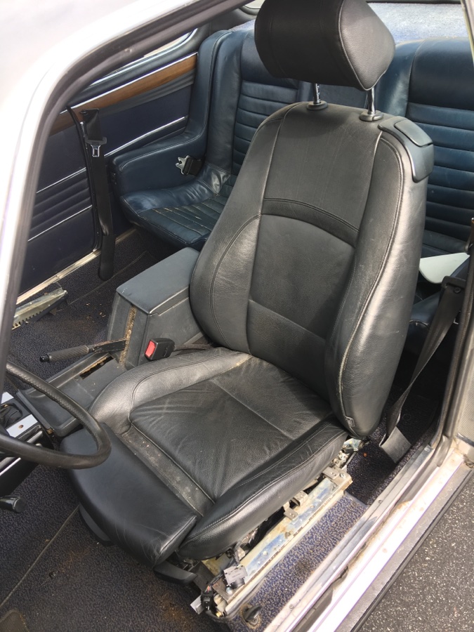

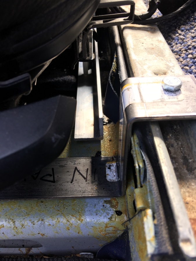

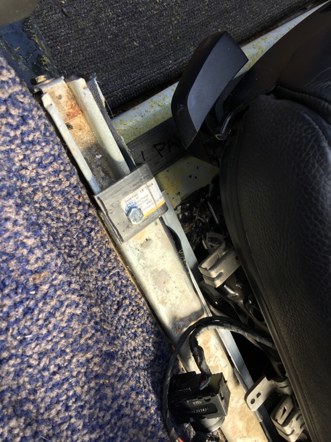

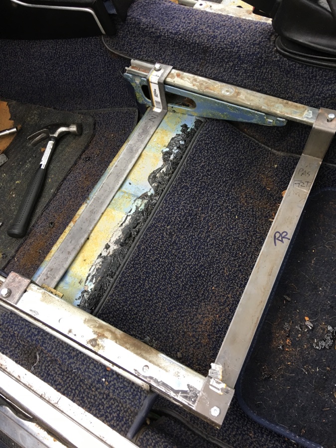

Has anyone tried removing the seat from the tracks and fabricating a bracket between the stock e9 tracks? This would essentially be a manual seat for position and wire it for the back only. I took an e90 seat off the tracks last month to access a seatbelt and they sit several inches above the tracks. The motor is mounted between the tracks for forward and back movement.

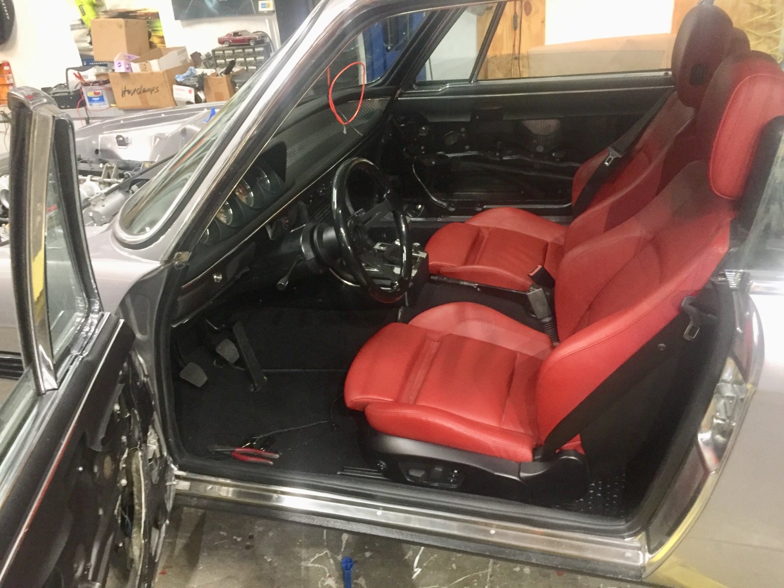

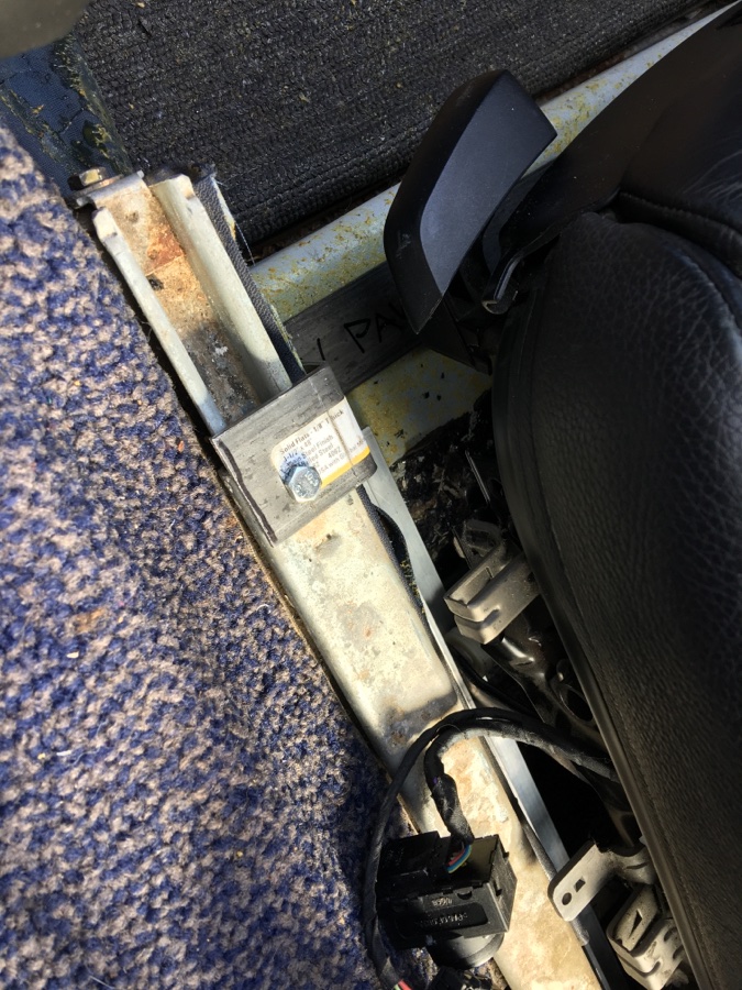

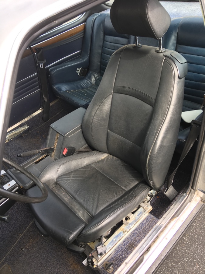

Took a while longer than I thought, as usual, and there is lots of finishing work to be done, but here is basically what I came up with:
The e92 seat is the best compromise between style that is similar to original e9, multiple adjustments and comfort. It is a coupe seat so it folds properly for rear seat access and uses the original seatbelt system (in my case, a '74 with the shoulder belt anchored near the rear parcel shelf). Now I need to dye the leather to match the rest of the car and do lots of clean up and hiding. But it is completely reversible since I am using the original seat rails and no mod needs to be done to the car itself.
As explained earlier in the thread the main challenge is to install the seat as low as possible because those modern seats sit way too high on the e9 seat "perches"
The end result for me is a seat that is far more comfortable for long distances. But, again, as stated earlier, that is entirely a personal thing. Many are perfectly comfortable in the stock seat.

View attachment 63902 View attachment 63904 View attachment 63905 View attachment 63906
Bo -- In looking at your last picture, I have a question. Have you come up with something to cover the adapter that mounts your seat to the car? I have a set of period correct Koenig seats (that I bought from Gary Knox) in my car, and I would like to come up with a way to cover the adapter and the mounting hardware.
Chris, nice work on your seat.
No I have not gotten to the cosmetics part yet. I still have to do some modifications to get the front tilt as well as the lower back and side bolsters adjustments to work properly.

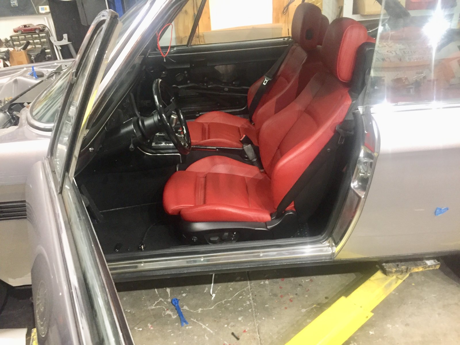

Carpet is almost ready. Thanks to those on this board for the information on how to install e24 rear seats . Done.
I will install the E93 front seats soon.
Then it will be time to learn how to post pictures....It is a very nice bright read leather color.
