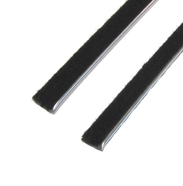

Another option. I went to the Steele website and found https://www.steelerubber.com/beltline-weatherstrip-70-0555-58. Slightly narrower (9/16th) than I wanted but works well. I recovered the original brush steel frame with black mohair that I had left over from redoing my seats and left room to mount this. Sorry for the lousy image.

Drew, I saved the metal substrate (see image #1) of the original brush to which I glued 70-0555-58 to the front of( see image #2). The rubber that is in front that you refer to, basically a sweeper for the outside of the window, is available from W&N and that is where I got mine.

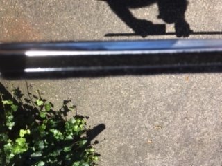

Can someone tell me if the entire unit=sweep/brush/chrome is held onto the car door with clips or just pushed on. My car came with both of these off, no clips. no clip marks. What are those cut outs (red circle image #1) from the original substrate the OEM brush was on, for a Clip?
One more question. The W&N rubber sweep extends beyond the door window ( ends where the brush ends in #3) and partially across the vent window . Roger S. sent me image #4 and his is cut at the window's edge (blue arrow) and then resumes along the base of the vent window (red arrow), gap is where the vertical part of the vent window is. Which is it?

Rob, Chris, I have done an almost thorough search for part #'s 9,10,11,12 on page 41/14. Replies from the parts dept at my local BMW shop, Coupe King, Korman, and Carl Nelson and W&N found this: # 10 is a clip that holds everything together--10 per side. I bought that from W&N. #12 is rubber available from W&N. I bought that also and took both items to the restoration shop this morning. #11 is that brush that's NLA from every source above. #9 is the rubber under the wing window that is also NLA form all sources. Carl Nelson is fabricating #9 from inner tube rubber per his email reply to me.

The #11 brush will be the Steele rubber alternative on my car. The restoration shop showed me the same type of felt-lined material they have accumulated from past restorations.

Just checked. The rubber sweep from W&N is 4.5 inches longer than needed. The distance from the red arrow in my picture above, to the gasket of the vent window is 4.5 inches. So Chris, I think W&N may supply both as one part ( the NLA part you refer to) but it comes as one piece. It is tight, but it does fit between the chrome trim piece and the vent window....................

The rubber sweep is sold by the meter, 27” needed by the window. The 10” piece under the vent window is narrower as it doesn’t have to reach far like the door glass. The brush is held by those clips under/below the rubber sweep as it makes contact to the glass. Same as in a 2002 except that is a one piece affair for the entire sweep.

the picture quality is to small and very bad cant see a thing what do you use to take a picture
