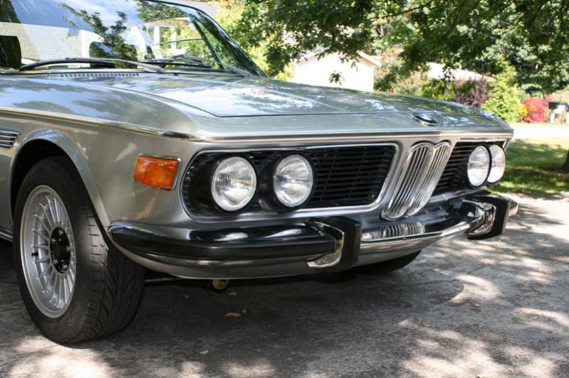

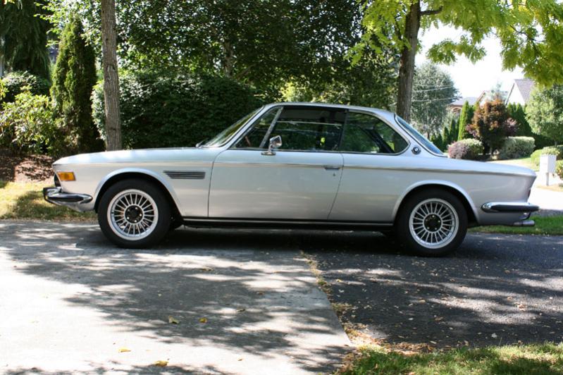

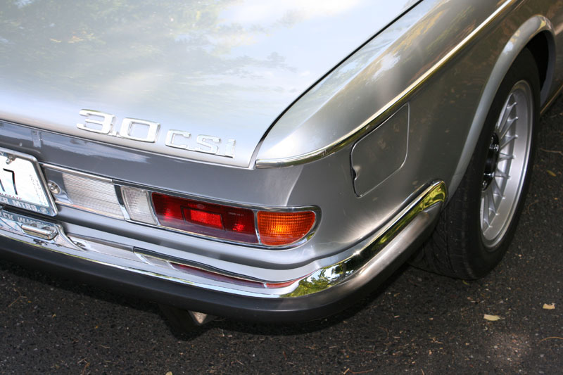

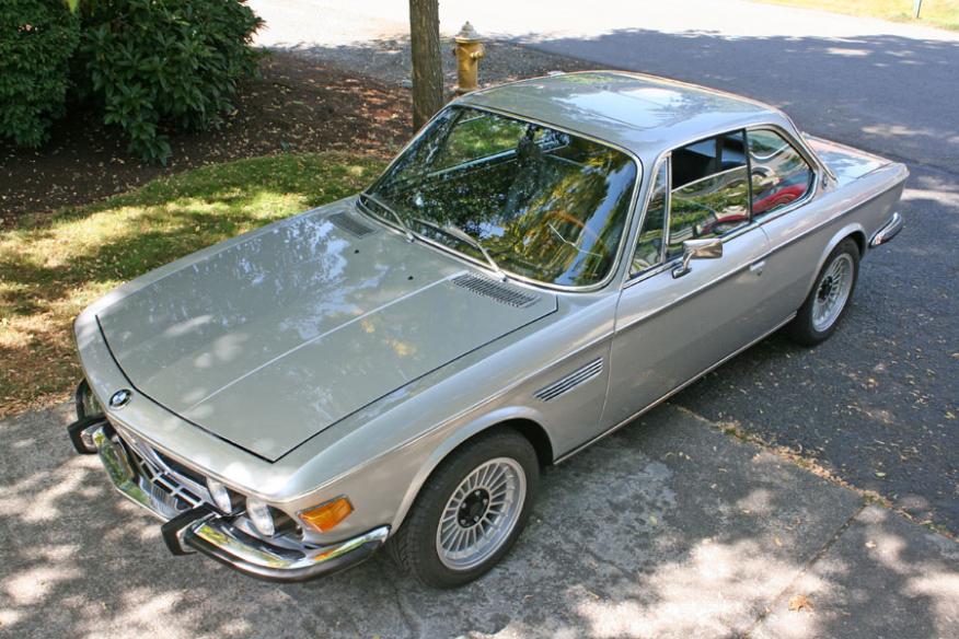

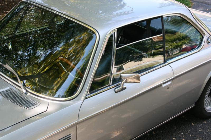

Finally after almost 3 years the car is finished (mostly). There are still a few loose ends for this winter: engine tuning, seat leather, and some minor fitting issues at the doors. I have got about 500 miles on the new engine and have been working out the EFI bugs. It feels great to finally to be able to drive it with the little bit of summer we have left.
Here are some photos. Unfortunately, the file sizes are a bit limited when posting directly on the forum. I will eventually get them on my restoration website for better viewing.
