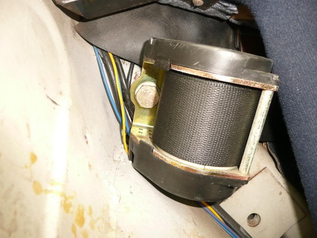

i bought a set like this, although not this exact one, and it works great - i did have to modify the mechanism, as was meant to be mounted vertically, but this just involved removing a ball-bearing that dropped into a lock/slot when not vertical.
my car is a 74 so the mounting hole was there, but if not, would be easy to weld in a nut.

I have upgraded my 2800cs with the same seat belts. I was told they are the only set still available from the dealer. They were not cheap. I crafted the following seat belt holder so the belt would always be in the same place in use or not. So far have worked out well...

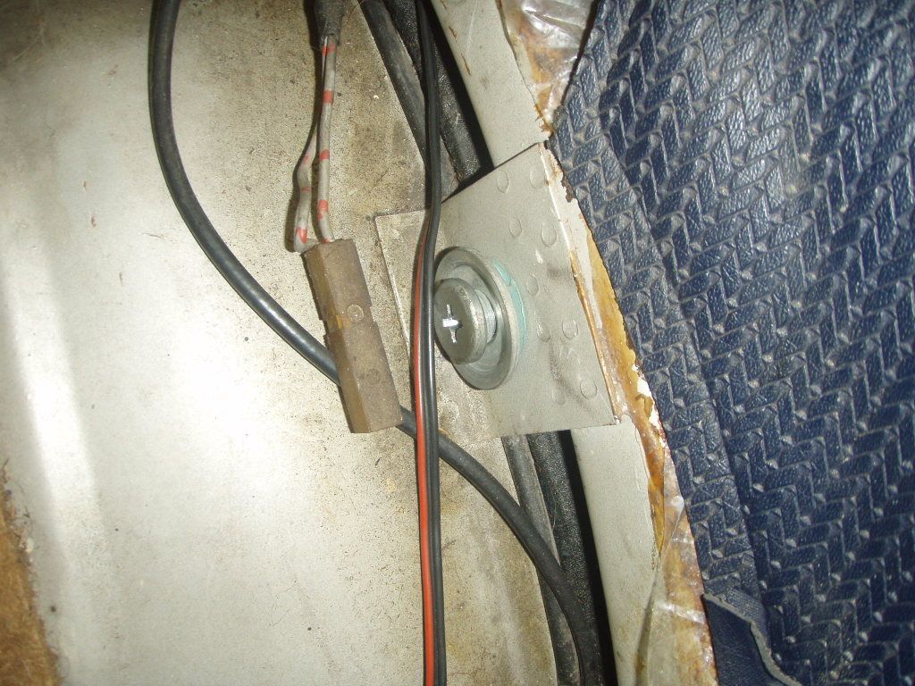

This is what the seatbeat bolt looks like on mine. It's a '72. Has this been modified?
Ding ding ding ding! I think we have a winner!
No, that is original. The 74 seat belts mount to threaded plates above this, don't have photo showing them, but this pic should give an indication where they should be at. The upper mounting holes on my 72 coupe don't indicate that these mounts have been added as they look original and unmolested. Believe these lower mounts were used for an earlier seat belt setup (non- retractable) of some sort.
