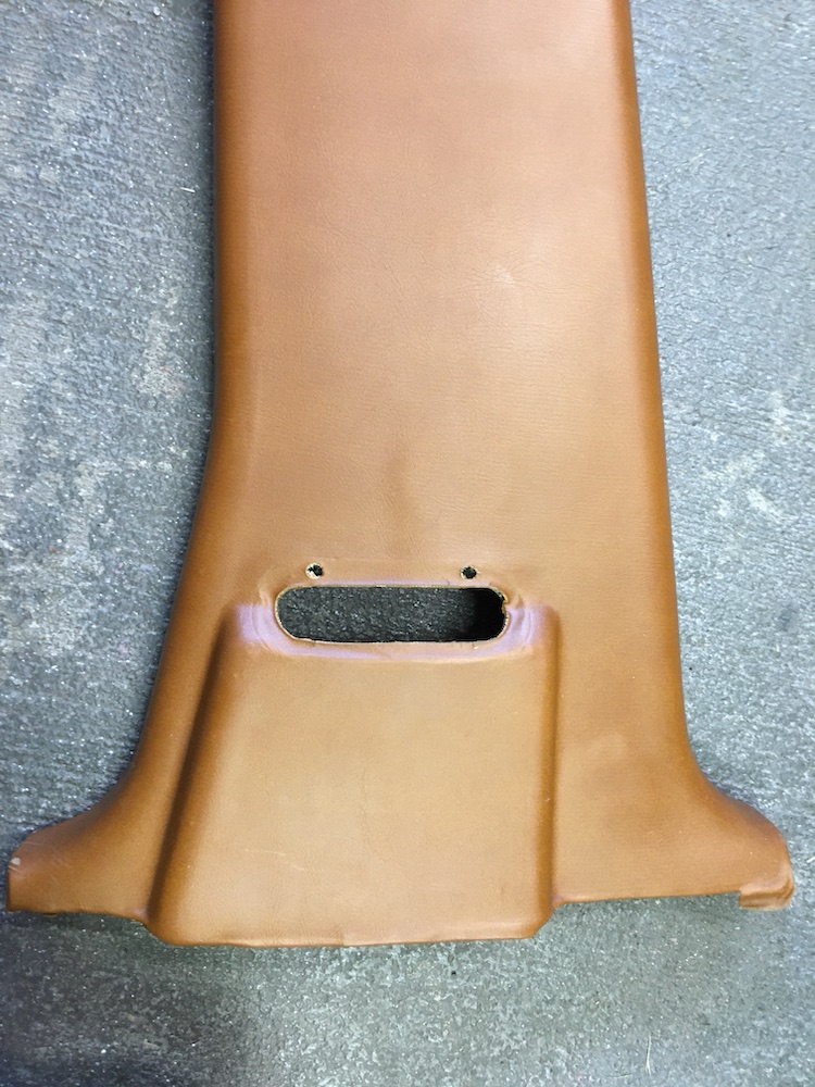

My car came to me with both the original non retractable and aftermarket retractable. I installed the aftermarket retractable. My base unit (roller) does not fit behind the B pillar cover...
If you don't have this kind of cover, or would be satisfied with ones like mine, I can get you pictures, measurements and maybe even a PN. They are generic, off the shelf models.

It takes too much to modify an e3 to fit the retractor behind that cover, I have a set of blue covers with that slot if anyone is interested. Our retractor is mounted far enough back of the seat on the rocker to not interfere.

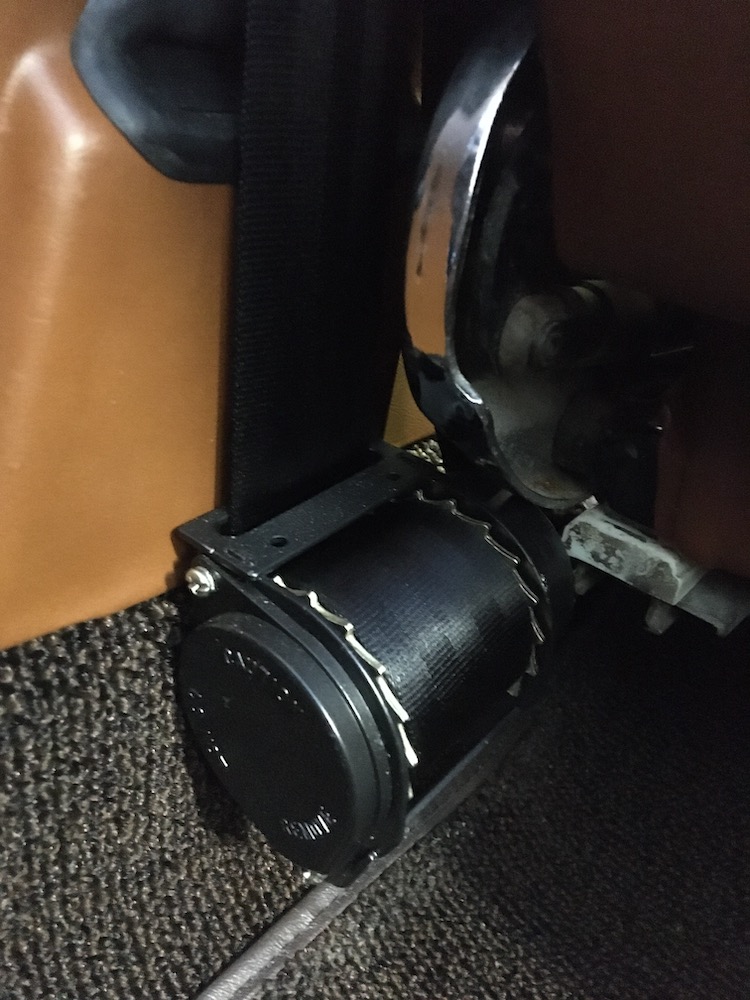

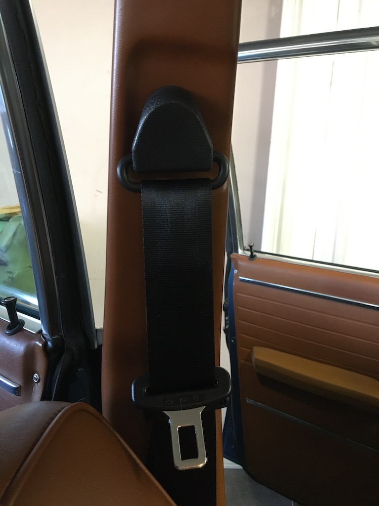

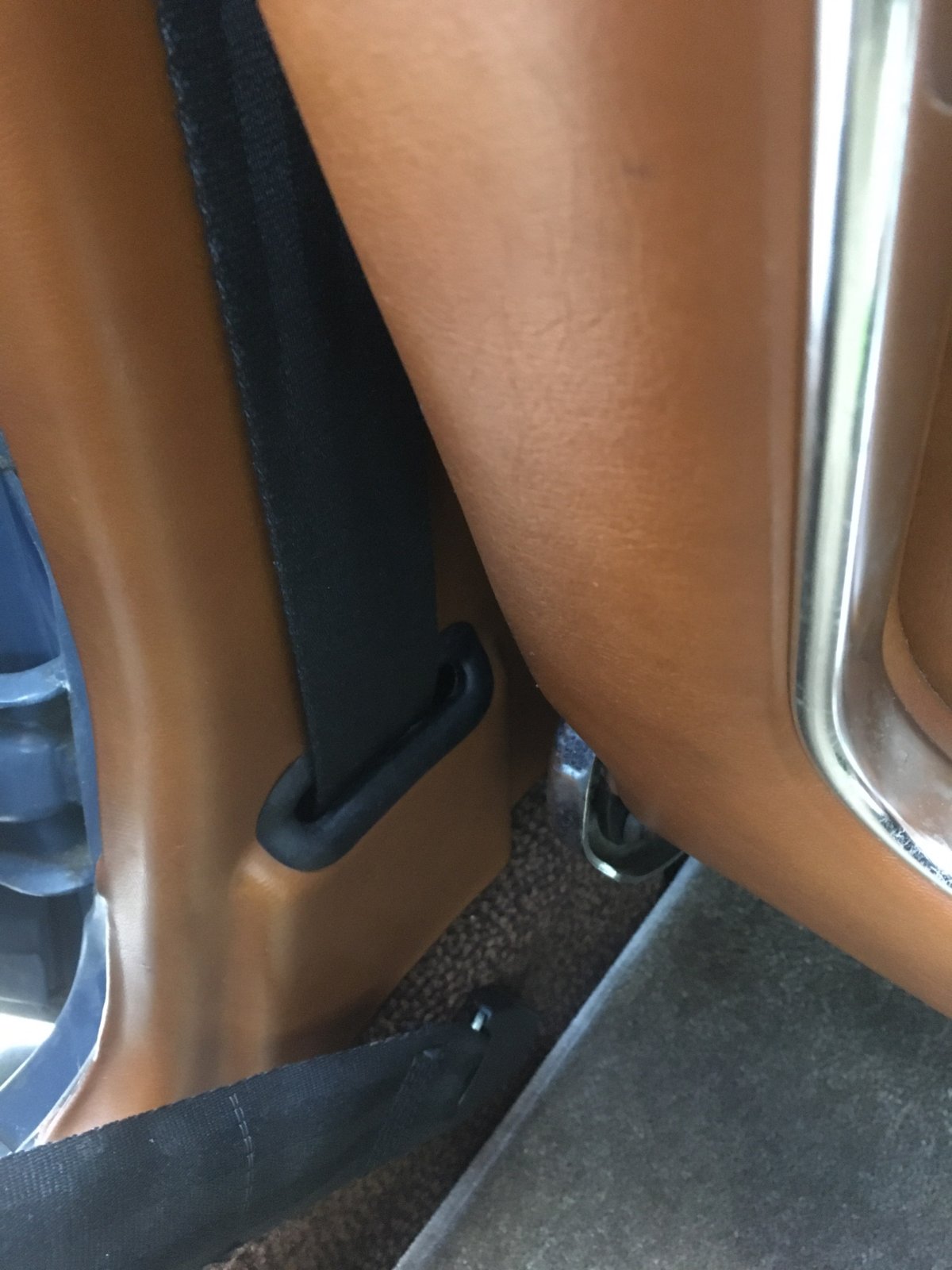

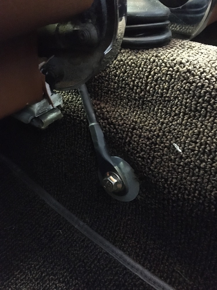

Here are mine installed...
The inboard cable ends replace the chrome "hoop" of the non retractables in the same holes
Note there are plugs in the holes in the B pillar cover...not grommets. This tells me the original non retractables did not install under the B pillar cover but rather in the same threaded holes I used for the inertial retractors.

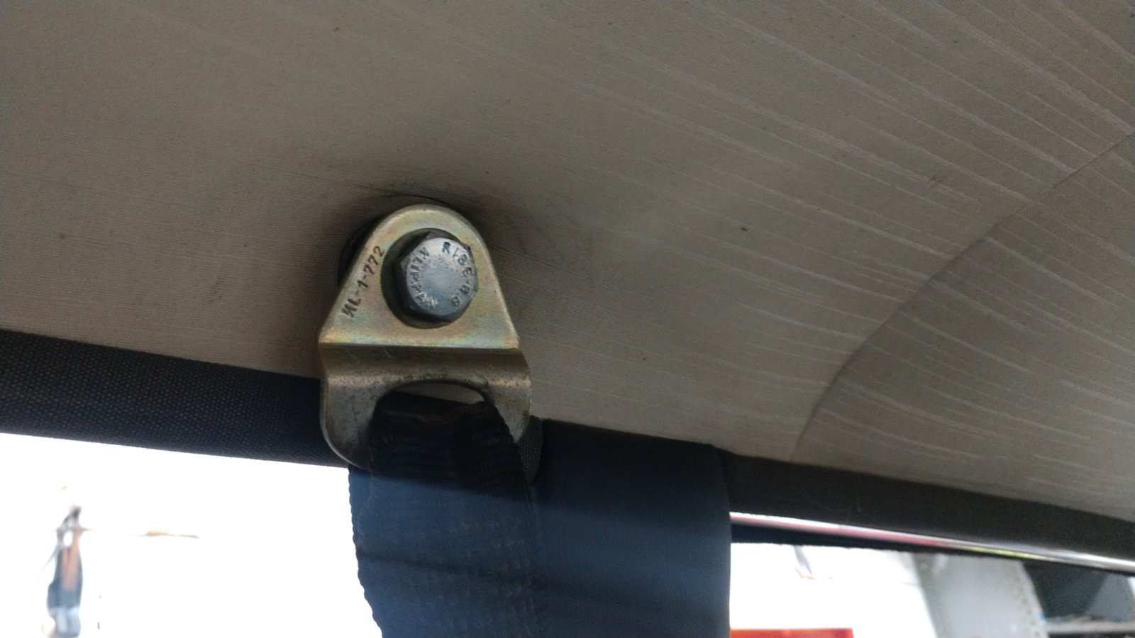

The upper mount uses the current threaded hole in the B pillar and corresponding hole in the B pillar cover.
The retractors do not hit the seat in the rearmost position.
The belt is approximately 125" long.
I couldn't find a PN or manufacturer on mine, but they look exactly like these...
I'm sure there are lots of companies selling similar.

Dick, Yes, plugs and mounts are there. It wasn’t until later that the e3 got the internally mounted retractors, maybe all had them, but fixed belts had the rocker mount.

My belts are a little longer than 125 but the shoulder mount is next to the roof and not on the B pillar. I think the recepticle should be around 12" long. I'll see how they work out.
