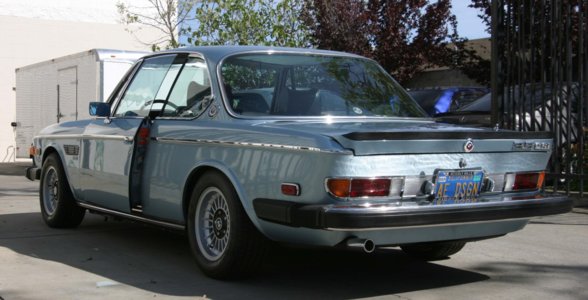

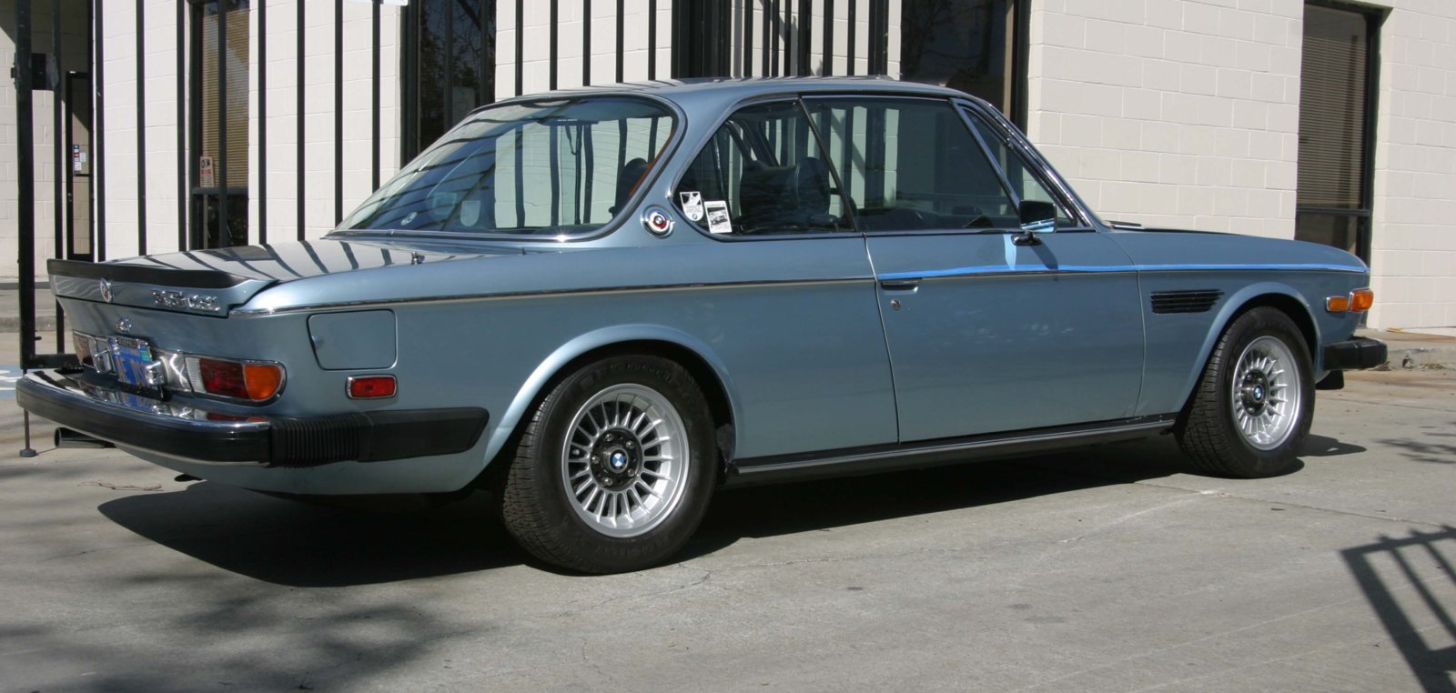

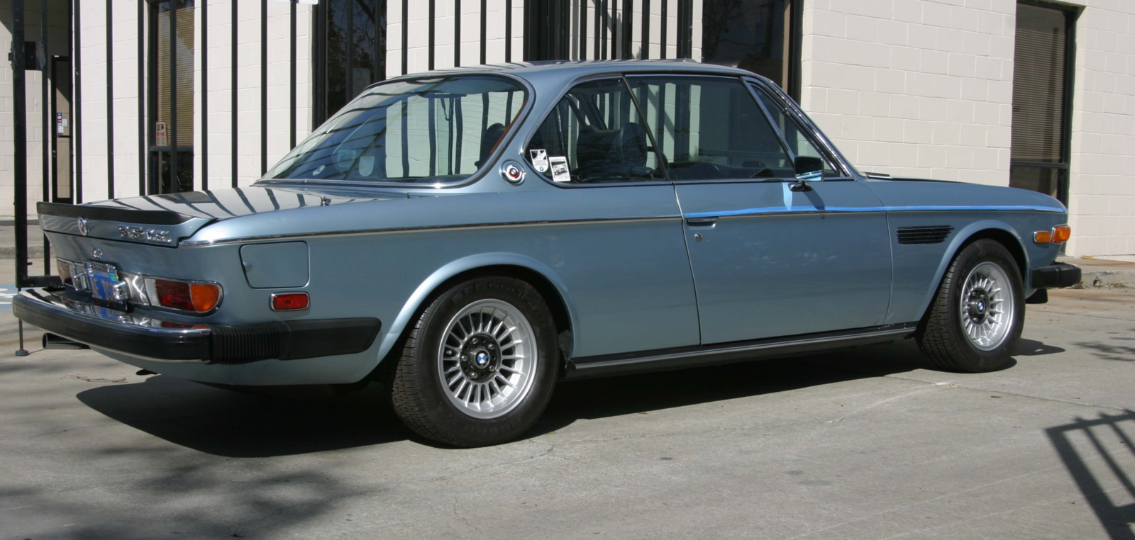

just went out and measured my coupe - from the belt trim to the ground - same on both sides. 16" coupeking alpina staggers w/ 205/55 and 225/50 tires. unknown lowering springs ... my guess CN.
Front - 27.625"
Rear - 27.875"

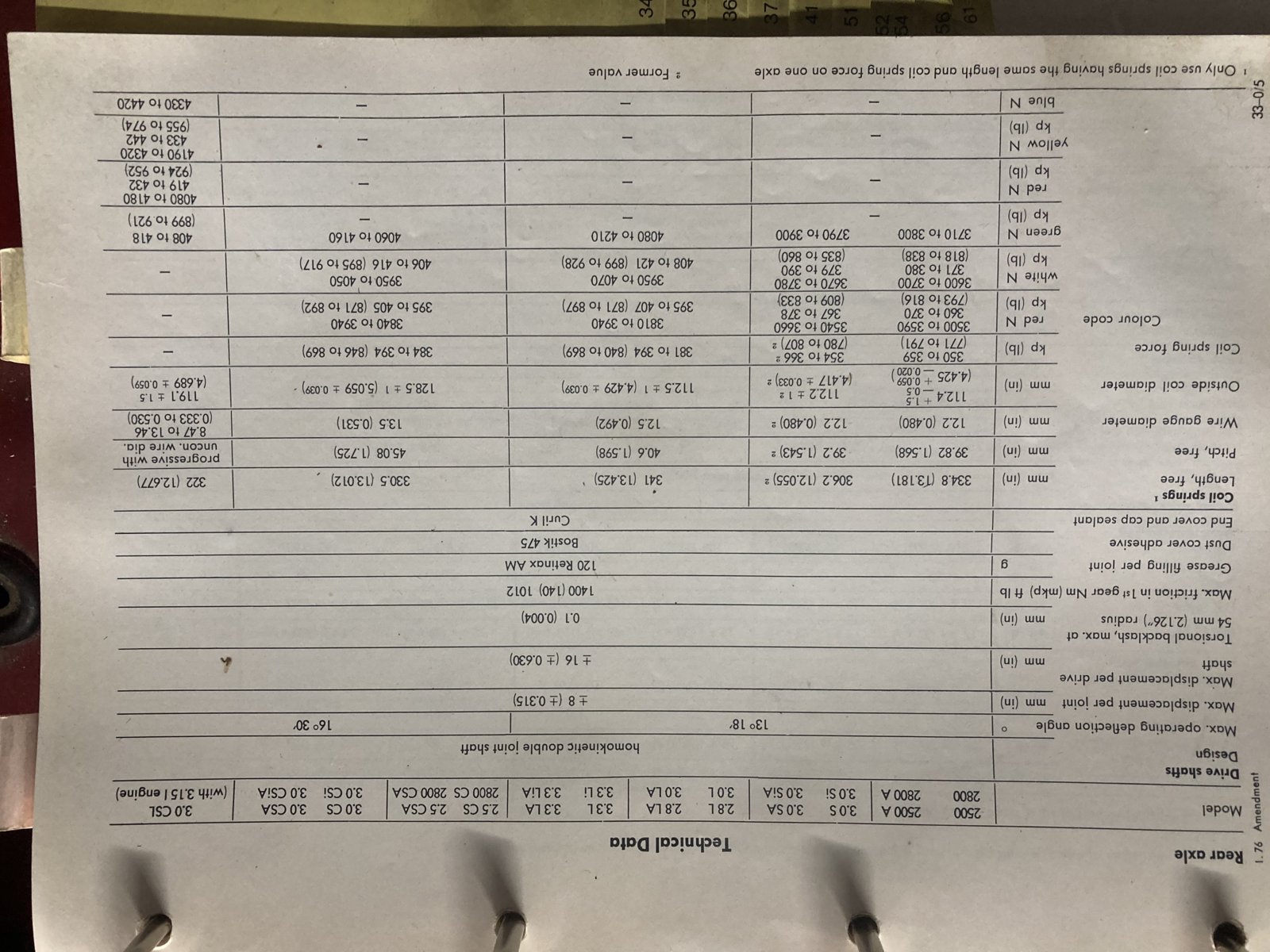

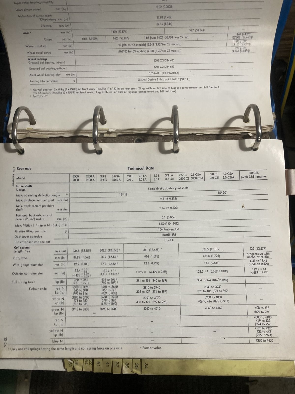

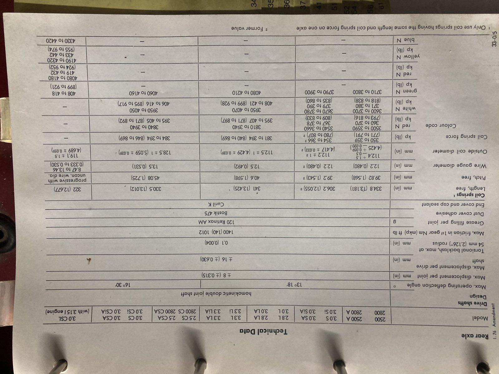

Hi,
Has anyone got a note of what the OEM rear spring rate, and length is??
We are working on the suspension now ~ it sits very very high, I'm not sure the springs i have are actually for this car.
It was an unfinished project when i took it on so a lot of things were half-done.

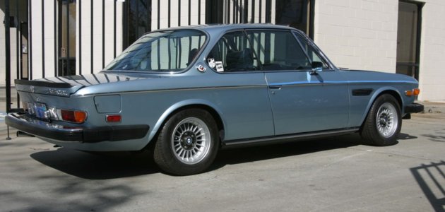

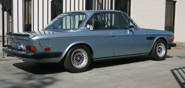

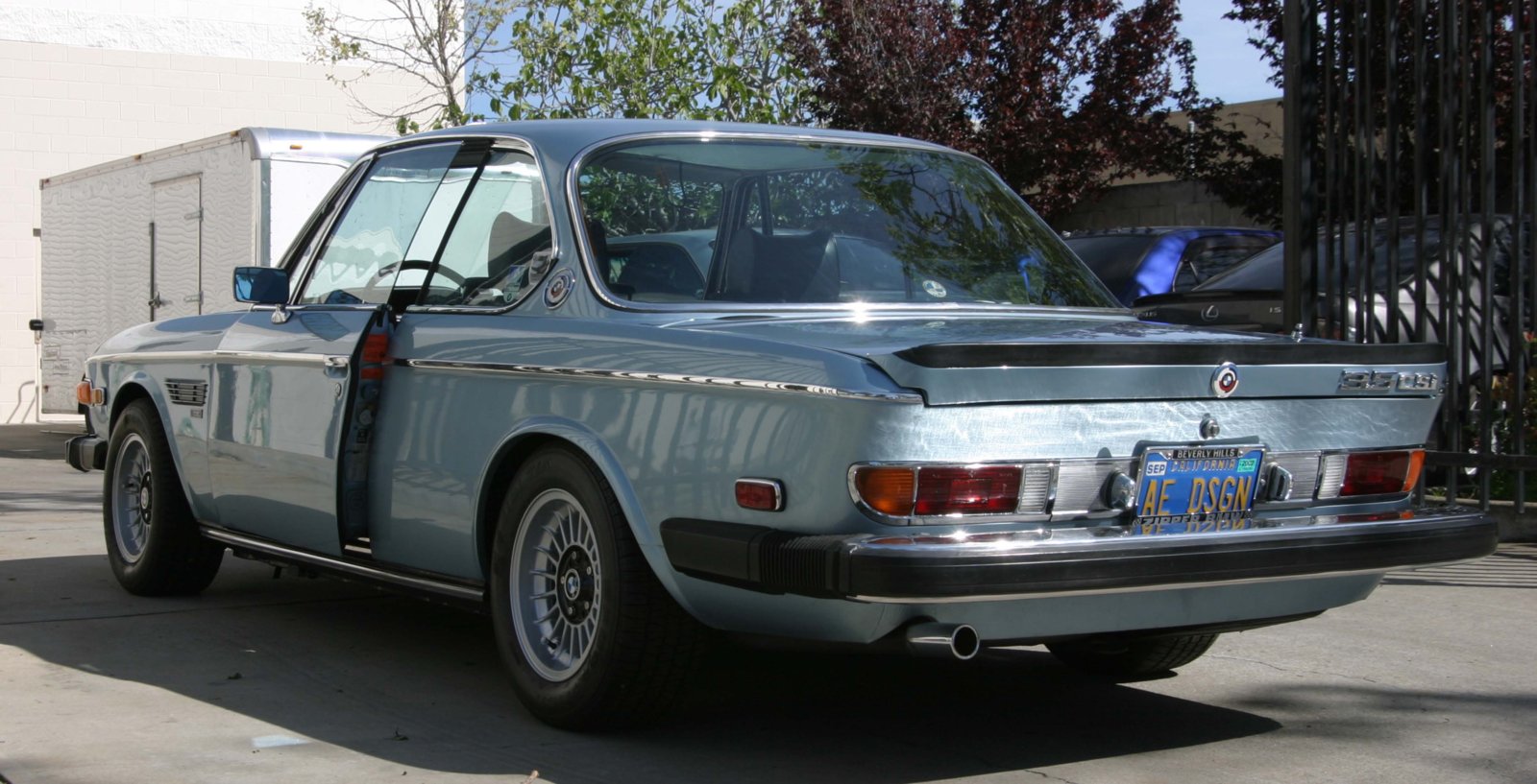

I have recently discovered that I have a 1/2" dip lower on my drivers rear side with a full gas tank as the gas tank is on that side (it dips a bit more with a driver in the car too, however with a LHD car I suspect it levels out nicely). I am now trying to find a way to balance mine to be perfectly even on both sides at the rear so will probably add a spacer or a section of rubber hose on the top part of my RH rear spring.
So it's worth thinking about this if your car is RHD and adding a spacer before everything is set up if you want a perfectly even coupe.
Hi,
I noticed the same, so I have a standard 3. upper spring rubber on rear right and a thinner 2. Rubber on the left.
38mm and 28mm I think.

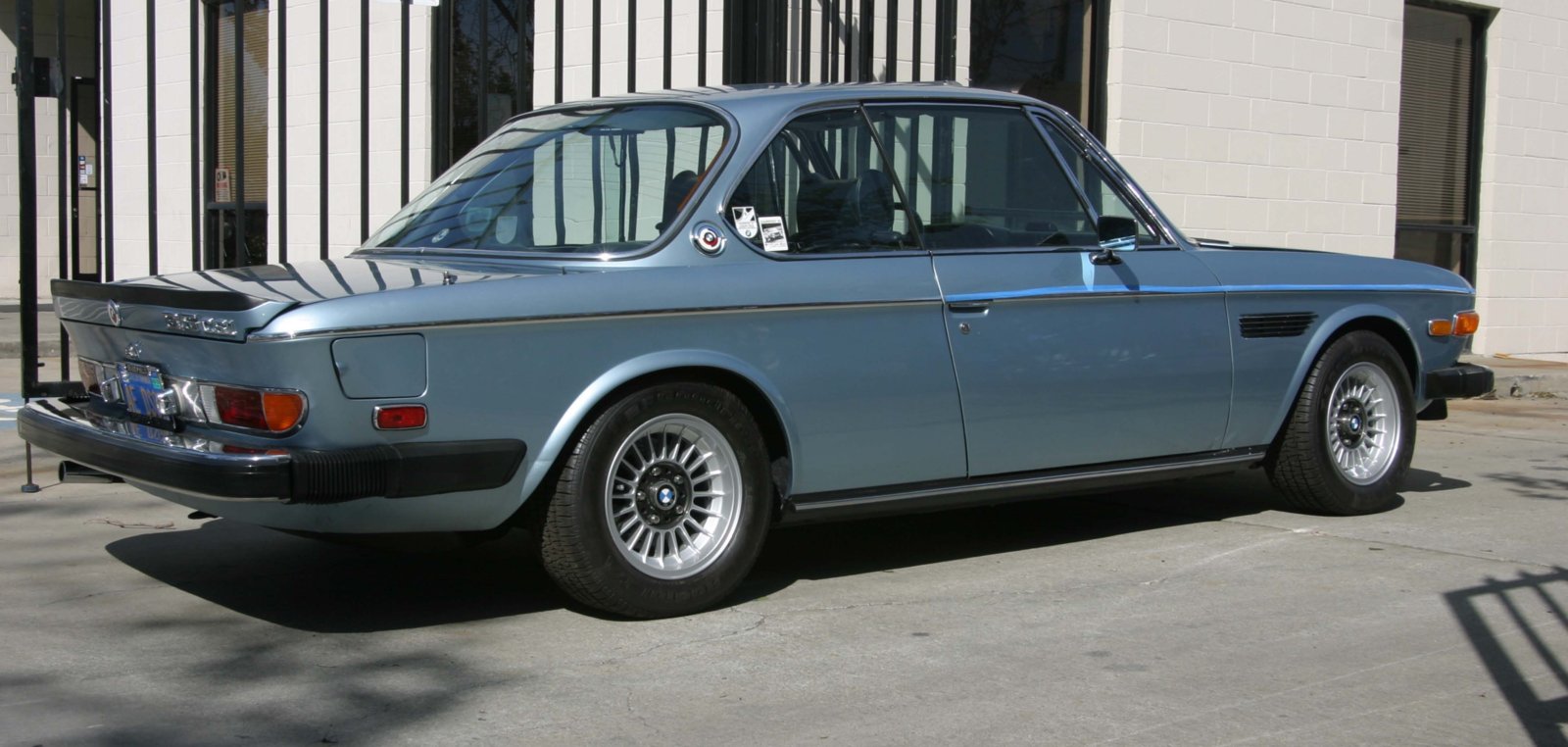

I USED STANDARD SPRINGS FROM "GROUND CONTROL"
ESPECIALLY MADE FOR THE COUPE IT SITS PERFECT.
Thanks for the advice.
That's exactly what I need to do... but where did you buy a 38mm larger rear spring rubber? (I have tried Jaymic but they only sell the one size of rear spring rubber)
