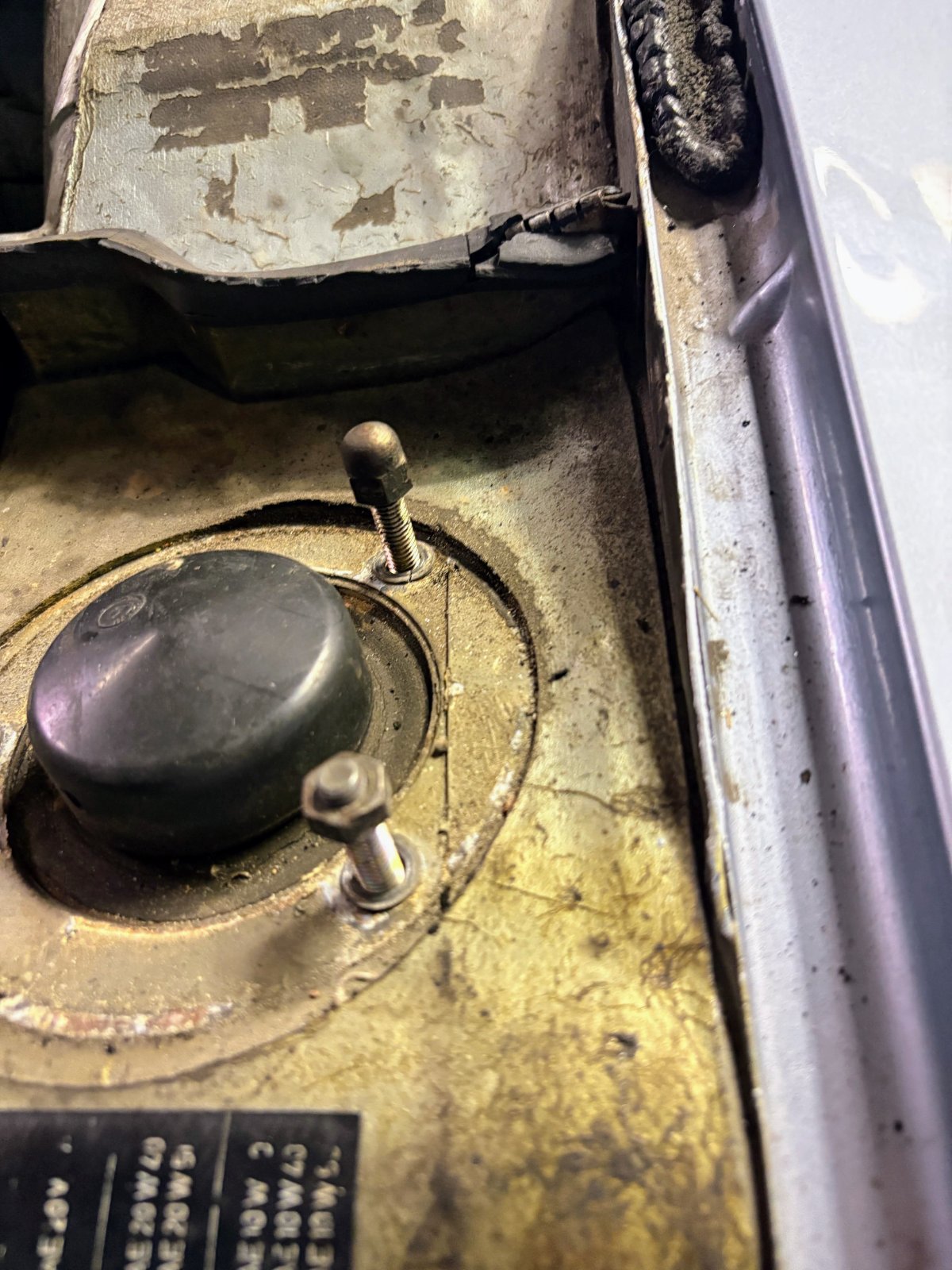

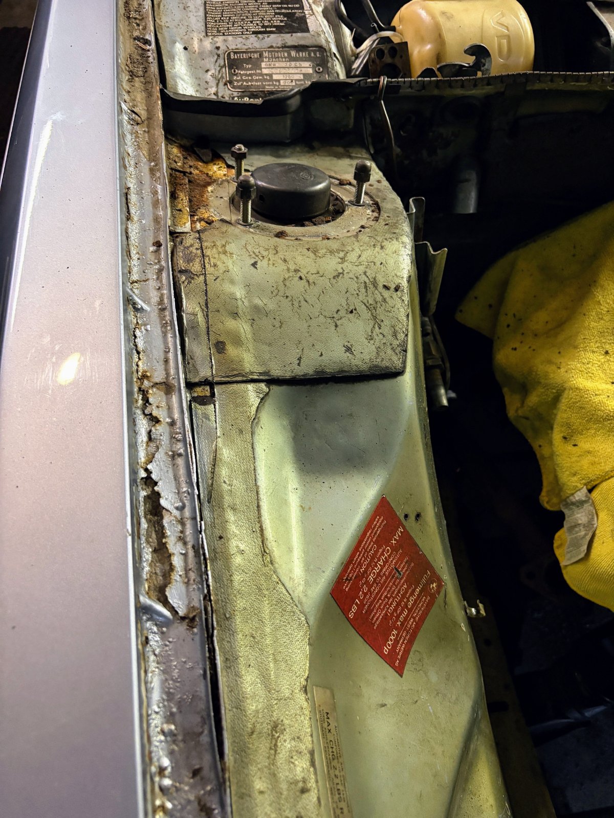

Here are pictures of my inner fender, which is visible from under the hood. There is quite a difference between the right and left fenders in this area, and I am aware that there is certainly rust that is not visible. I want to get an assessment from someone most familiar with rust repair in this part of the E9 - must I replace the whole fender? Are there any other repair options? The paint on this car is actually quite good and shiny, and I am somewhat cost-conscious. I will make these repairs regardless of the cost, but I just want to educate myself before I move forward. I am grateful for any wisdom from the good folks of this forum!

Well, saving the paint is probably going to be difficult, but I'd start by scraping al that flaking stuff out of the hood channel, so at lease you can see what you have.
Get a bore scope and examine the "shelf", which is basically a horizontal section that runs along the inner fender under those areas you photographed. Also check the inside of the box structure that has an open hole on the outer side of the inner fender at the rear of the front wheel well.
Looks like one side is worse than the other...
If your fenders are this bad, it is likely your rockers are also bad. That's actually a fairly easy fix. so don't despair...
I suspect repairing this will require removing the front fenders, and that presumably means re-painting the car.
These pictures alone won't answer the question. In the front wheel well along the lower rear edge is a panel held on with two bolts. Remove that panel and see whether there is extensive rust that has come down through that fender and into the frame. This is perhaps also a job for a boroscope which you can purchase online for cheap or perhaps borrow from another member. Many of us (me included) have or had some slight rust under the bitumen, but this looks more extensive than just surface rust. The construction of the E9 means that you can see this side easily but not the other side - that's what you're trying to get to. Also check behind the glove box and fusebox - the firewall there separates that currently not visible compartment from the interior of the car. If there's rust in either of those two areas then it means it went from within that compartment downwards to frame and rearward into firewall.
There's a nice document in the FAQ I believe that has diagrams of the places to check for rust. Take a bunch of pictures of those areas and post here and I think you'll get a more thorough response. Right now you're asking people to diagnose something within the body by only showing them a picture of the skin - hard to do.

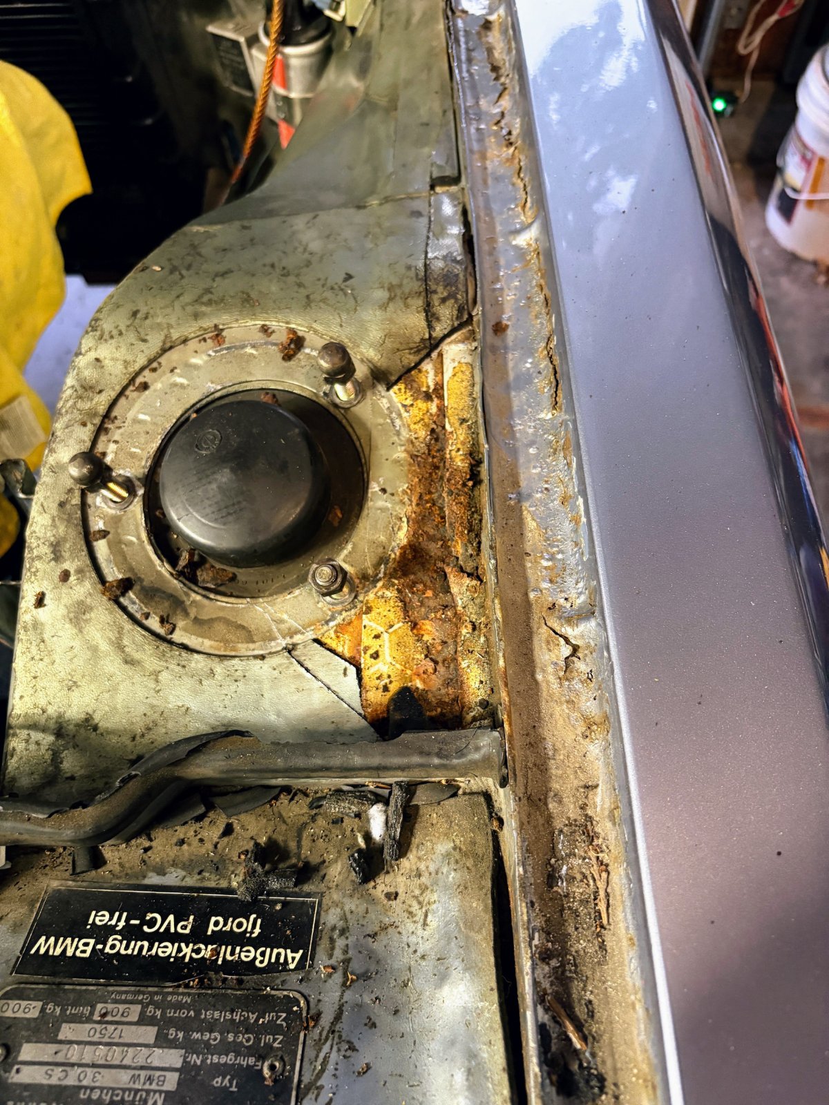

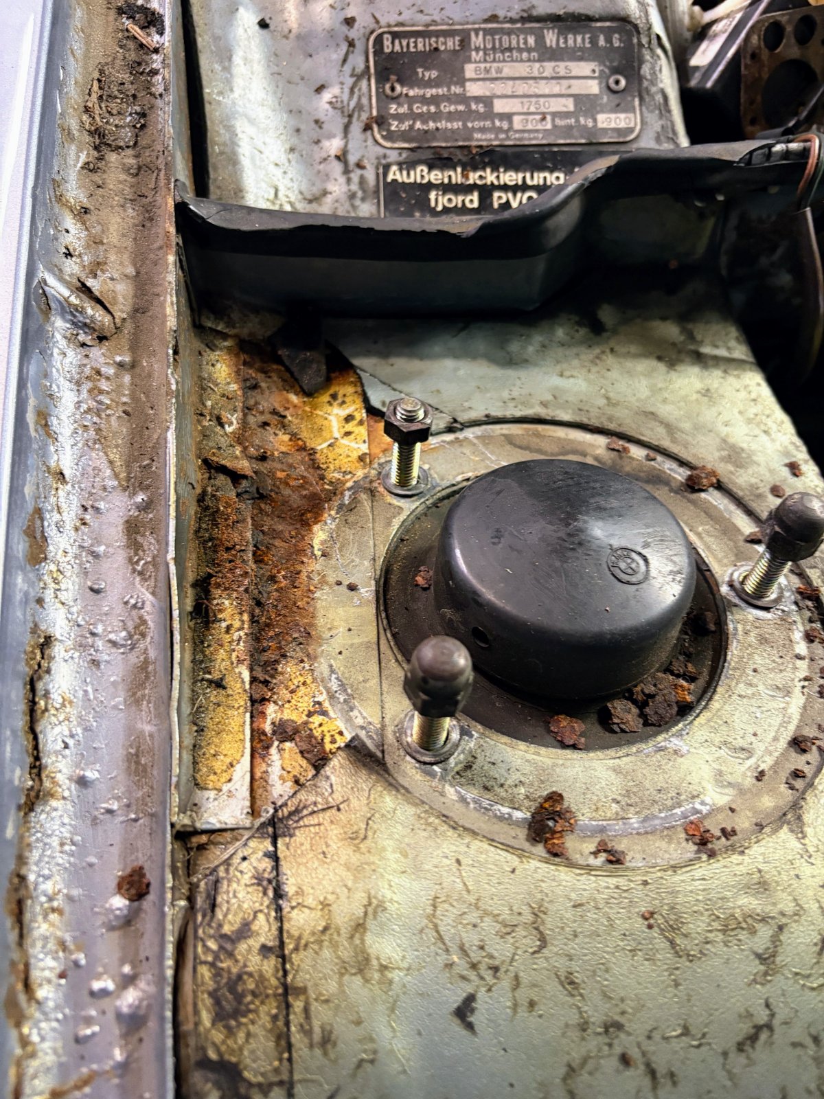

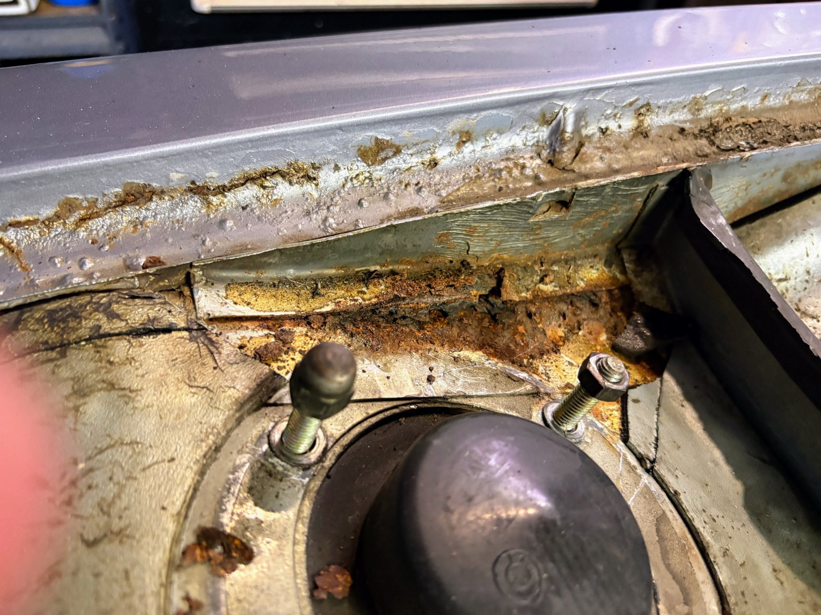

From what I can see in the pics, it is not enough to (for me) to tell you how serious it is.
In pic 2747.jpg, the last pic, the rust seems to be limited to an area about an inch wide, and 3-4 inches long. That in itself isn't terrible.
The 20.000 dollar question however is if the rust started on the visible side. If the rust is litterally only on the top sheet or if the rust came from underneath or the side.
For this it starts with a wire wheel: clean it up to see where it extends to.
If you get a clean surface with no rust trails into the seams or holes into the next layer, then call yourself lucky. A (colormatched) spray can paint job will save you a engine bay or full repaint
If you do spot rust going into the seams or downwards then e9 ownership becomes all the more gritty.
Two likely "below" origins: the easier one is the foot long strip along the fender top edge, that strip physically connects the inner to the outer fender. If the rust is just under that strip, remove it, clean it and weld in a new strip (80 euro's at Walloth) It isn't a biggie, and again it can be a (color matched) spray can fix.
The more difficult it gets is when you followed the above, removed the strip, and see it has rust that you still can't reach: going down through the inner fender or further along the edge of it.
Also you might spot rust growing in the vertical seam it shares with the outer fender (that runs the entire length of the hood) fender
Then likely the layer beneath (it's like a union down there) is rusted as well.
Below the innerfender, where the 3 bolts protrude is a 3 mm thick metal plate that holds the strut. It's sandwhiched together over a large area with 20 spotwelds or so, and a zero gap situation with water from the wheel below makes for a good rust trap.
If that is rusted badly it needs to go out, and that means fenders off, thus a half car repaint at least.
I'm sure all cars have some rust there, just how much does yours have? If the rust is serious, it will push the innerfender up as that is thinner metal. The other end of that thick plate connects to the firewall in the aforementioned 2 places: R behind glovebox and L to fuse box.
As you state that those are still ok when looking from the cabin side, i am hoping (from 10.000 miles away) that the thick plate is not rusted soo badly in order to justify pulling it out.
I'd start with the wire brush, and make some pics and post em here.
I'll try to add some pictures later today on how it's build up below. As i have it all apart it's not that difficult for me.

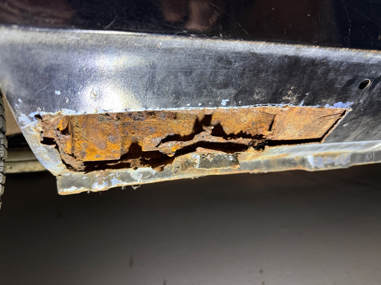

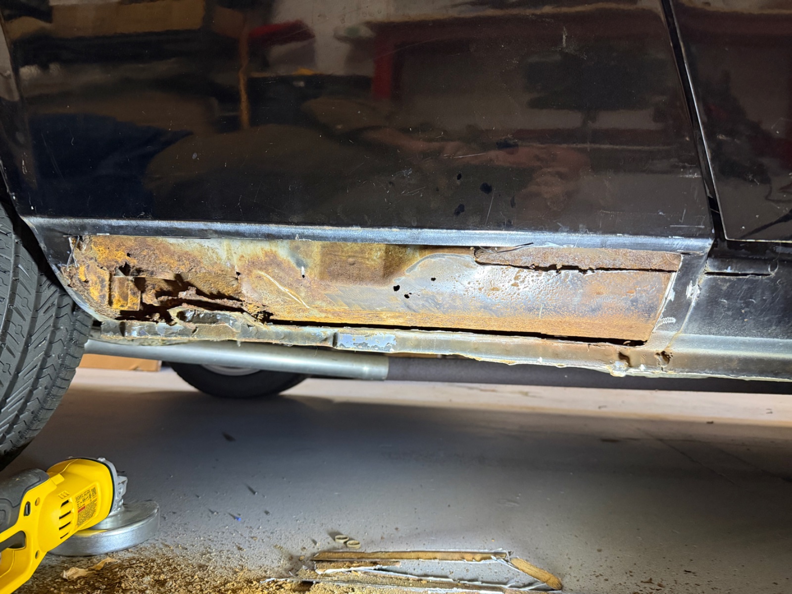

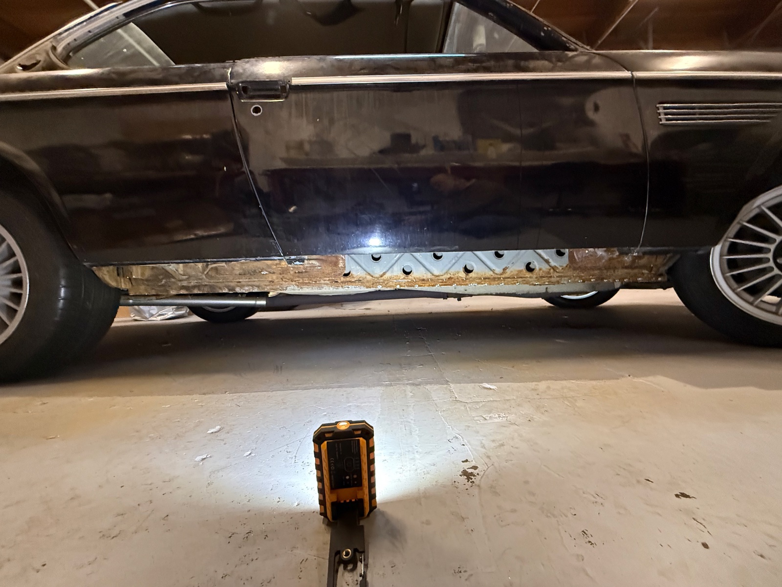

Here are some pics of my right side rocker that had literally a 1.5 inch round rust spot bubbling under the paint at one end. The painted part is the lower rear quarter panel, the rusted sharp bits are what was left of the outer rocker, and the rusty but sound parts are the lower C-pillar and the intermediate rocker beam. Note in the middle pic I have cut away most of the lower quarter panel, and exposed the outer rocker (this is what you see at the door opening under all the trim... it dives under the front fender at the front of the door, and under the rear quarter at the rear of the door). I have cleaned it up here, but you can see rust perforations all the way up to the B-pillar... :
Here is a pic withthe entire outer rocker pulled off. The zig zag piece is the intermediate rocker beam. You can see the large rusted areas at the front of the door and the rear of the door. Those are the bases of the A and B pillars, which weld to the intermediate beam. The shiny little dots are the remnants of the spot welds. There is a special drill you use to drill out a flat spot the same diameter as the weld.

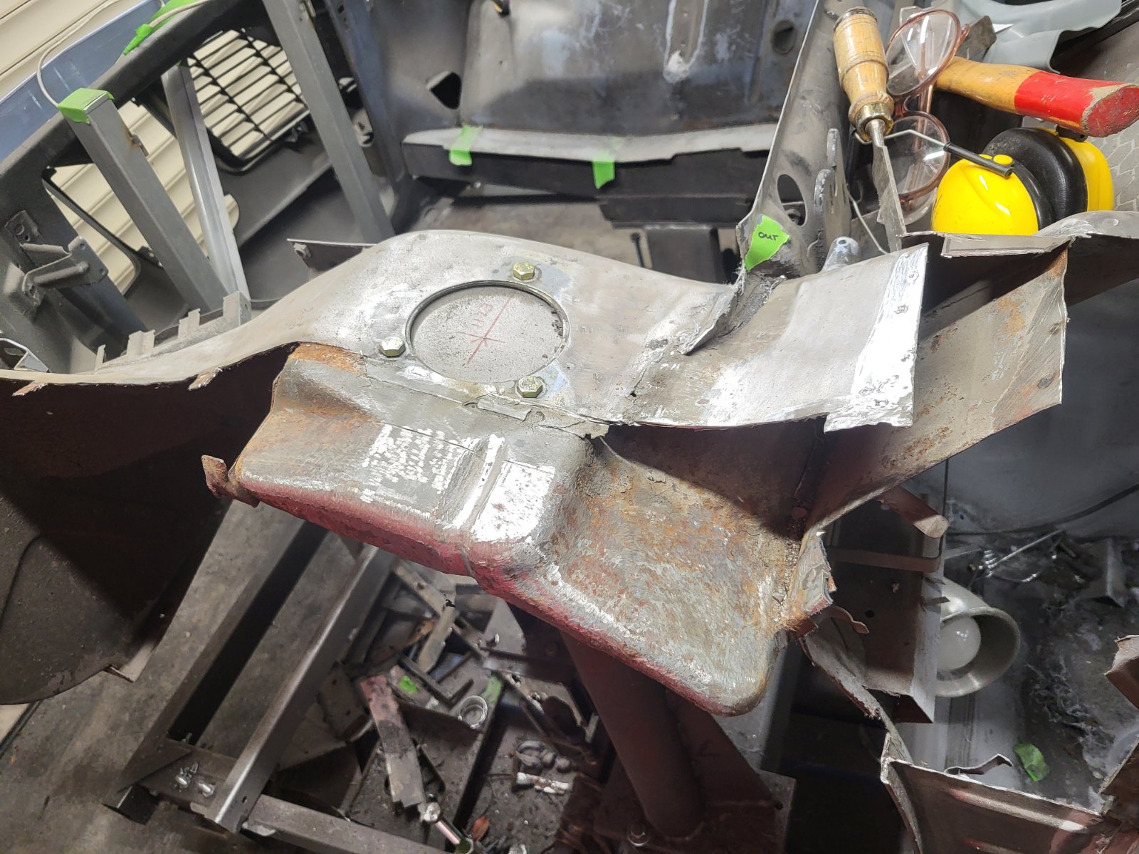

Thank you - very helpful!

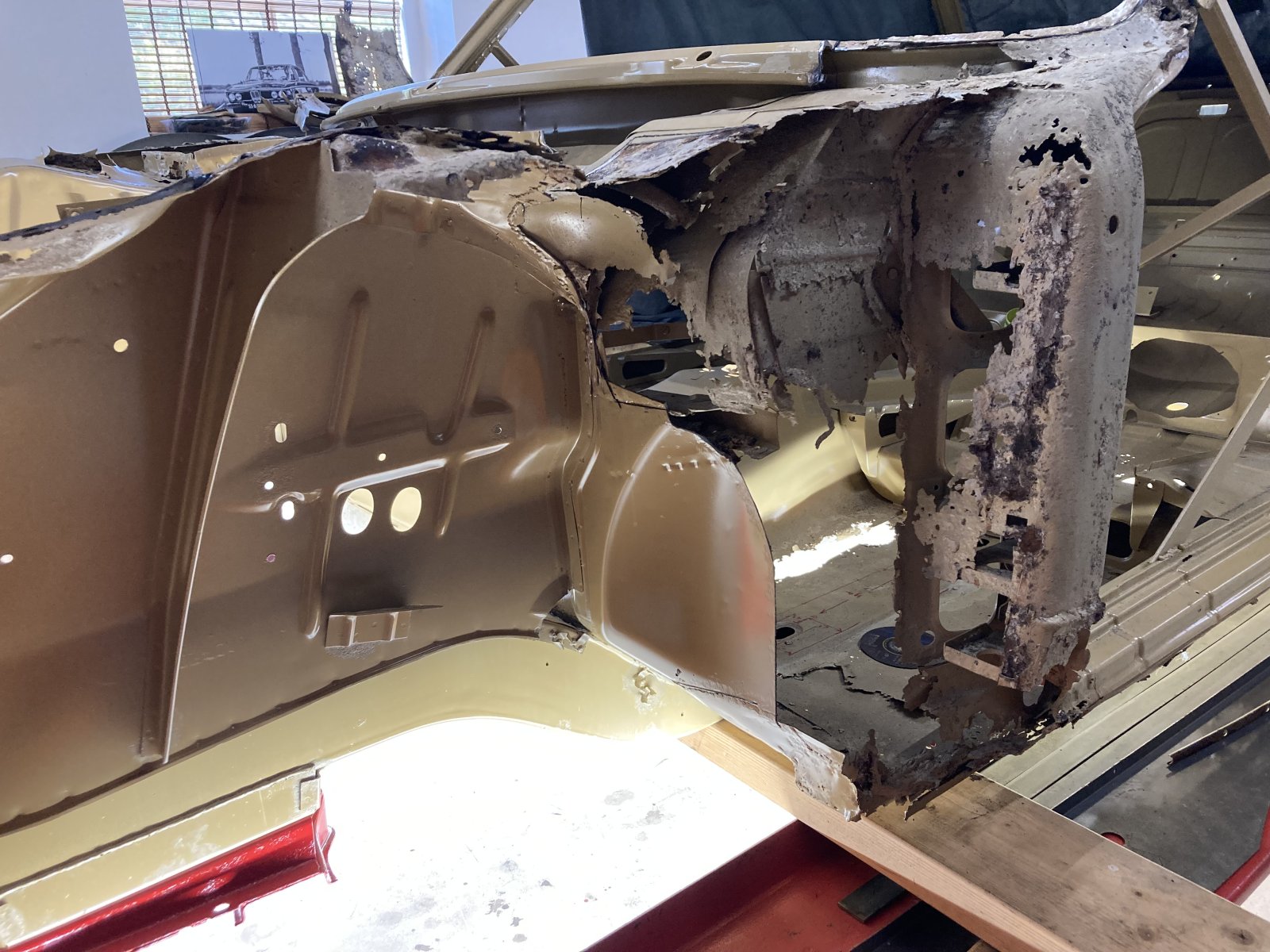

@Fritzie : that last pic! It's missing sooo much metal!
That's not a small job to tackle.
I am humbled by your desire to fix it.

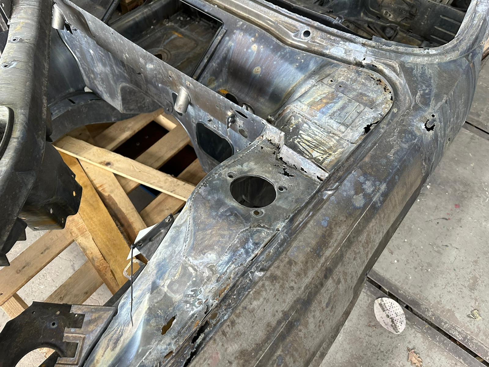

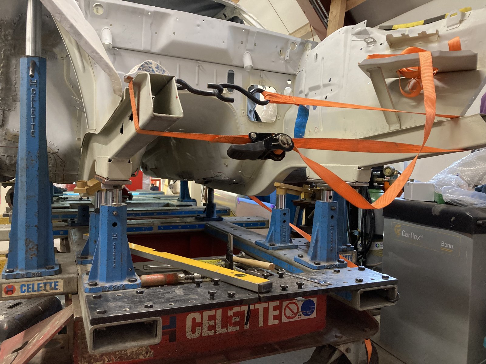

In the meantime another e9 project come across to me. Even worse than this project, so I decided to make an Celette complete with an e9 Celette tower set. Lot of work to make them to fit the original bmw alignment drawing. Here are a few pictures. The tower set I made has 9 towers to keep the chassis aligned during large replacements of parts.
So I’m busy with that project first. By the way, the bad previous welds and restoration you see at the left of this front picture - right side of the car - will be cut out completely! Of course :-)

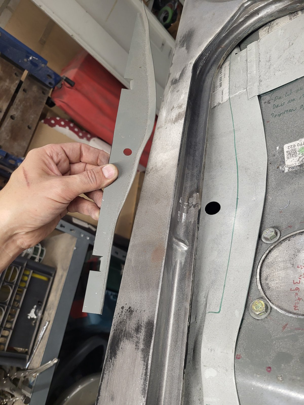

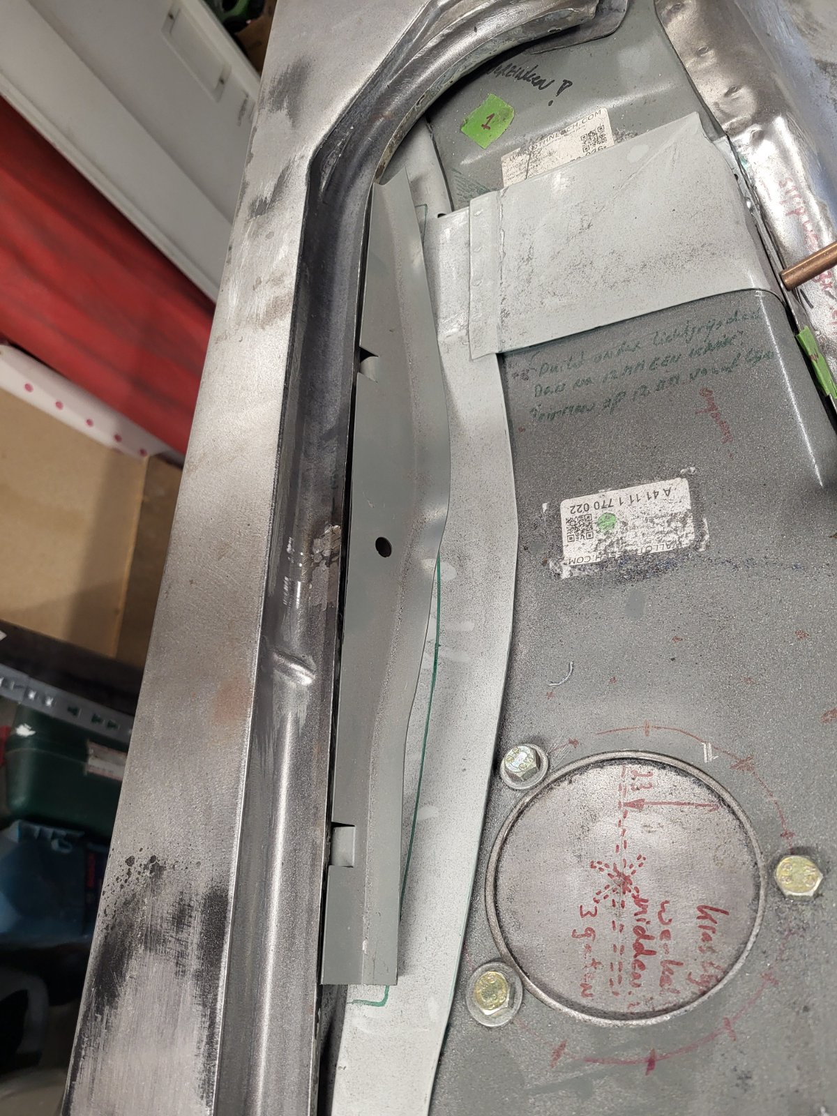

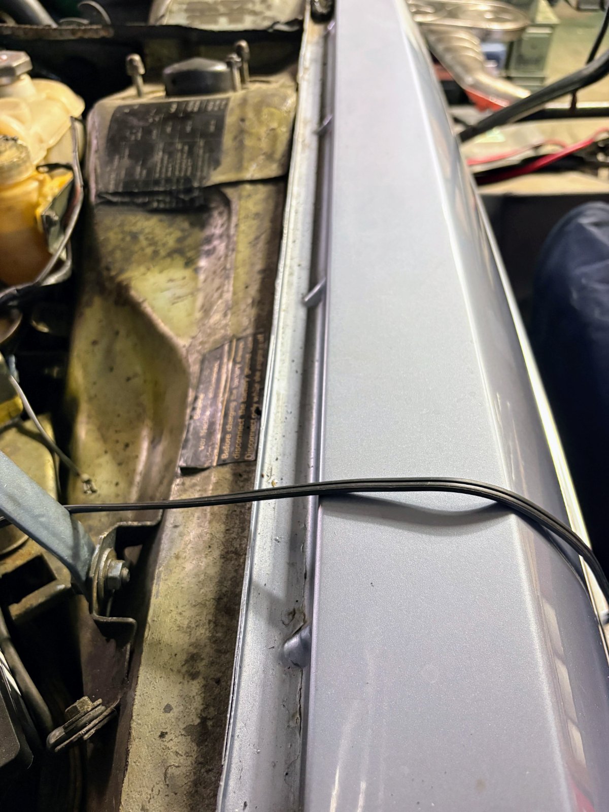

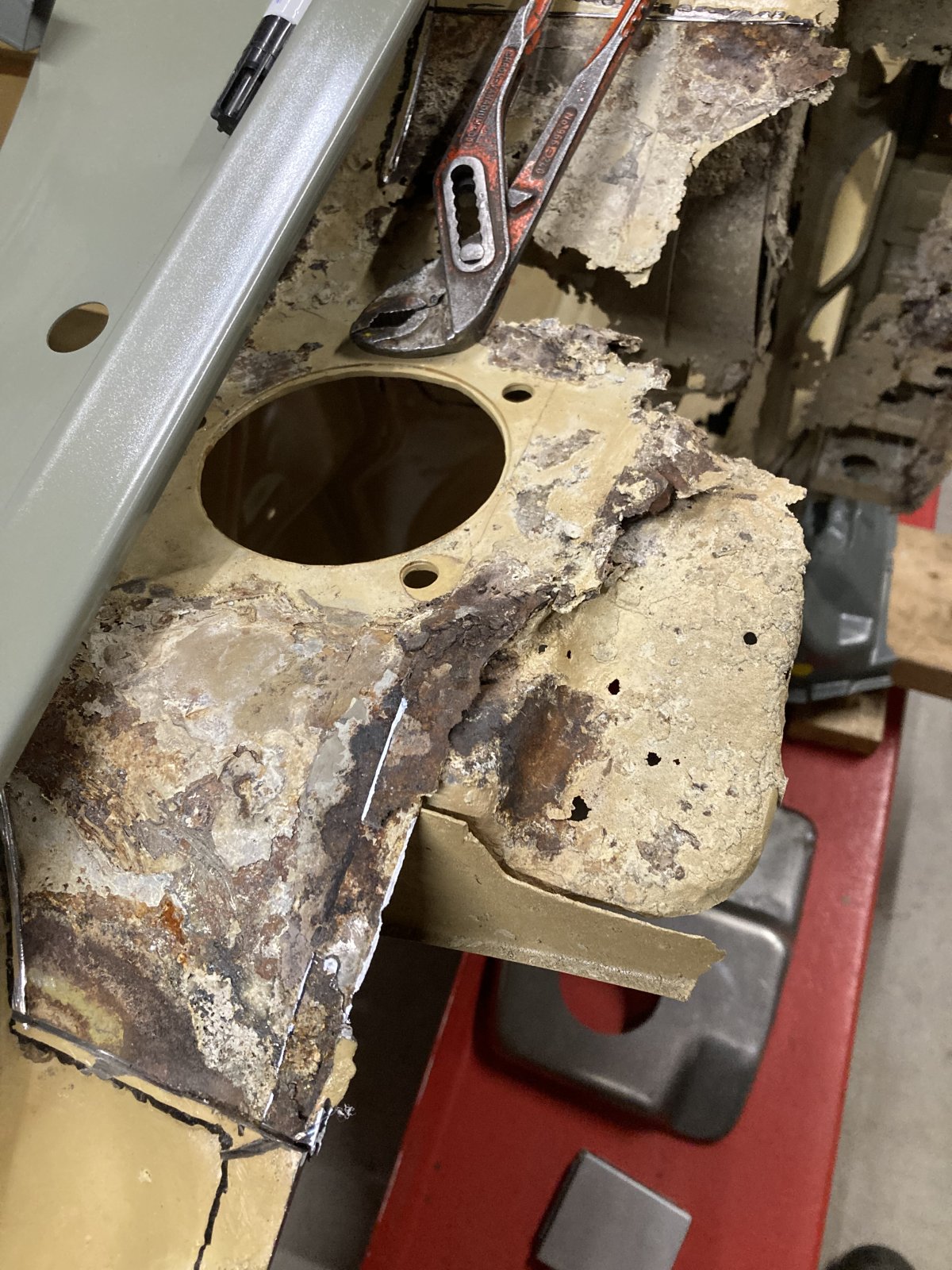

Here the promised pics, were the "union" construction is already very well visible on the pics from @Fritzie , here's a specific pic of the foot long strip that you may want to remove as a second step (if the rust doesn't disappear with a wire wheel alone).
