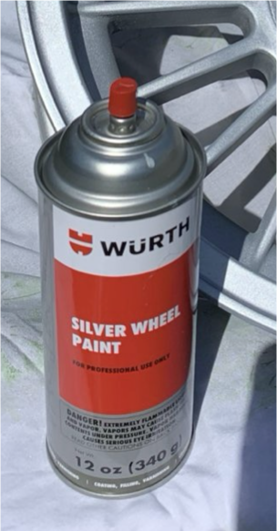

Here is my post of painting wheels myself.
I think Wurth paint has a good match to bmw rims. That’s what I used.

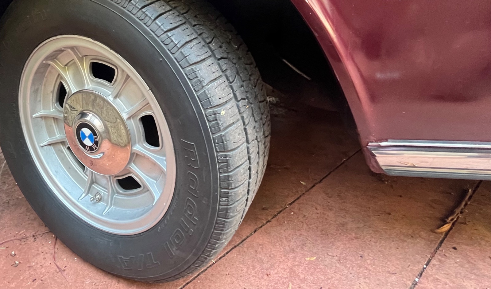

Meant five(5) spoke like restart's photo above.
Loved them on Coupes and Bavarias, but when I saw the original steelies with the chrome ring and cap I was smitten.
Steve, Wurth does make a nice silver wheel paint that I have used. I followed with 2k clear coat.
Was looking for paint for some Audi Wheels I have, most German/European cars mid late 50's on, and some before had a shade of silver only the real Wurth paints can duplicate it's lacquer paint, drys quickly, and is somewhat more durable than say modern day Acrylic Enamels, that said I found a Duplicolor paint HWP101 as a dead on match color wise little easier to obtain locally as well on line, but need to use little more than you would say a lacquer based Wurth, honestly the Duplicolor is probably not as long a wearing paint as the Wurth is, but it's only $9.00 can at JB Tools, the Wurth cheapest I could fine was $28.00 when I was looking about a year ago, on sale now prices coming down, not something were used to in this economy so hurry.....
While we're nitpicking Steve, are the FPS 5-spokes aluminum? I always understood they were an alloy of some sort.
