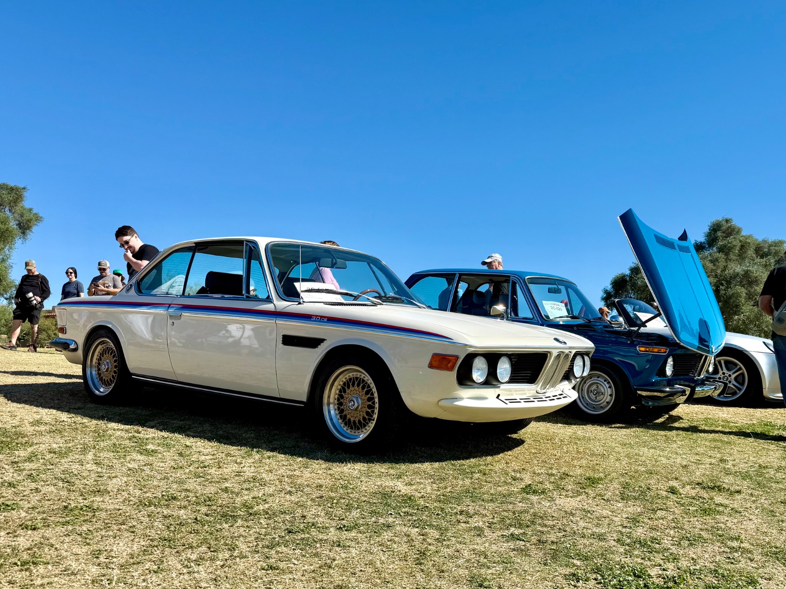

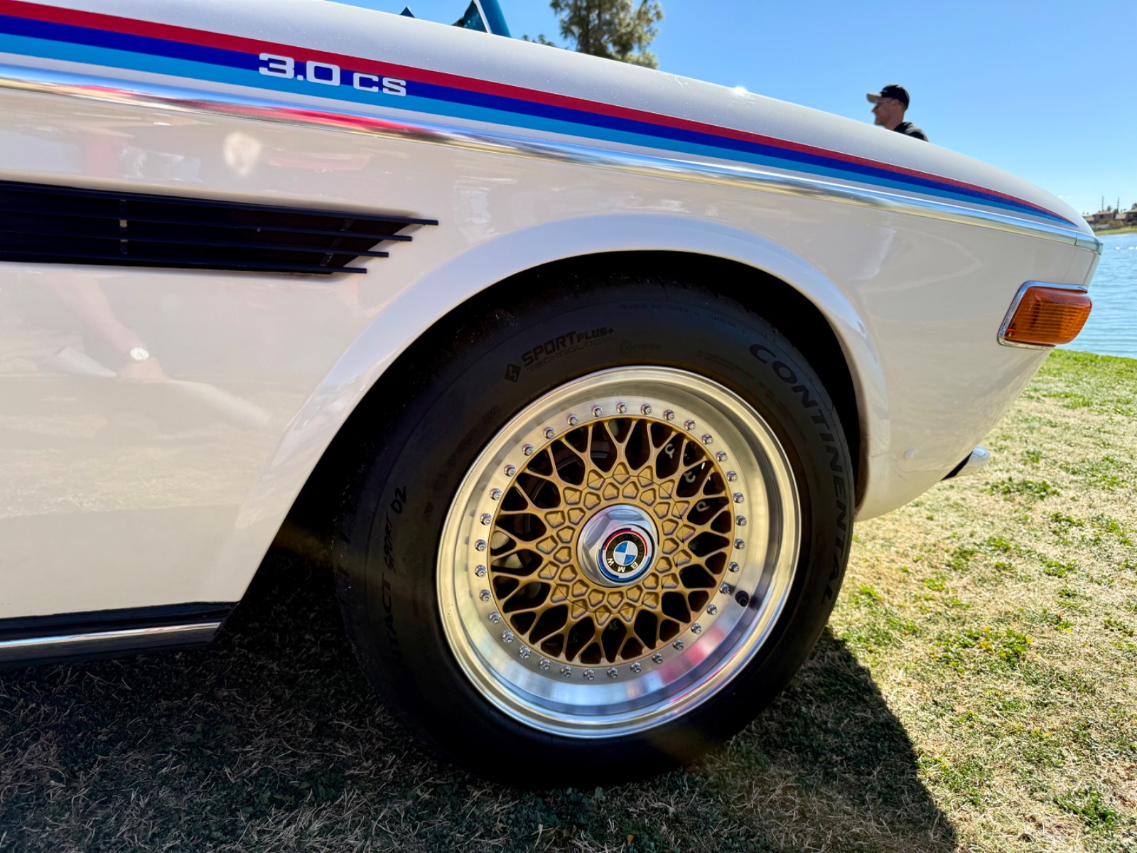

I am posting Mikes Stanceworks E9 with deepdish BBS rims which I think are a perfect match for this car... Does anyone know the correct wheelspecs?
If not, I am open to your suggestions, what are you running with air or without air... suggest away, feel free to shoot my airride plan down - I am still not 100% sure :)

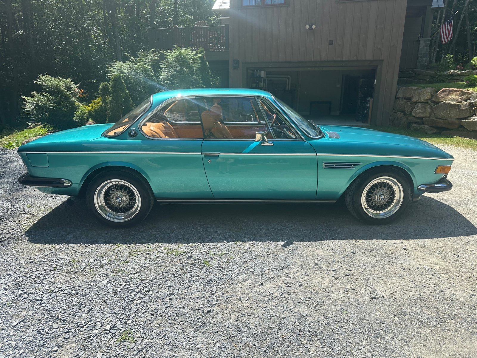

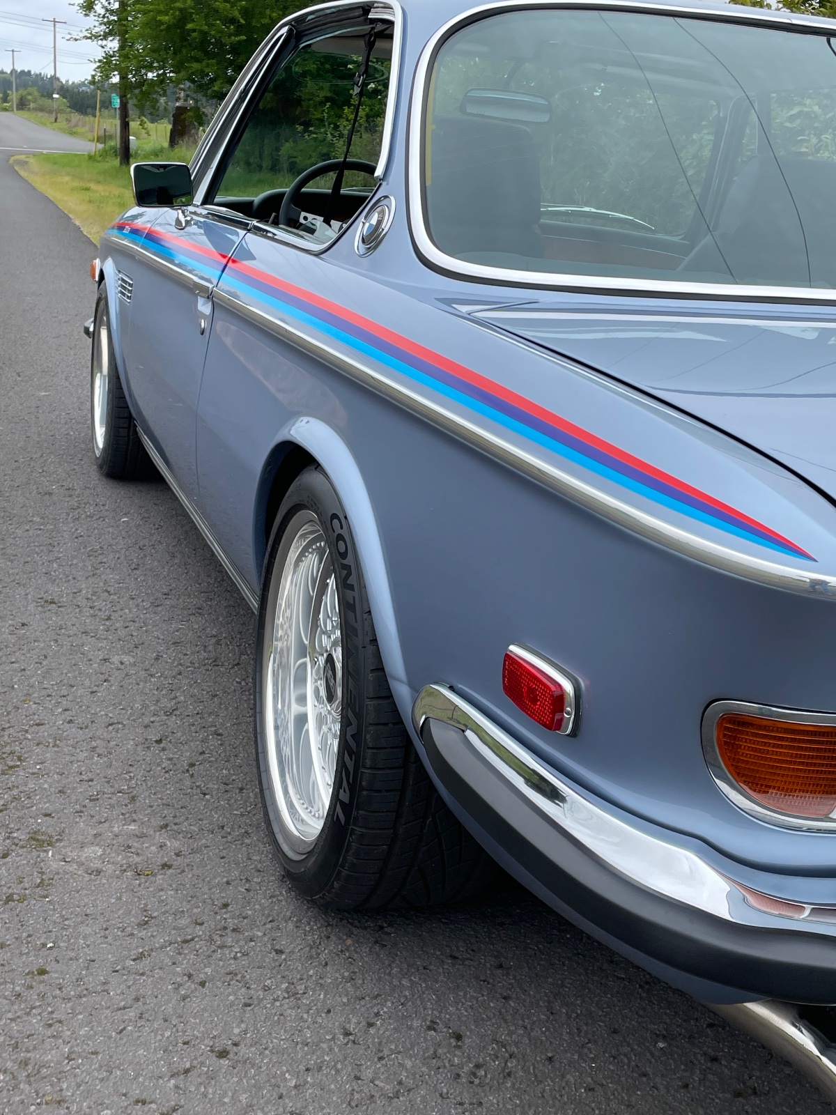

Here are my 16” bbs rs005 wheels that I just refinished

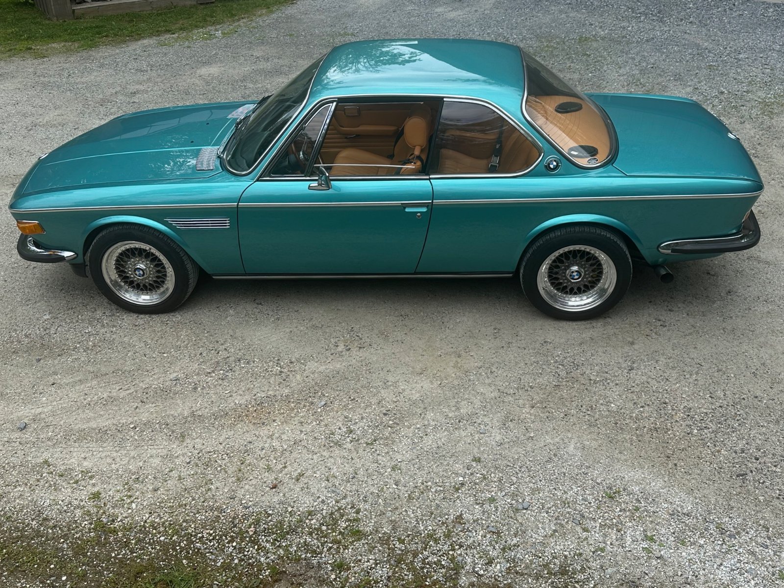

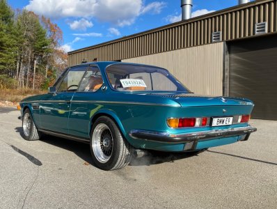

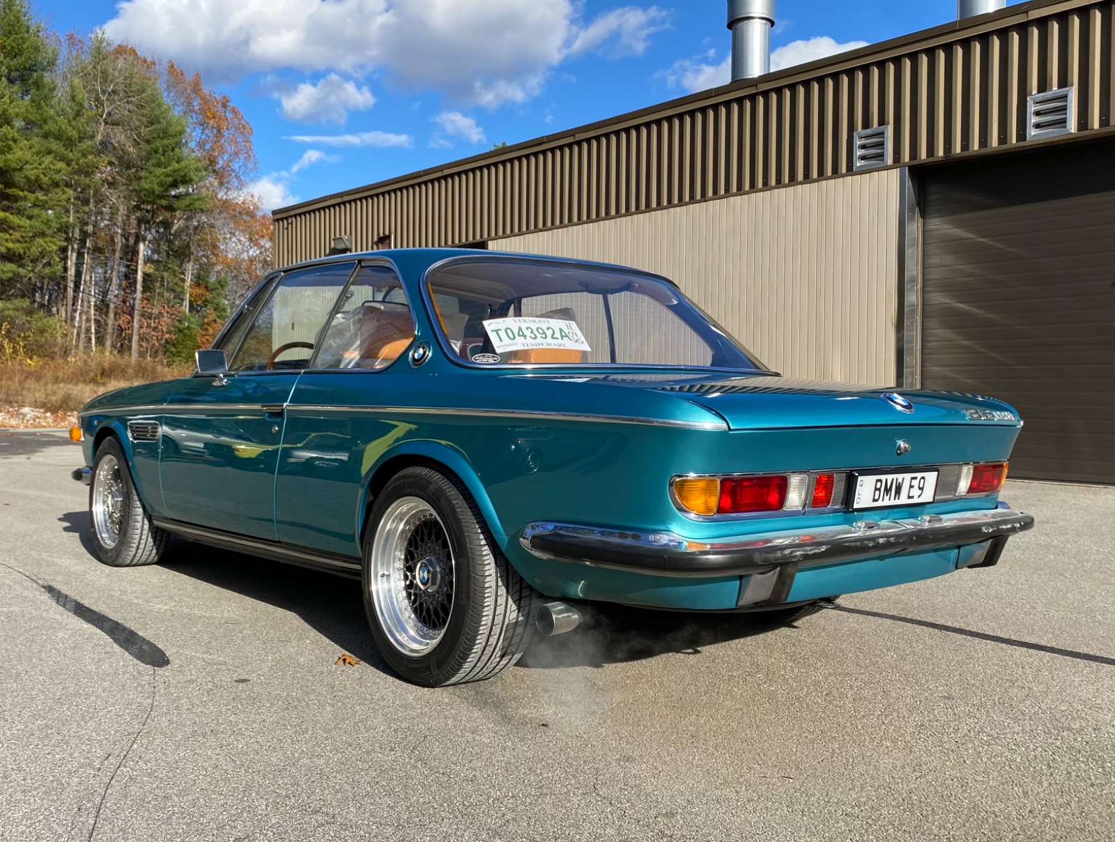

For what it's worth, my Coupe came to me with BBS RS005 16X7 with 205/55/ZR16 front and BBS RS006 16X9 with 245/45/ZR16 in the rear. All riding on Pirelli PZero Rosso tires. This size is hard to find by the way, not lots of options. The look is great, and the car rides smoothly over bumps while still providing that classic BBS look such as minivan's. Hope this helps!

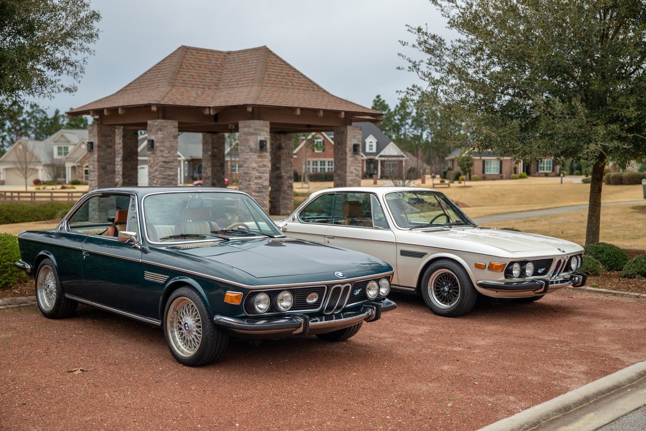

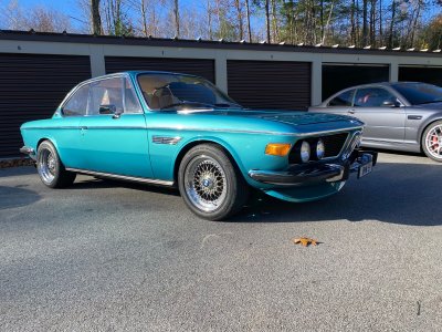

Buddy of mine has a set of 17" e39 Style 5s on his car. Here's a pic of his car next to mine. My car has 15" Wed Bavarias:
These look RAD :) Nice E9s guys... I can see you guys really like thicc tyres like thicc latinas :D

Thanks for the input, that is one nice E9, color is stunning!
Can you post your ETs on those rims? And maybe a different angle to see the width more...

Thanks man. Sure, here you go!

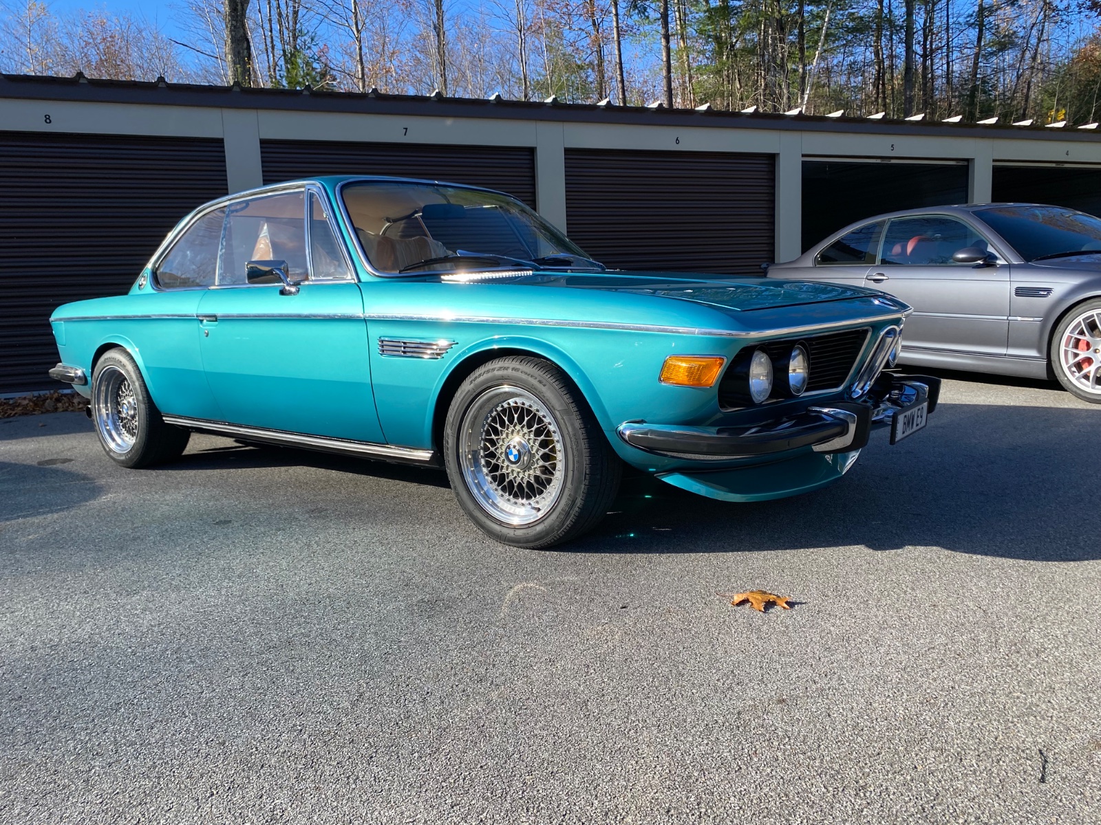

Here's my setup that I have ran for 14 or so years, fairly rare staggered Style 5s (17x8s,17x9s) with RS center conversion. Maybe as big as you can go without making a bunch of modifications. I had the front fenders rolled when I had the car painted 22 years ago.
Those are the same wheels Tom (BMWSKI) has on his car in the pic I posted. I've driven Tom's car, and despite what I always say about liking a fat sidewall, Tom's car is not at all harsh.
