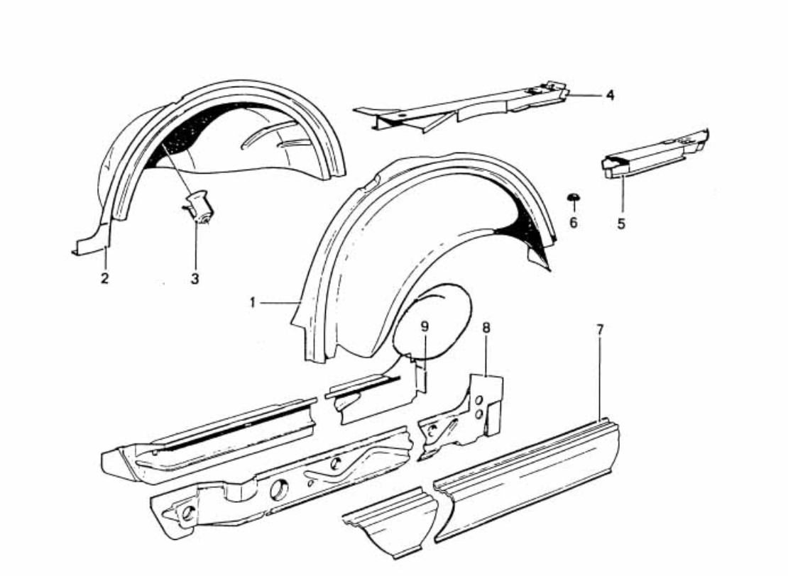

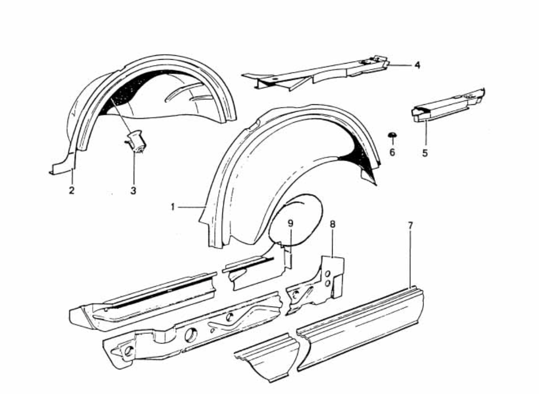

The rocker itself is a beam composed of three different pieces. You can see that here in the RealOEM image:
There is an inner piece (9), which is what you would see inside the car with the carpets and insulation out. There is the zig zag beam (8), which I suspect is the primary structural element, and there is the rocker "cover" (7). "Cover" is an odd way to describe it because in the front and rear it is covered by the outer bodywork, and then there is the removable trim cover over that...

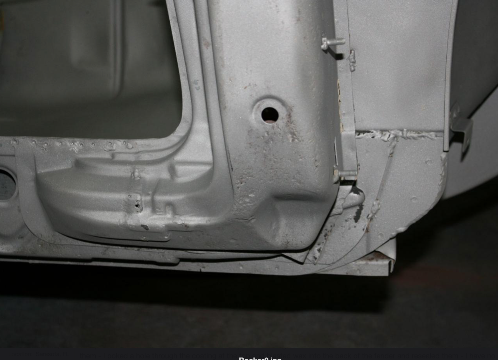

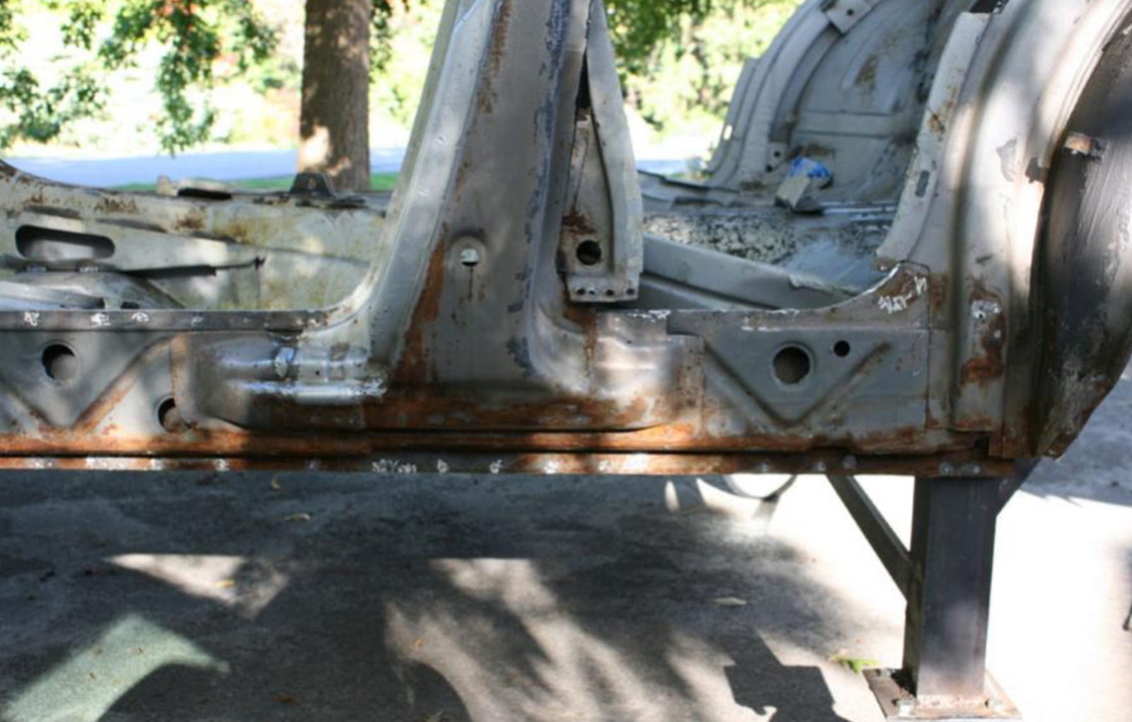

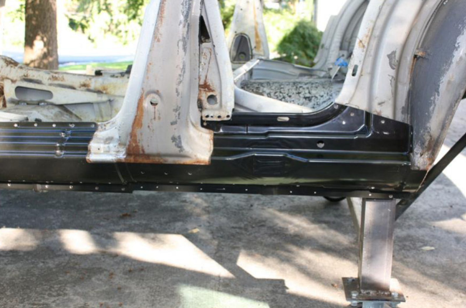

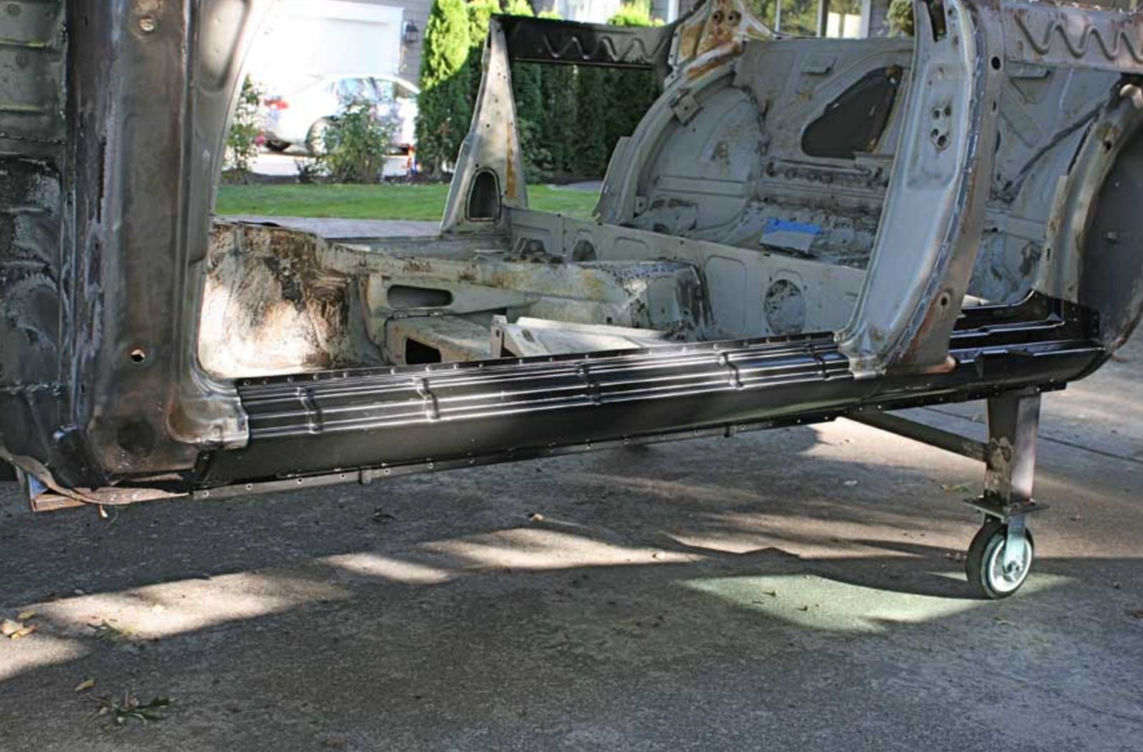

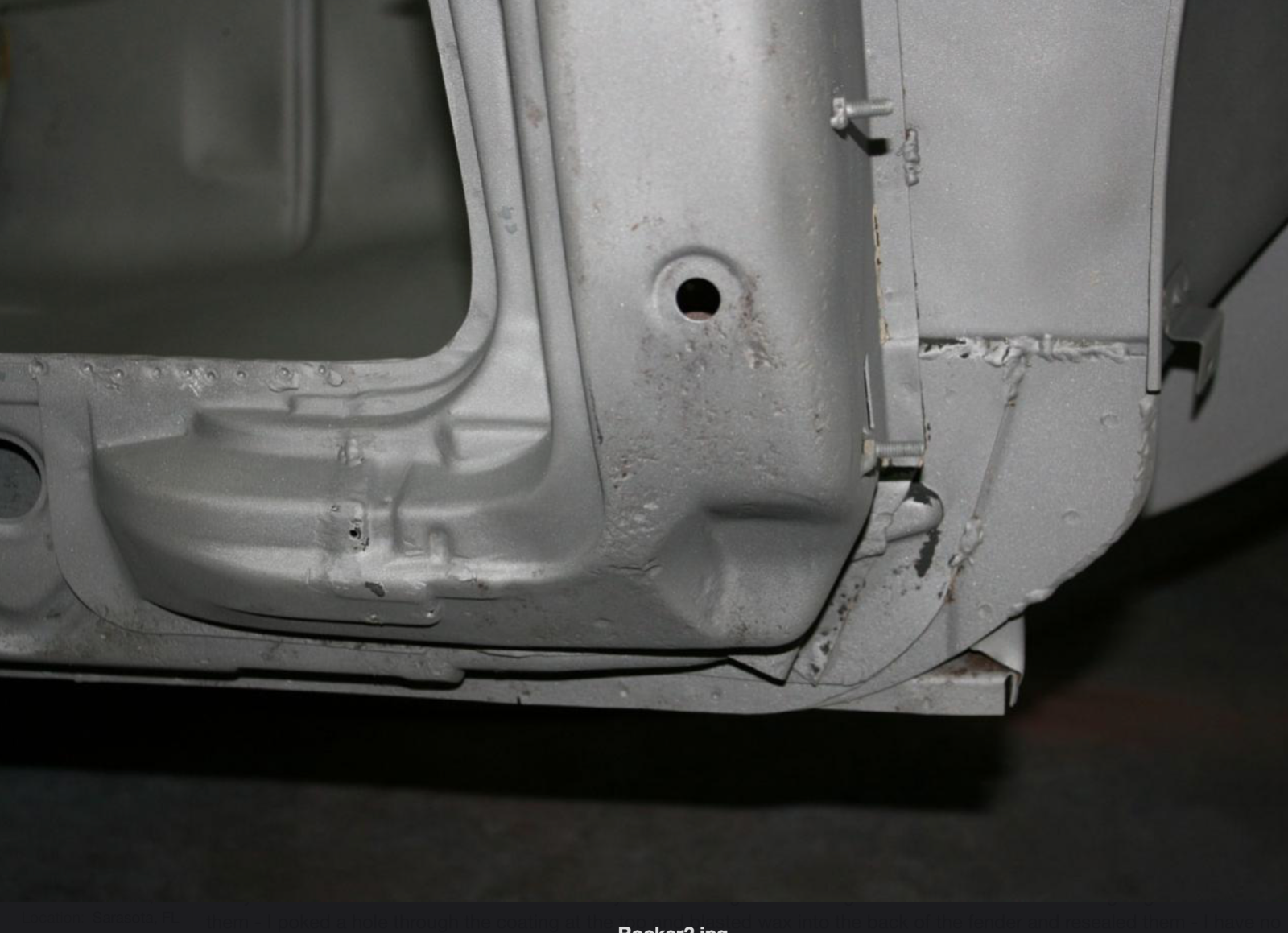

The structure is more complex at the "pillars". @Sven's phots are very illustrative! I hope he doesn't mind me reusing them with some detailed explanation!.
Here you can see that the A and B pillars and the rear wheel arch all attach to the zig zag member. These will ultimately reside UNDER the rocker cover, which has cutouts on the top that they rise through, forming the basis for the upper body.
Right side A-Pillar attached to the zig zag beam:

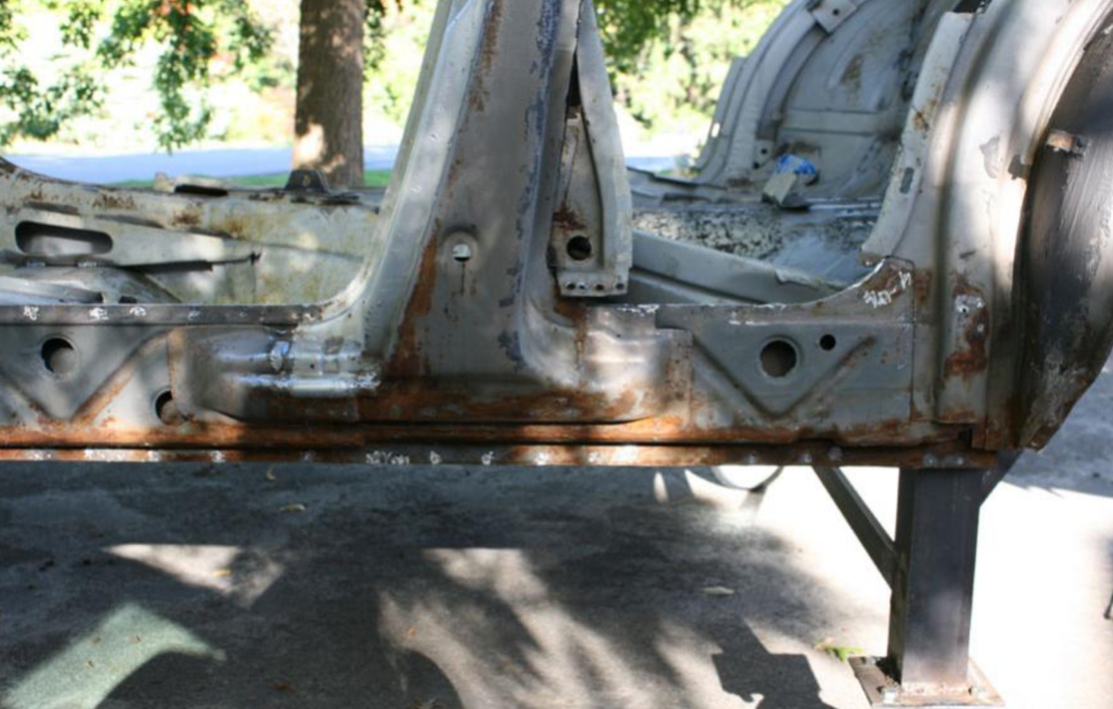

Left side B-Pillar and Rear Wheel Arch (lower C-Pillar) attached to the zig zag beam:

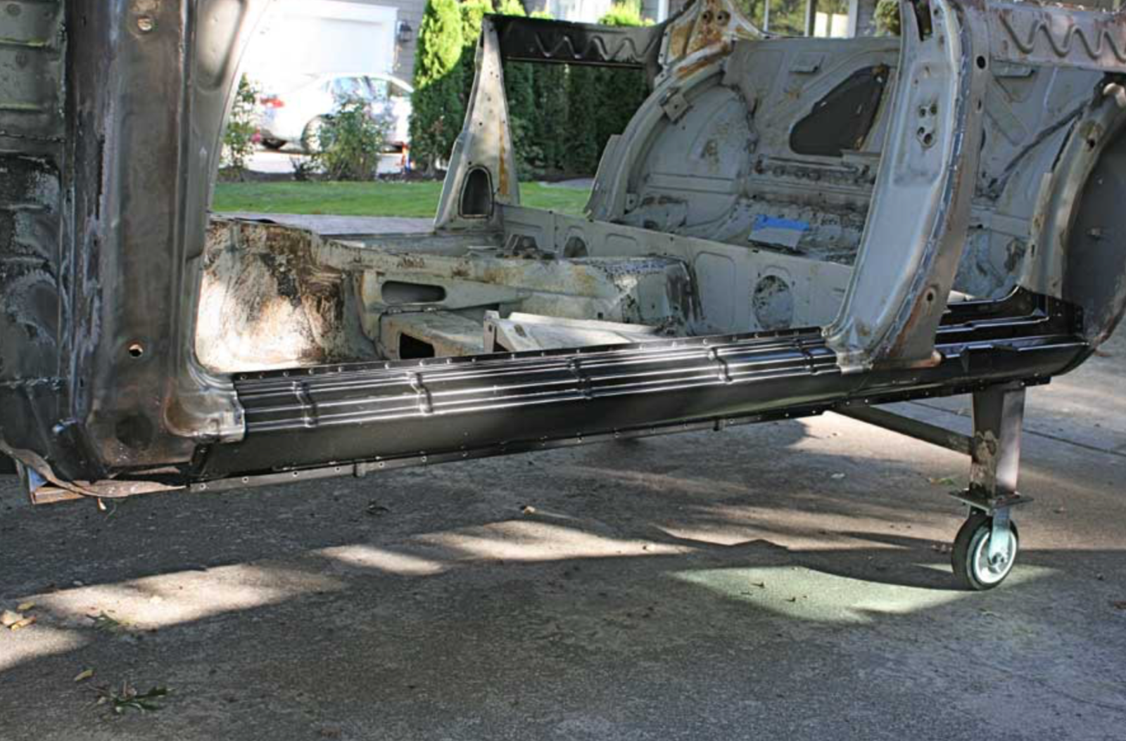

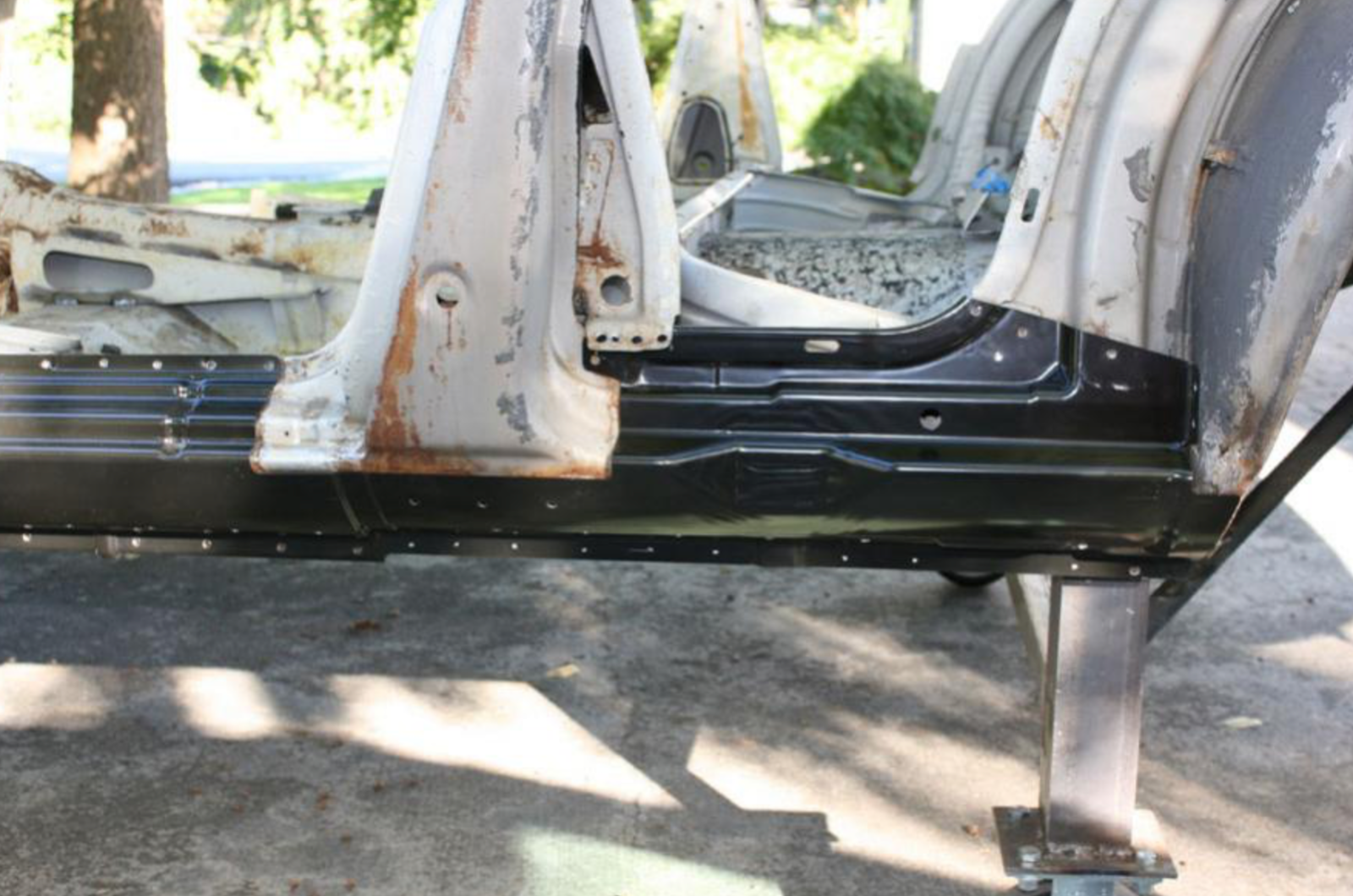

These structures are then covered by the "rocker cover" (the black component), which can be seen in place here:
The rocker cover is then itself covered at the front by the fenders, and from the B-pillar back by the rear quarter panels. The only part of this that is visible is at the doors (with the rocker trim removed).

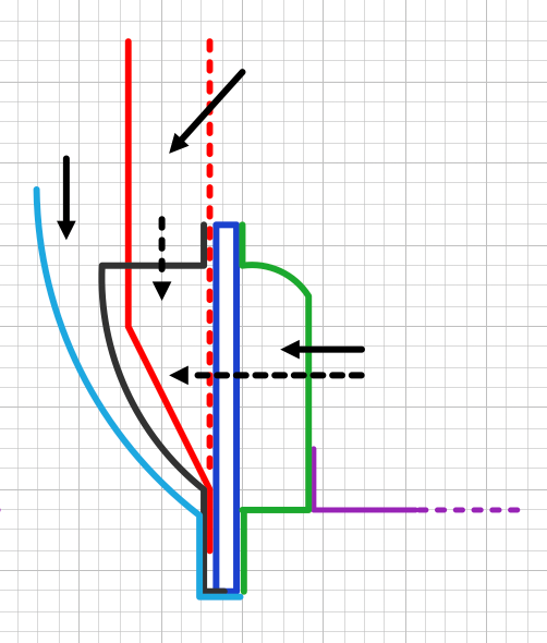

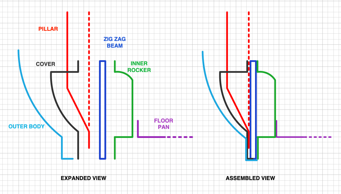

What this means is at three places (front, middle and rear) there are FIVE layers of metal - Inner rocker, zig zag beam, pillar, rocker cover and fender or quarter panel. The space between these layers ranges from about 1 cm to zero. Here is a rough cross-section view of the B-Pillar area.
So, you can see why this is such problematic area! There are all sorts of layered joints (usually a haven for rust), and cervices that will catch and hold water.

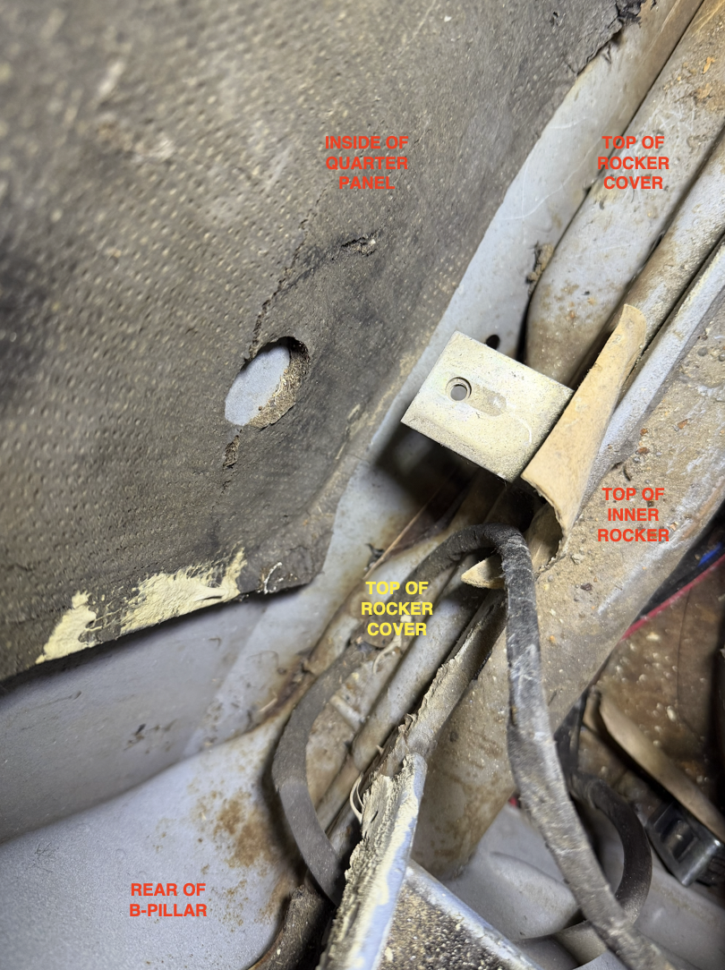

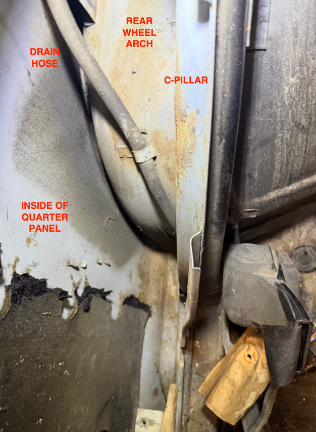

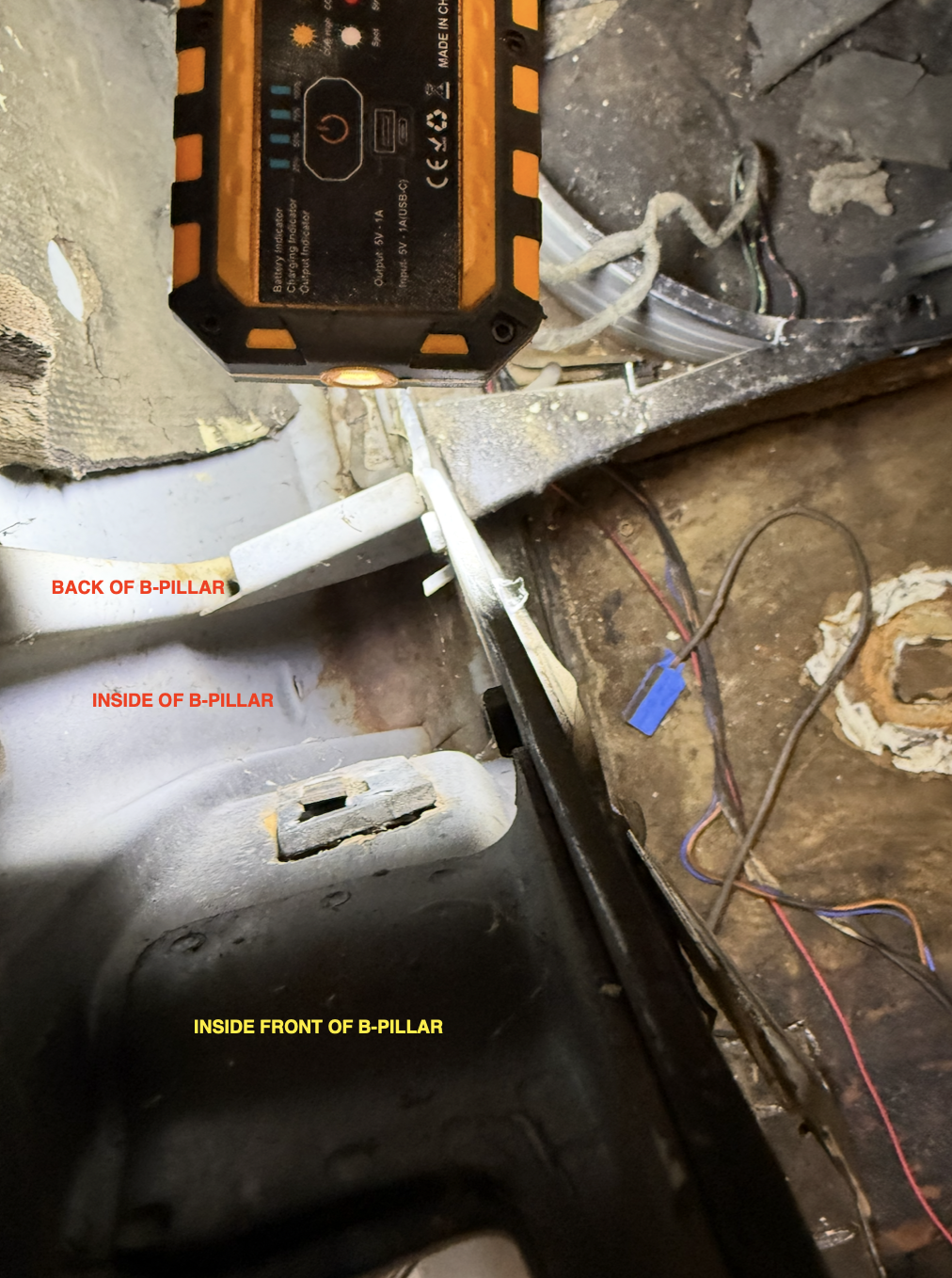

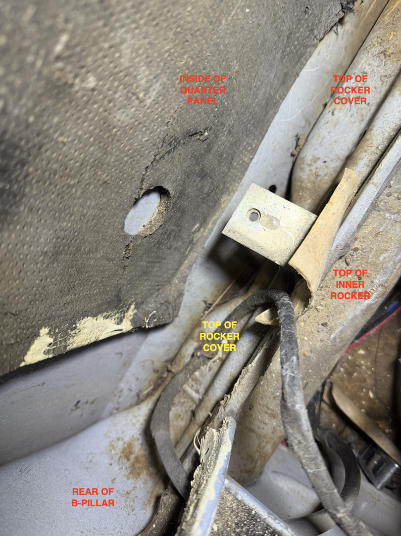

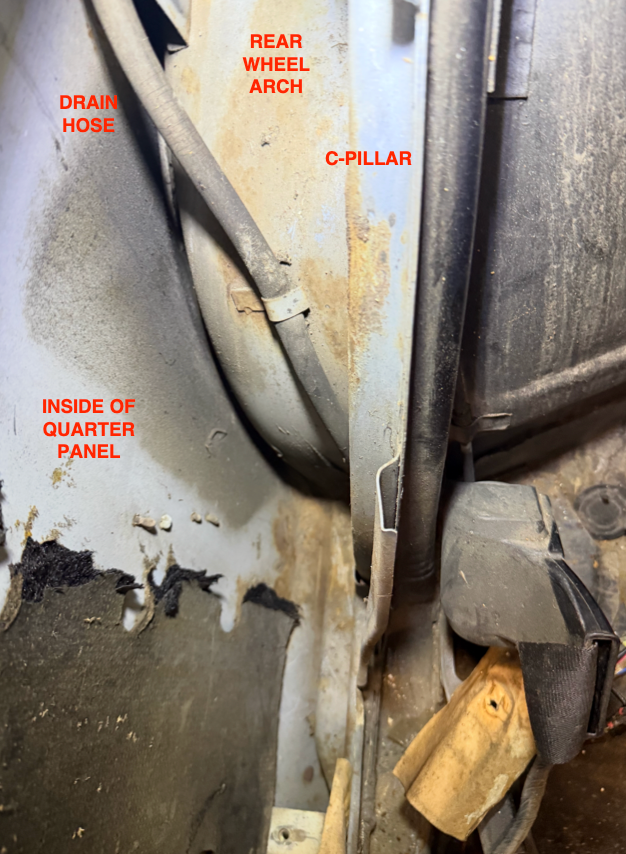

Here are some views down inside the right side rear window area of my coupe. You can see the quarter panel, and the tops of the lower part of the B-Pillar and the top of the rocker cover, and you can see how the pieces all converge at the bottom. Of note in these images is that, at least on my coupe, there is relatively limited rust on the TOP of the rocker cover, and only minor rust down in the cracks, or the bottom of the side panel. This implies that there is not much water intrusion from the window seals, other than in the last pic, where you can see that some water must leak down the spot at the front of the rear side window (where the side windows meet).

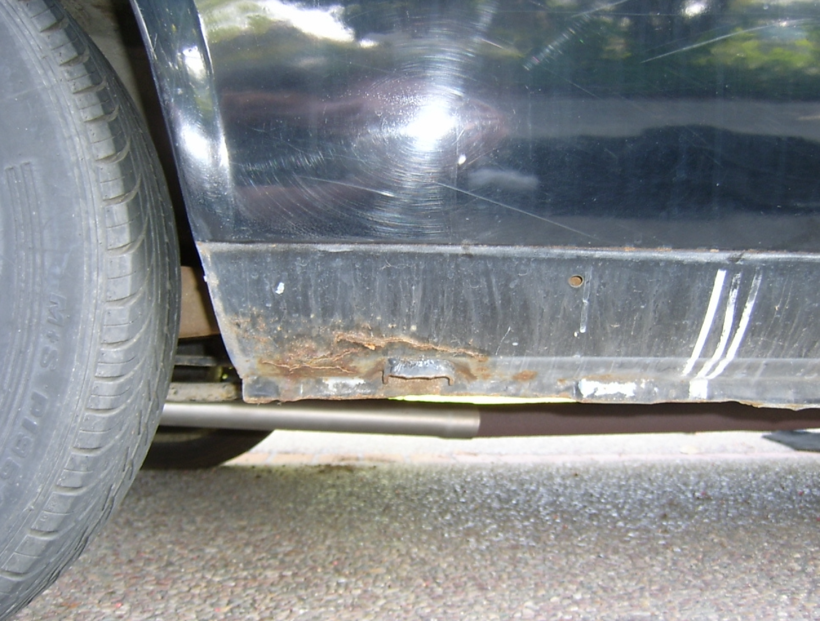

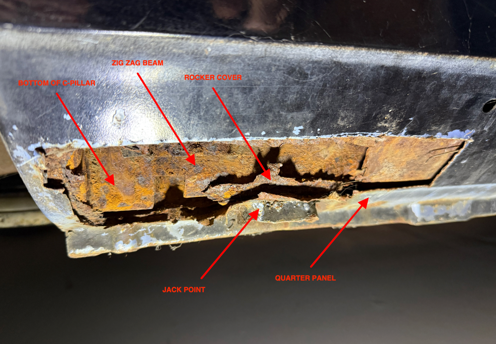

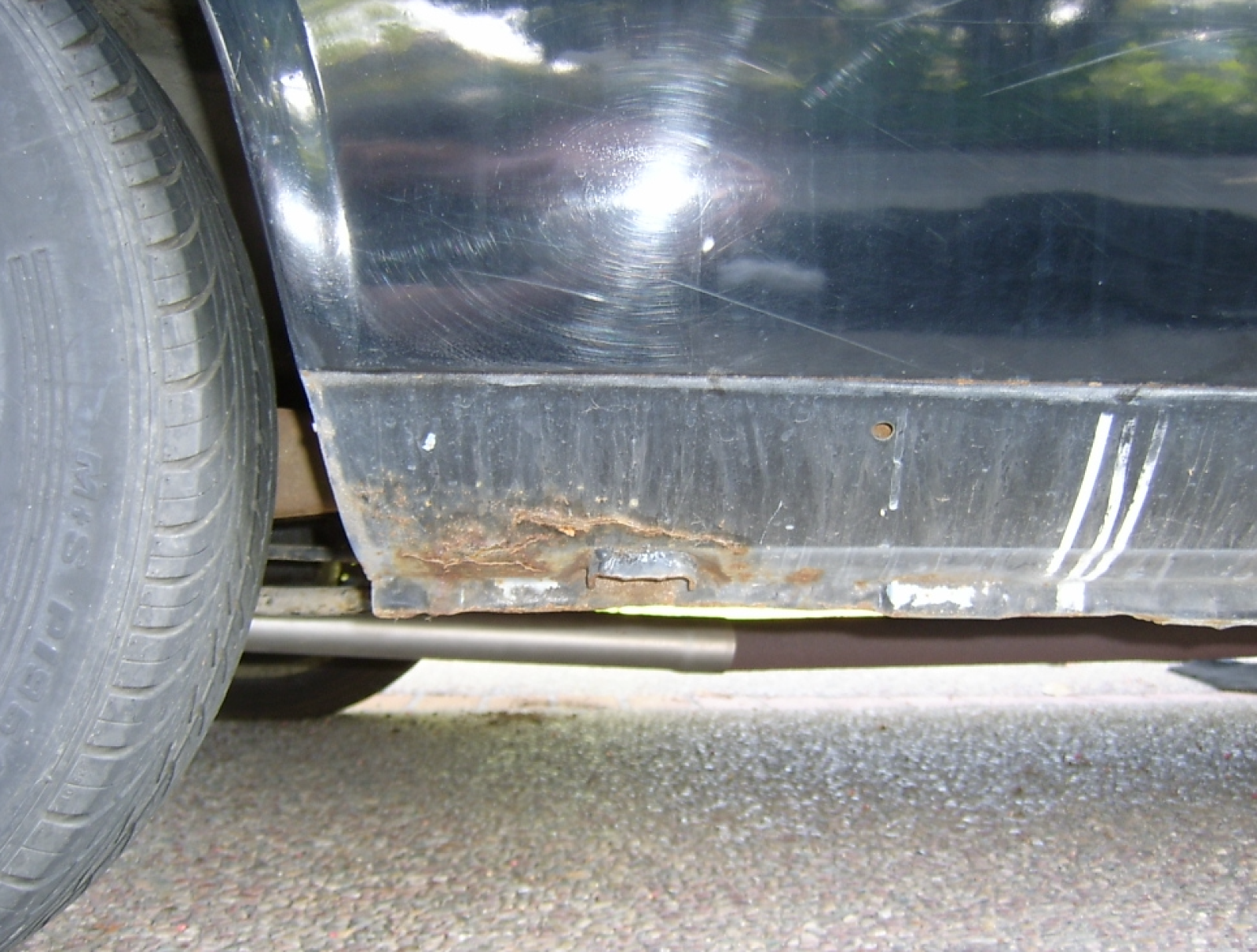

Now, compare this to the mess under the rocker where the drain goes... This is the outside, before I cut open the quarter panel.

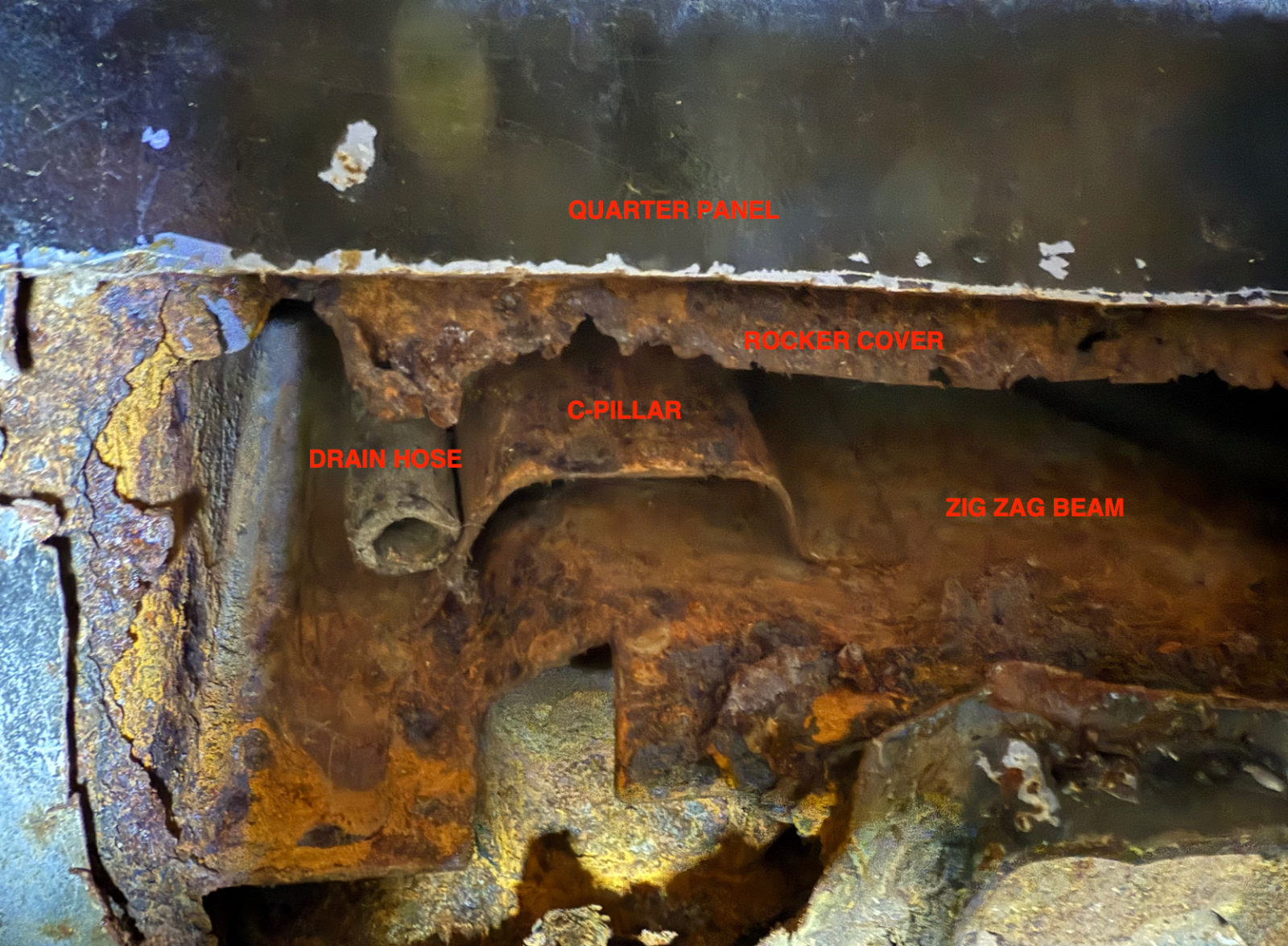

Inside, the lower portion of the rocker cover is basically gone, and the lower C-pillar and zig zag beam are rusty but solid.

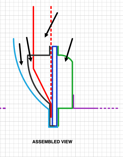

Thinking about this more, I think drilling a small hole fairly high up the "C-pillar (which is really just a curved square section that forms the top of the wheel arch) would allow getting rust preventer down right into the troubled area at the end of the rear rocker. The drill some holes on the top of the cover piece, and on top of the inner rockers, so you can spray behind and in front of the zigzag beam. Then do the creases between the fender and the cover and the quarter panel and the cover, and maybe into the A and B pillars.
Sort of like this:
