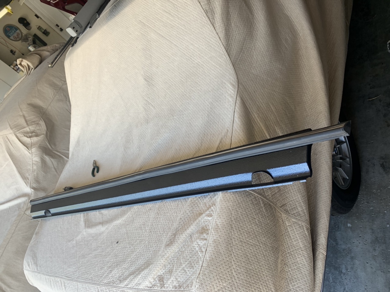

Can someone measure the length of your e3 rocker trim? I have two pieces that are longer than e9, thank you.

E3 ARE longer than E9, thats been the go-to part for the coupe rocker trim for a few years. Get the part from a Bavaria,and trim to fit. When you think of it, of course the E3 part is longer...four doors! (ps I could use a pair if you are not planning on using them!)

74 inches. I do know I measured it in the past and it was the same length as that on my E24....and those I believe are still available. I believe the part in your picture is NLA.

Mine is 76”, yes these have been NLA for a long time. I had them in the garage for ten years or so, they came from the guy with the 137th CSi, does that bring back memories? I always assumed they were e9, I was wrong and now I need a pair. Modifying them could be an option. Dale, do you have any tricks to do this?
