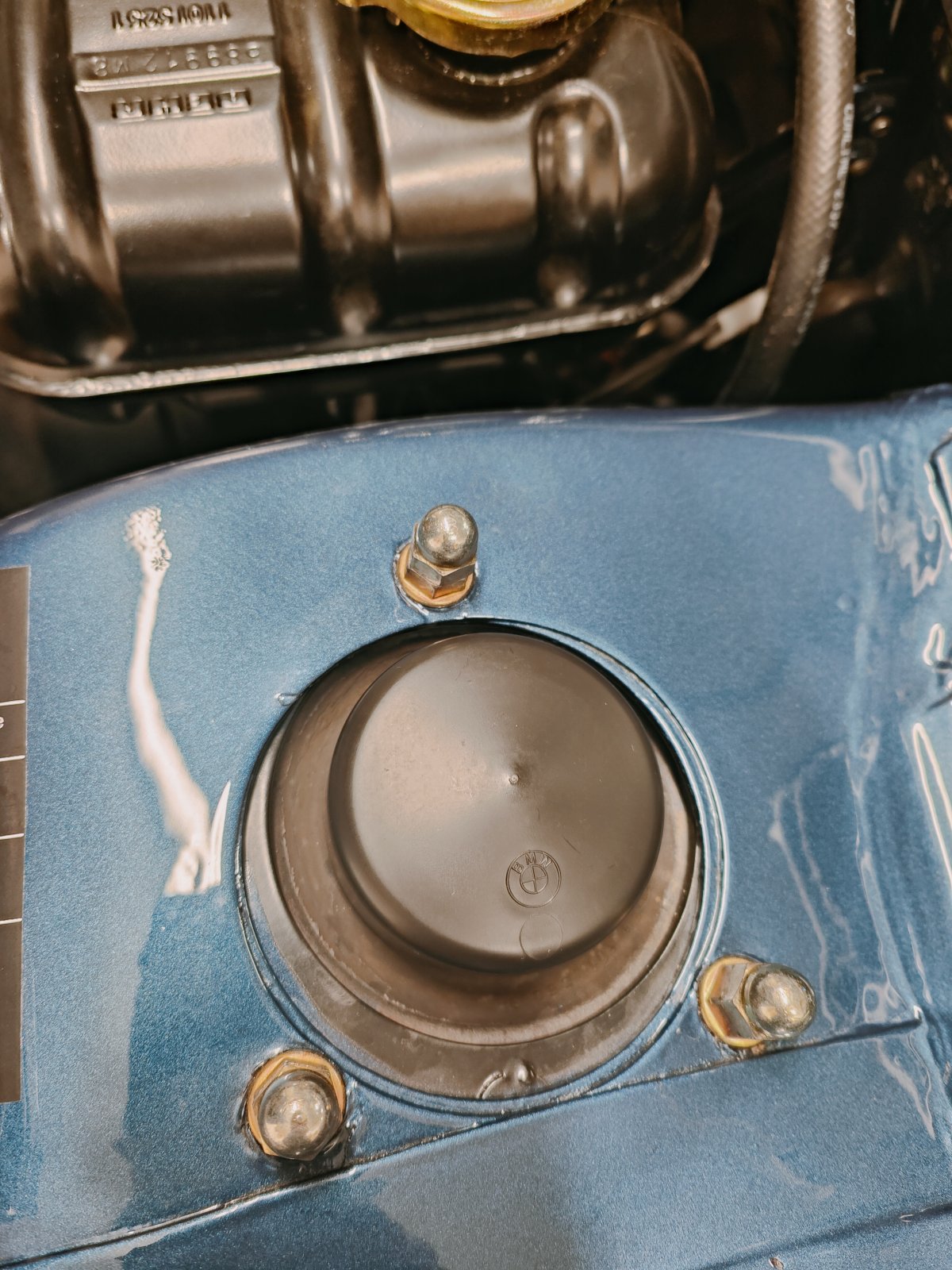

Heating the paint will definitely help mitigate paint cracking. Just need to roll between 10 & 2 o'clock on both front fenders. Fixed negative camber plates will help.I have adjustable negative camber plates to get -1° on both sides.

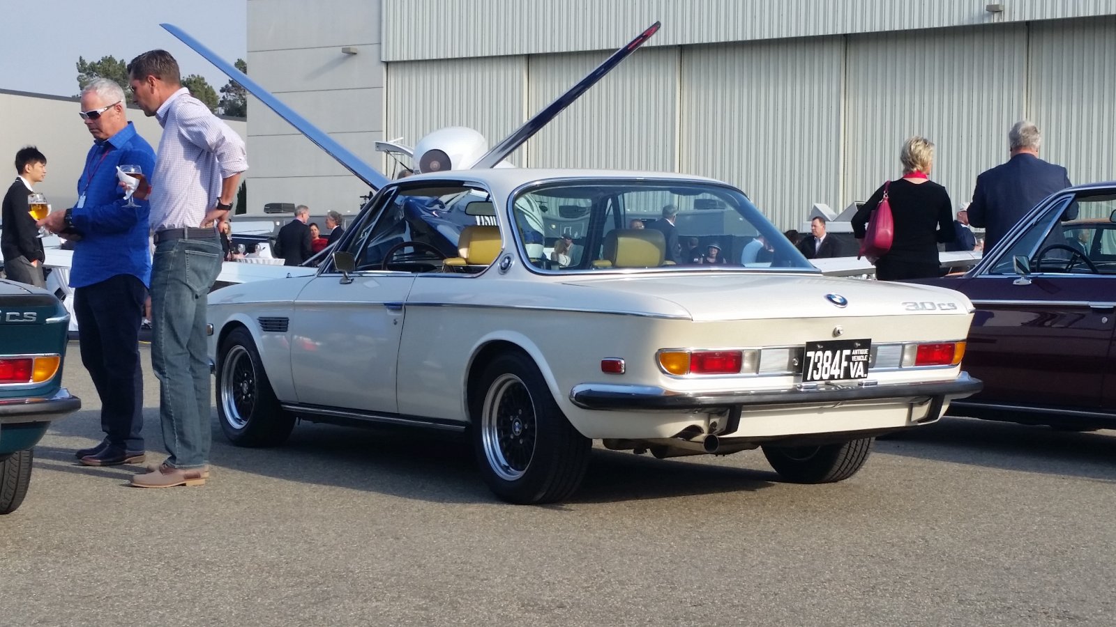

Of course I have pictures of my car! This picture was taken in Monterey at the Jetport and shows how a fatter tire fills out the wheel well:

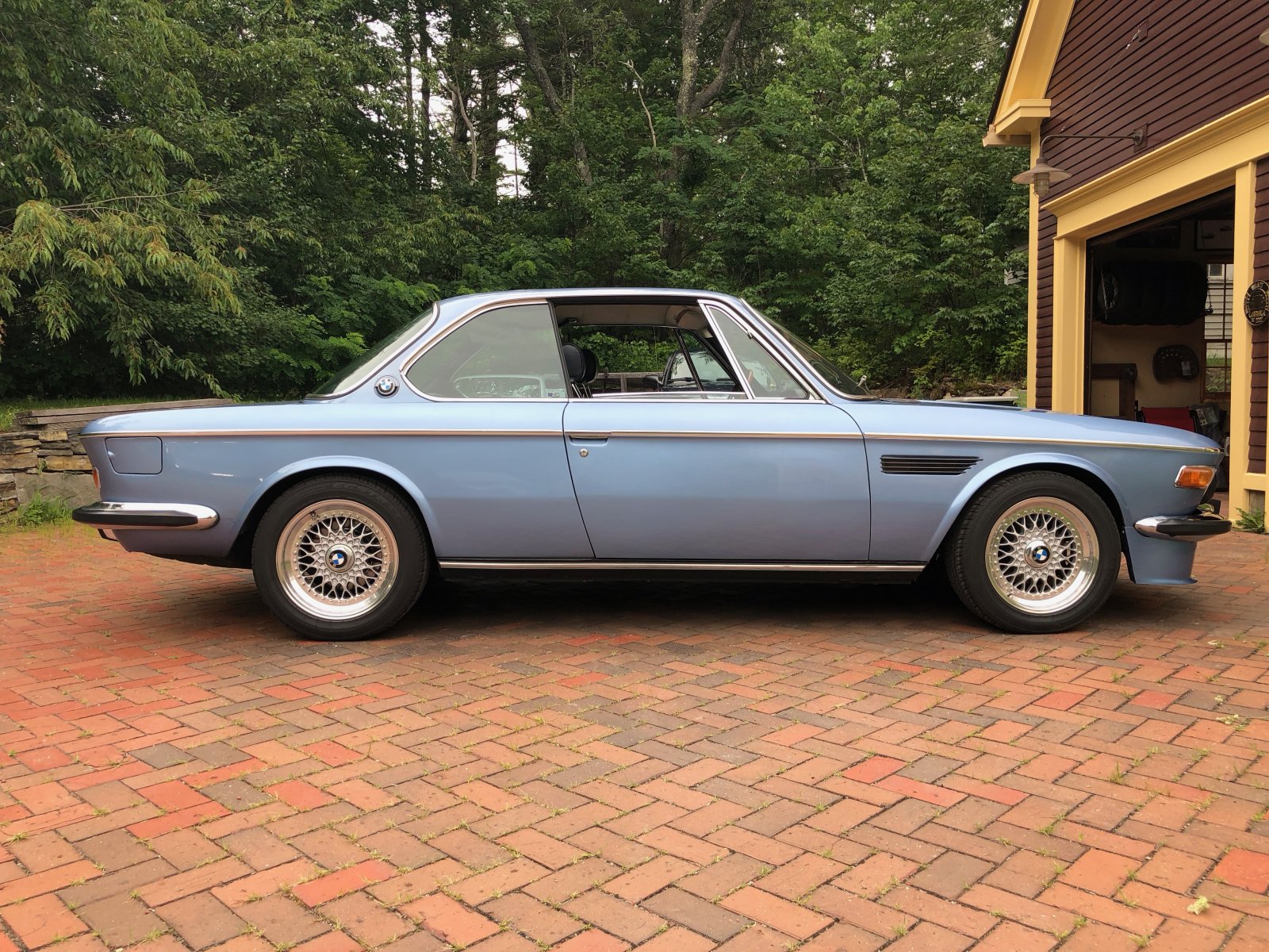

This picture was taken locally. You can see how much I rolled the fenders if you look behind the tires.

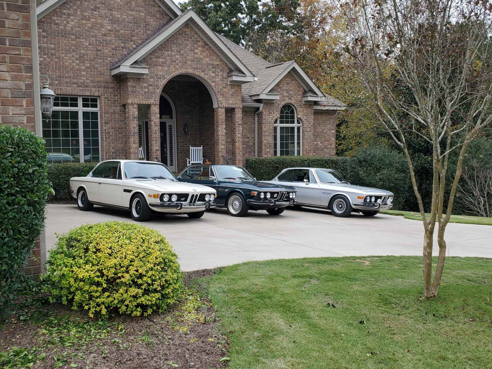

This picture shows three different rim sizes. My car with the 15" Wed Bavarias is in the foreground. Tom in the middle has a set of 16" BBS wheels on his car. Steve's car on the right has 14" Alpinas.
