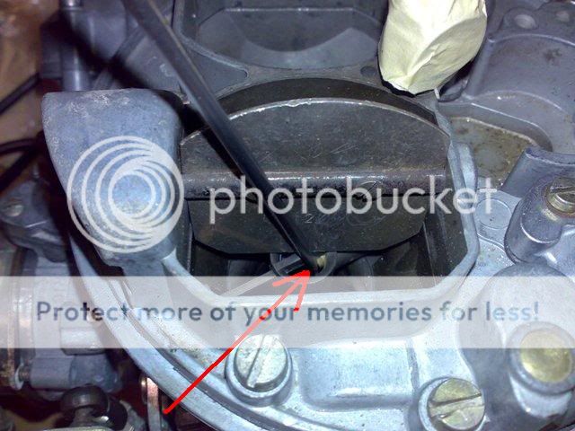

knowing that to run an engine there must be fuel somewhere, i was anxious to see where was the gasoline coming from, and i found this:
when the engine is iddling, you can clearly see a tiny drop of gasoline getting out from this red arrowed small hole (is this a brass pipe ?)
so there is for sure a contribution to the mixture that is comming from this point, and what it comes out from the iddle screw is an addition
is this right ?
please advise !

Fuel dripping from where you indicated means:
1. Fuel level too high, gasket under the float valve loose, float hanging up.
It is adjusted by the thickness of the washer under the valve. But can only be adjusted by the thickness limit of 2mm otherwise the float swing will be interrupted.
I have also found carbs that the fuel section gasket is wrong and hits/ scrapes the float.( There are several that come in the kit and using the wrong one is easy. If the gasket extends over into the fuel bowl , it's the wrong one. It can be modified though.)
2. Way too much air- meaning the throttle plates ( butterflys) need to be closed slightly.
3. The choke venturi- ( where you pointed to fuel drip) there are gaskets. The large brass nut on the side holds tension on this part which has a small rubber gasket that must seal it to the body. If leaking it is possible for vacumn to pull fuel up and out the seal vs. the hole.
Yes, number three or your pointer in your last photo has a brass insert.
No, no fuel at idle is to come from there.
Fuel mixture at idle comes from a small hole below the butterfly. The amount of fuel comes from the idle screw when warm. But the carb should be able to run the car at a low rpm- 550-600 with the mixture screws closed which means not all the fuel comes from the mixture screws.
Fix the dripping fuel. You will be amazed at how smooth you can make it run. I find the idle screw settings with modern gas ( 10% ethenaol, premium) to be more open than the factory. I also find that the setting is different for each carb rather than the manual procedure. (I tune each carb for a bank of cylinders corresponding to the intake manifold.)
The butterfly adjustment- what I do is start from closed then slowly turn till the linkage moves slightly. But you have to use some method to determine how equal that is.... hose, manometer, air flow meter...etc.
With the fuel dripping, even a bit, it will make the idle rough.
I had this problem - like Jerry says it is either the float level leaking or more likely too much air through the butteflys which sucks the fuel out of the tube and makes the idle mixture adjustments not work as much if at all. Back off the butterfly screws until idle almost dies and see if A) you don't drip fuel anymore and B) your idle mixture screws work again and by opening them up your idle goes back up. Let us know.

thank you both jerry and steve,
today i have been fixing the carbs only adjusting the screws (not opening them)
i reached a fine smooth iddle at 900 rpm´s, but the way to get it has been closing the butterflies, and also closing the iddle screw of the front carb,
i proceed like this:
1- with the engine warmed up, stop the engine, i removed the air filter assembly
2-and then i closed the two iddle screws of both carbs completely, and then oppened the screws 1+1/2 turn each one, then started the engine again
3-the iddle was terrible, the engine was running very instable. i tried to smooth it a bit by tighthening the screw that opens the butterflies in each carb, the revs went up, so i started closing the iddle screws a bit until i got 1100rpm´s, but it was unstable
4-then i closed the iddle screw in the front carb, and progresively the iddle became smoother, then i touched a little bit the air butterfly of that front carb, until it was fine
5-i closed the air filter assembly, and run a car for a mile, went back and check: result by now:
- perfect and smooth iddle at 900 rpm´s
- no leaks in the choke venturi
6- but a new problem arised: the engine becomes very rough at 1800 until 2200 rpm´s , from 2200 and up (rpm´s) no problem, it is smooth again
?????, any idea ????
i went for a longer ride and the iddle maintained always smooth at 900 rpm´s when i stopped, but in the transition through 1800-2200 rpm´s the engine is unstable and stumbles
remark: remember that i reached the iddle by closing the iddle screw more in the front carb than the one in the rear, when i checked the fine tuning tip (jerry´s tip, inserting a thin cable) it happens this:
1-the front carb revs up the engine
2-the rear carb dies the engine
i have checked the hiss sound in both carbs with a home made sthetoscope and it seems similar sound
Condition one response:
The front carb is too lean. Caused by the butterfly being a bit too open close it a bit or the idle screw needs turned out a bit more.
Condition two response:
The back carb is too rich. Open the butterfly up a touch. Or screw the idle screw in a bit more.
When using the tip of partially inserting a wire, etc. in the idle air hole, the carbs should give the same reaction to speed or stumble.
The hose method- is an aquired skill. Because the other secondary butterfly is slightly open there is air coming in from there.
If all is close, there is a direct relationship where the idle screws, opening position of the butterflies all are small adjustments. This mixture at idle effects the transition at 1800-2000. From there on the main jet takes over which is why it smooths out again.
You're getting closer.. keep at it in small increments and be patient.
