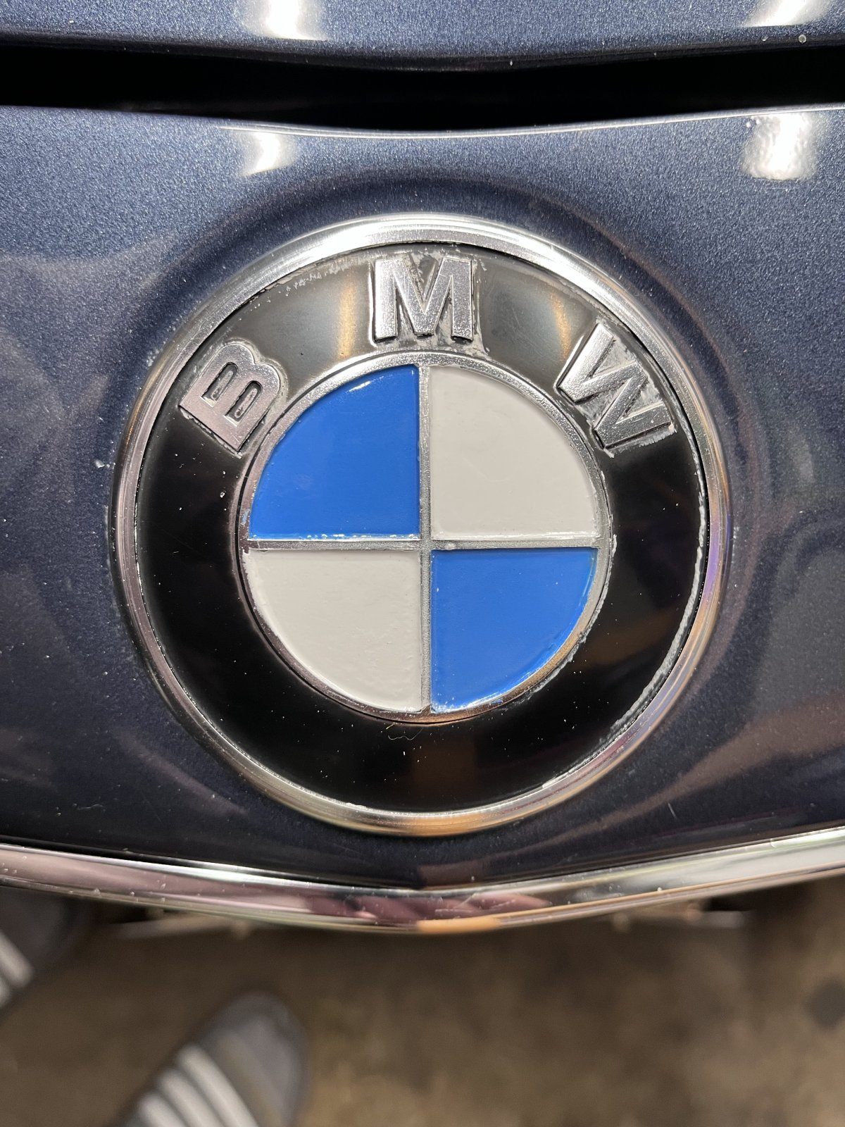

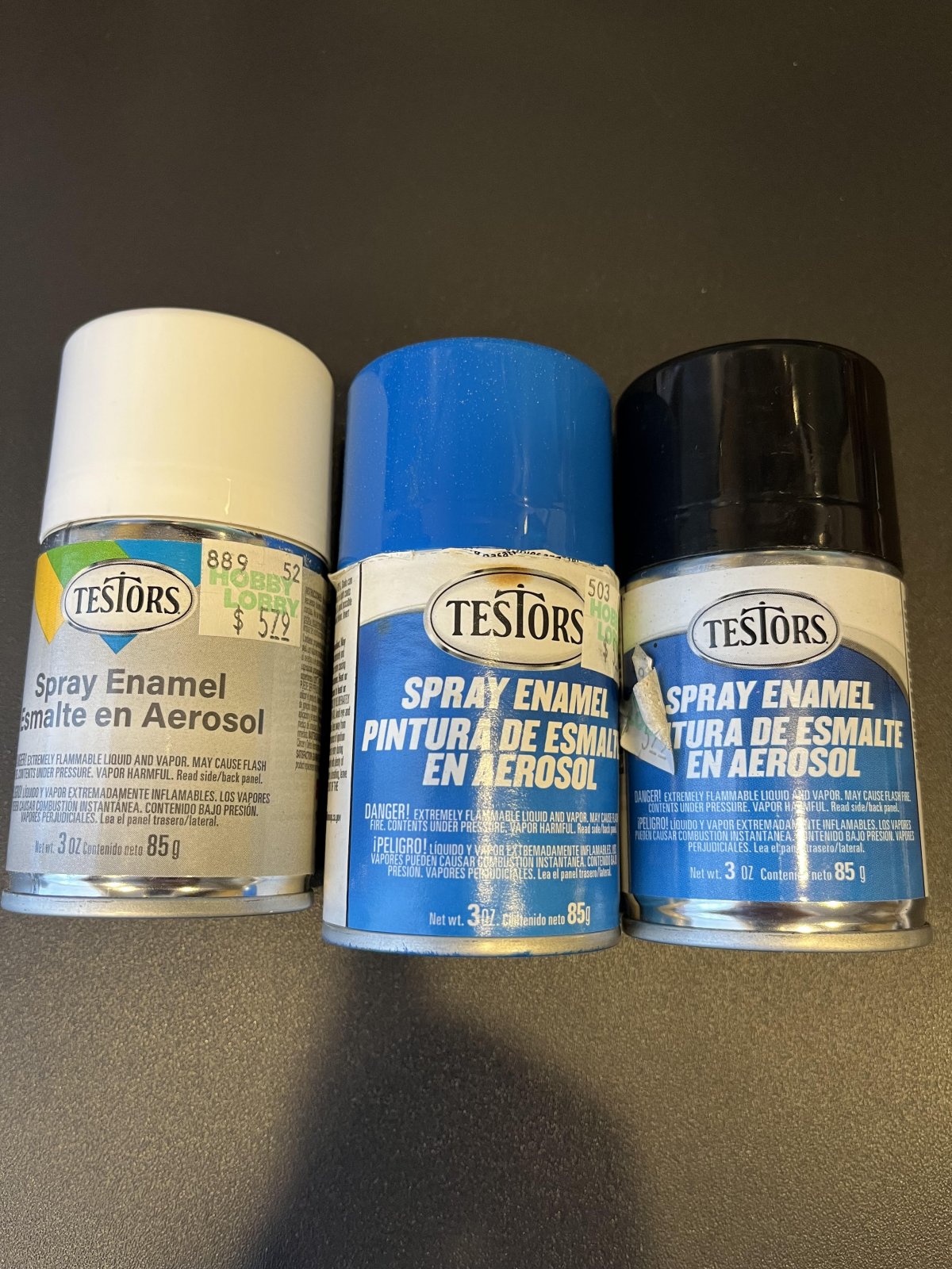

I did the resoration myself and it is allot of work. I could never get it perfect and I just gave up. No one ever notices, except me they are not perfect. I used verios methods from the forum but ended up taking a freinds suggestion and used spray pait from Hobby Loby, that worked the best. It is Much easier than using Testors with a brush that other have suggested

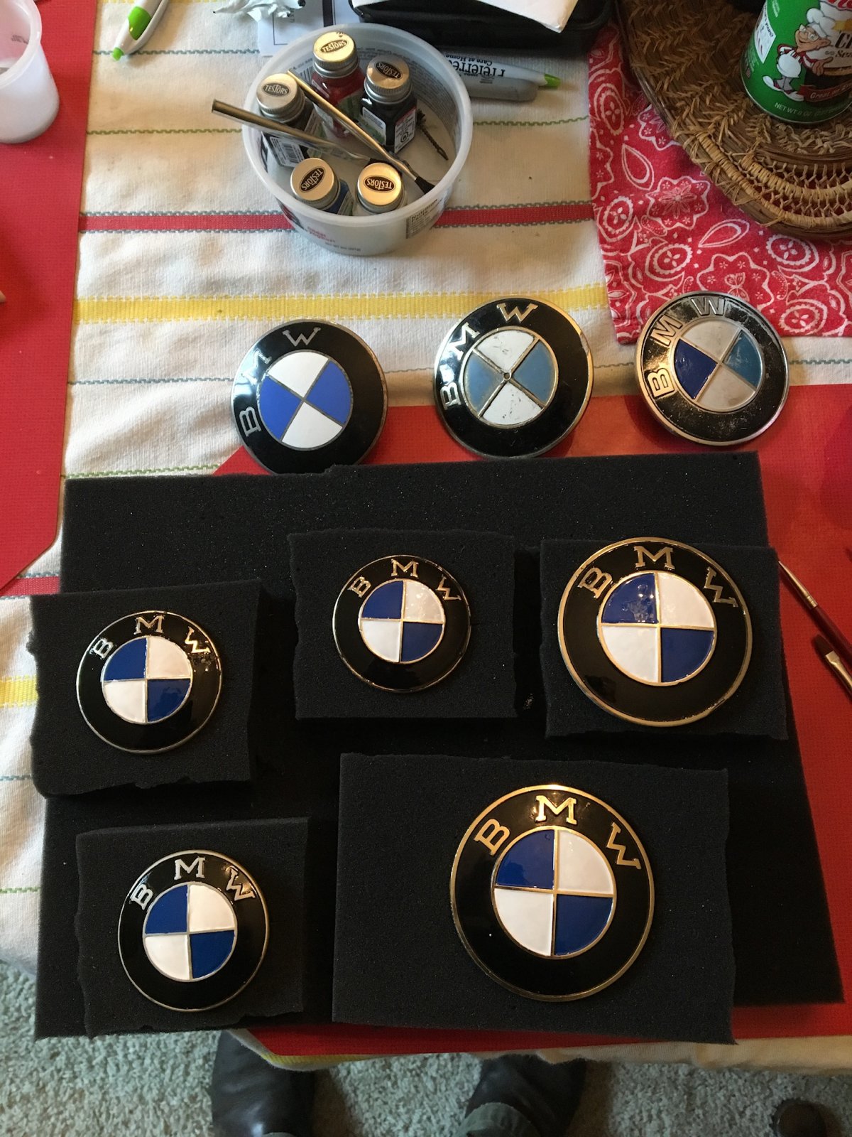

It's so easy... got to Hobby Lobby for Testors model paint, some brushes, and maybe some thinner. I've repainted maybe a dozen over the years, some just for practice.
Here's an FAQ link that talks about it: https://www.bmw2002faq.com/forums/topic/147974-repainting-raised-roundel-badge/
Clean your existing Roundel so the paint adheres. Drop the new paint from the tip of your brush into the recessed areas of the Roundel. The paint will self-level (because the Roundel is not flat, you might need to hold it in your hand to insure the paint goes where you want it). It congeals quickly enough. After the paint has dried, you can spray them with a clear coat.
All the Roundels on my 2000CS were done this way (I chose to use the early Serif script Roundels and those are not available new).
