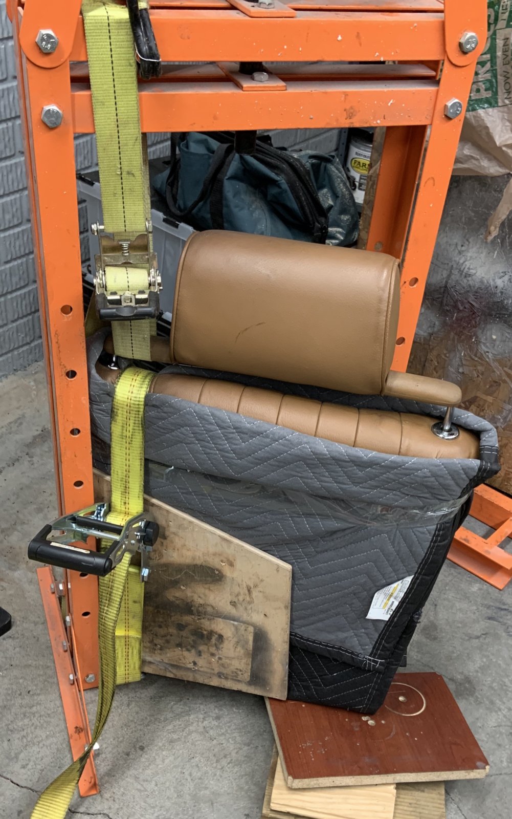

Markos' idea about an 'air hammer' combined with my rube goldburg contraption (pictured) with a couple days of PB Blaster worked for me.
Dan, i would think that you might have needed to do a pair of straps on both sides ... tighten up one, then tighten up the other side ... going back and forth.
Scott,
The other side was completely free so it wasn't needed in this situation.
I probably had 200 pounds plus force pulling on the headrest without any movement.
BMW certainly didn't want any chance of the headrest rattling.
Dan
